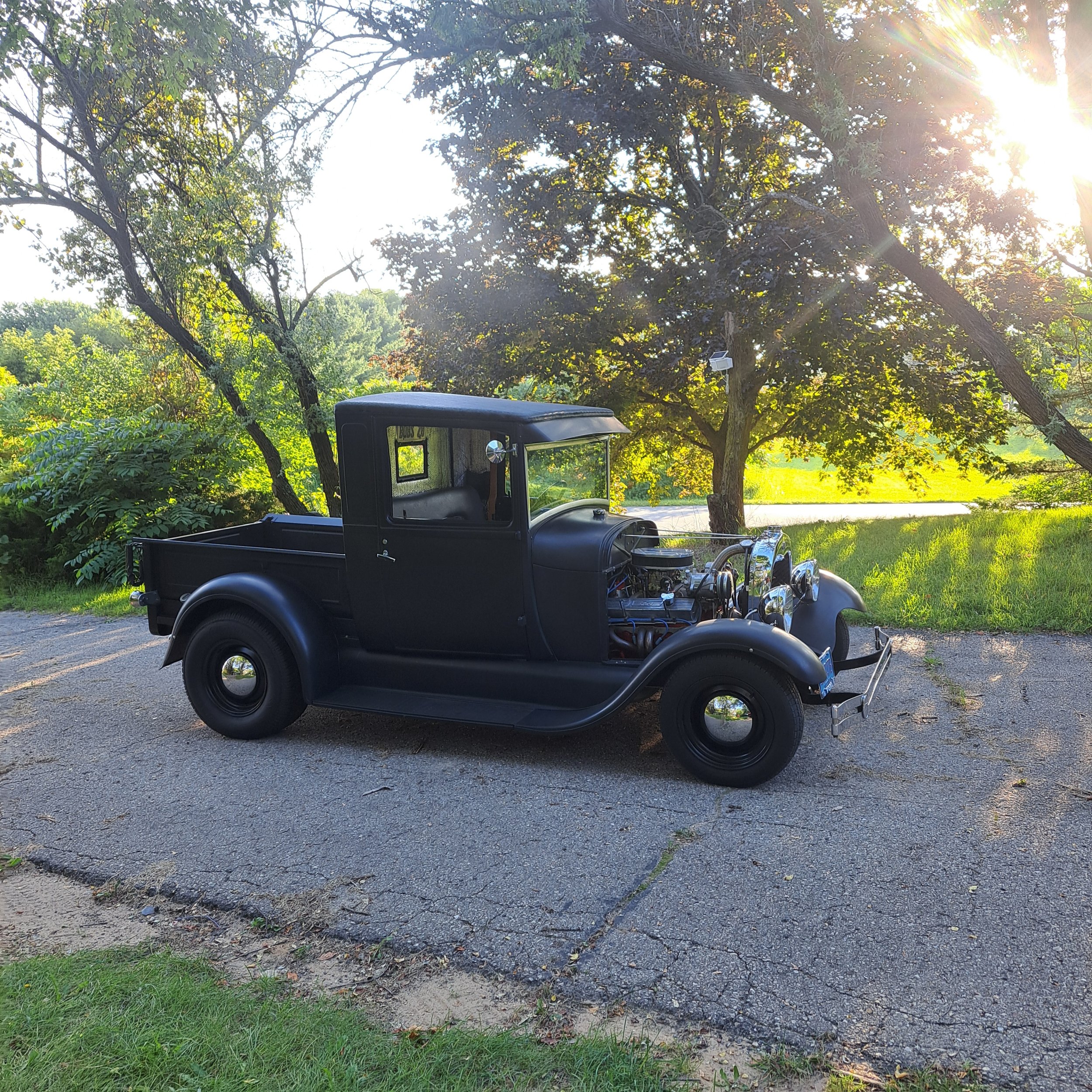

    What do you have for a seat? Too thick of a seat in these things and you really notice it.
  4. stock model a seat, it's pretty thin on the bottom but back is around 4 inches thick

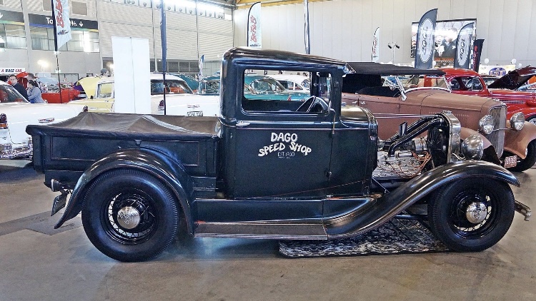

    Jim Jacobs' is a good example --

    Jakes truck is spot on! HRP

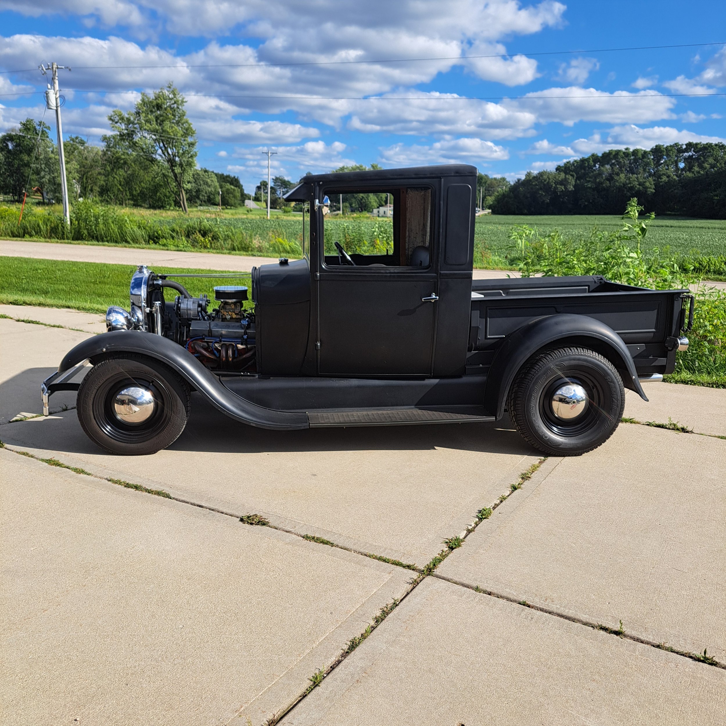

  13. Got any pics of yours, really considering leaving it uncut

    I'm 5.5 so I could raise the seat up slightly 2" to help with leg room .
    I don't have a lot of head room after. I tilted the seat bottom back slightly also to raise my knees up slightly .
    The seat back needs to be as thin as possable . If i was taller I'd likely hate the truck .
    The slight rake makes it hard to look way down the road or see a stop light.
    Im planning on dropping the rear more now that the wheels fit inside the fenders. Hopefully it will help with the view down the road .
    I really noticed it when the 2" taller tires raised the back up.
    I would not want mine chopped. More than a inch would look out of proportion IMO.
    Get them low enough and the cab dosent look so tall IMO.
    Fenderless then a slight chop would be ok but man it's a really tight fit .
    If i was doing it fenderless and cutting it up I'd stretch the cab to .
    Not to much but 3" would really help .
    Now my 31 cab thats going no fenders and channeled ( most likely ) I'm considering a 2" chop.
