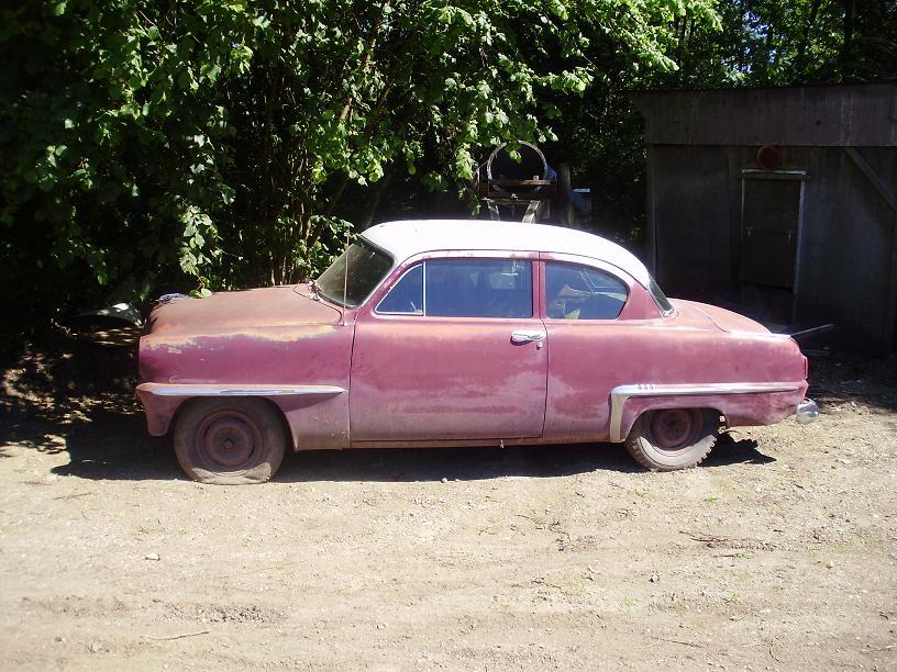

    Hello,
    I recently started working on restoring a '53 cranbrook and I need some advice, I've been looking around checking out things to do and I think my best bet would be to chop it or have it chopped. I've been photochopping it a bit and included a picture (sorry I'm a little rusty on PS) but I was wondering if my idea is even doable!? if not I'll head back to the drawing book.
    any other ideas of what I could possibly do would b e great?!
    the proportions are all fucky and I'm not set on the wheels but that's the look I'd be going for.
    ANY help or suggestions would be greatly appreciated.
    Thanks,
    Kerry

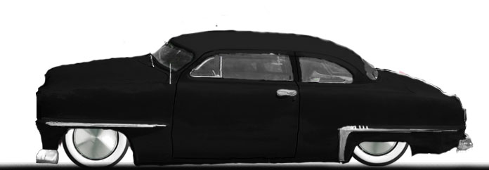

  5. 69f100

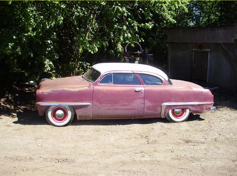

  6. hmm i think its not enough chop. what do ya think of this?
  7. seriously though, i think although your PS skills need some work, i think the real life chop if ya did it like that would look good.... btw, I did that with paintbrush lol....

    Yeah I wasn't sure if it was too much or not or even possible for that matter. Should I replace the rear window or lean the original? If I replaced it are there any smaller sized windshields I should look for? it's got a weird hump look to it that I'm really not keen on.

    honestly i would rid of the whole rear section of the roof, and then lean the window. but chop it first (the glass)

    Would the picture I made (black shitty one) be to much? I'd love to have that look but if it can't be done it can't be done.

    The rear glass could be a pain in the butt...how about leaving it alone and then do about a 2" cut forward? There is alot of room above the rear glass.
