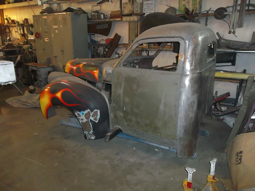

  2. Thanks for the ideas guys, but I think I'm finding my direction. I started the section today. :D

    I like that look a lot better than the blank painted space above the grill that makes it look like it has a bulb nose.
  4. That area will be the olds hood, most likely peaked with the grille inset in the front. (I can't do that in photoshop). Stay tuned I think it's going to work.

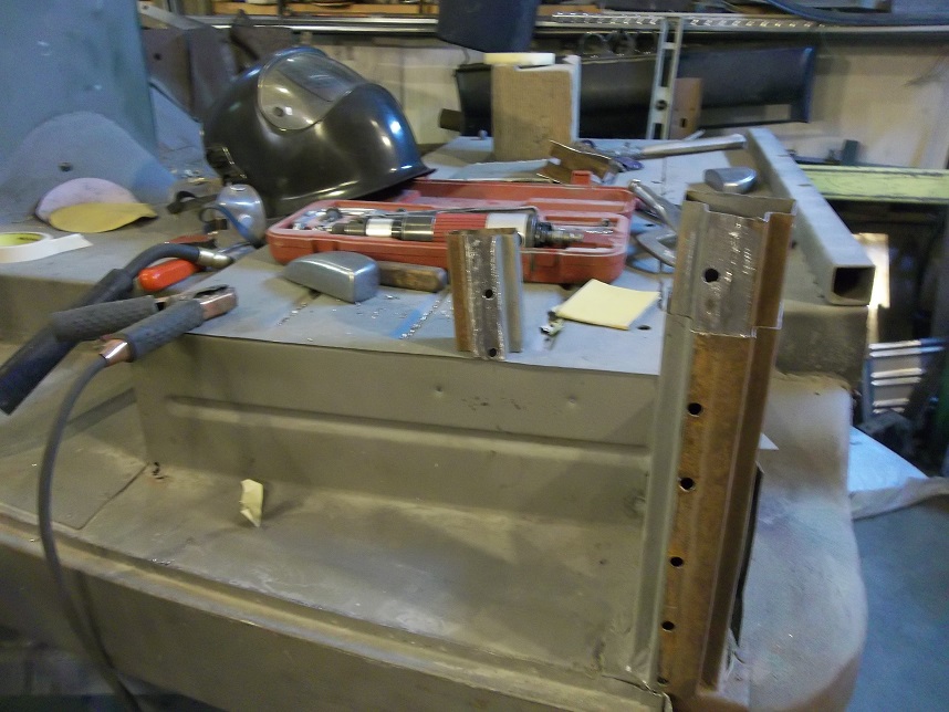

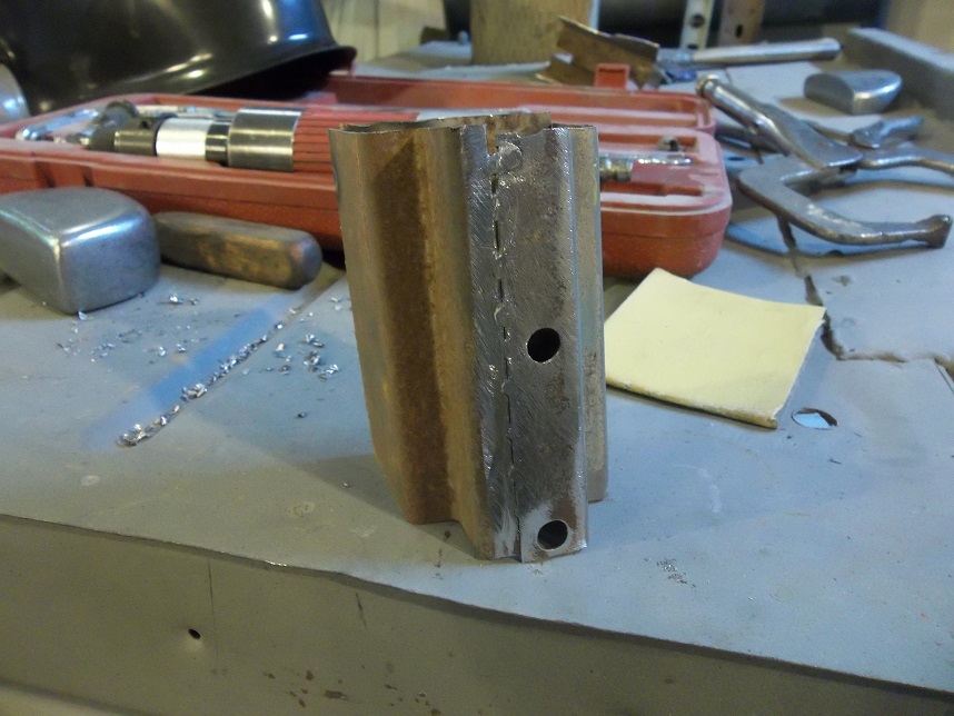

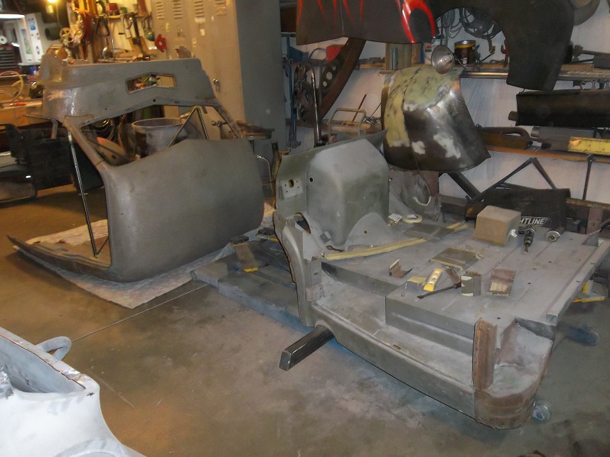

  7. I've been working on the paying project, so I haven't had much time on my Stude. I wanted to sand blast , but the one nice day we had I spent blasting the inside of the T bird quarters. (epoxy primed them today! ) I did manage to find a little time to cut down the pillar sections that were removed and made the sleeves for the B pillars. Nice "tap in" fit. These will be cleaned up and plug welded into the post & the top will slide over the stub. The sleeve will act as a reinforcement and a backer for the weld around the B pillar. Sure feels good to work on My truck ! Even a little!

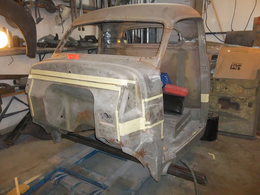

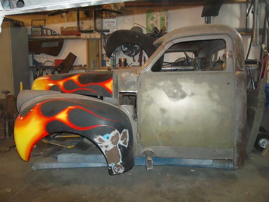

  8. Spent a little "me" time in the shop today. Did some t******* and cut out the firewall. Set it back together for a test fit. Yes I did lift the top half and set it on myself!:eek: Went ahead and cut the door and hung it.
    So what do you guys think?

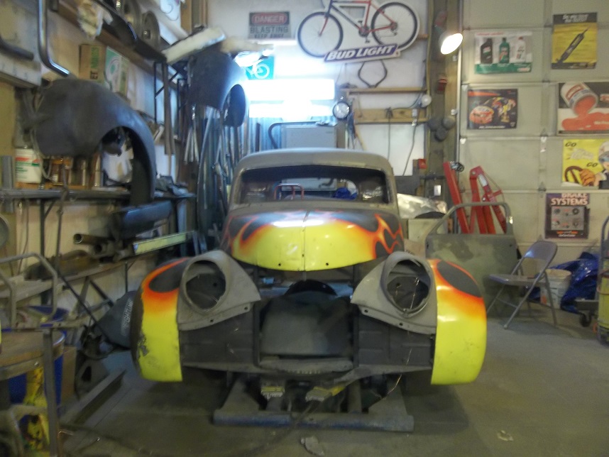

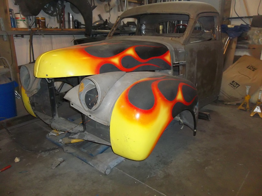

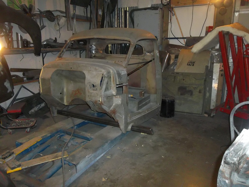

  25. I've been able to spend a little time on the front end. Mostly cutting away the aprons and bottom of the hood, so I can get a better Idea where everything needs to be. I dropped the hood more in front I think I like it.
  26. I'm building new edge flanges for the hood and apron. This way I can end up with nice lines and gaps between the hood and aprons. What do you guys think about the three bar grill rather than the whole thing?

    3 or 4 bars, both look great. LOVE the Olds grill idea, but ya kinda knew that already huh?:D Do you plan on taking out the little spacers in the center of the bars?
  28. I kinda thought you'd like the grille! I'm not sure about the spacers. I'm just getting ready to go out in the shop(gotta love spring break!) I'm going to put in a few hours on the Tbird, then play around with the grille in the Stude.
