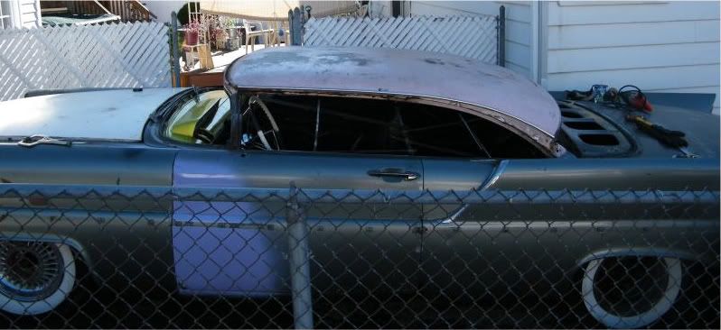

chopped my 57 today

    I love those Lincolns, they just look evil.
  4. 4.5 inch chop looks good on that car, I like!

  11. Sauli
    Joined: Jul 16, 2008
    Posts: 499
    Sauli
    That style Lincolns look absolutely awesome chopped, provided You are able to work the original back window and stainless back into it.
  12. scrape53
    Joined: Sep 3, 2007
    Posts: 139
    scrape53
    from iowa
    thats gonna look pretty wicked..what do you have planned for body mods
  13. twochops
    Joined: Feb 28, 2006
    Posts: 1,510
    twochops
    Now is when the fun begins,the windows(front wraparound and the
    rear window)--------Been there .

  17. pimpin paint
    Joined: May 31, 2005
    Posts: 4,937
    pimpin paint
    from so cal
    Hey,
    This is where I ask I hope you've got one hell of a good gl*** guy!
    The biggest problem with chopping mid-fifties iron is the dog legged, vertical windshields. You can move those A Posts anywhere you want, it's getting the gl*** to conform to that shape that's like turning water to wine! I once chopped a '56 Ford pick up (same shaped windshield as your Lincoln, vertical sides & compound curves) the guy broke three windshield cutting them before he got it correct. I wouldn't throw out any of the pieces you cut from the pillars jus yet. You may have to add metal to make the gl*** work.
    Good luck

  18. metalman
    Joined: Dec 30, 2006
    Posts: 3,299
    metalman
    Yeah, hope you got a good gl*** guy! Do your self a favor for sure and get the gl*** cut and fitted NOW before you go any farther. Lot easier to bend metal to fit gl*** then the other way around!
    One of our gl*** guys has a 57 Chevy PU in his shop right now. These guys chopped it, finished the bodywork and painted it in a pearl/ candy without even considering IF the windshield would fit. Of course it won't without moving the pinchwelds around, now the paint/ bodywork is all wasted. Guess they thought the gl*** guy would be able to work majic!
  19. Mr48chev
    Joined: Dec 28, 2007
    Posts: 36,517
    Mr48chev
    Looks good so far, what have you got figured out to do with the windshield?
    I took the liberty of t******* the photos so we could see the car.
    I wouldn't even want to be along on the trip to the gl*** shop though.
    The car does look mean
  20. UnIOnViLLEHauNT
    Joined: Jun 22, 2004
    Posts: 4,838
    UnIOnViLLEHauNT
    How do you attach the roof back to the body? I didn't see anything welded up, and I could never figure out how they moved the posts around on one of these because of gl*** constraints.

  24. Glass_Packs
    Joined: Mar 17, 2006
    Posts: 378
    Glass_Packs
    Like everyone said, good luck with the gl***! A friend of mine has a '56 Lincoln that he originally chopped and had the gl*** cut to fit. At first he had three windhields but after the first two broke he decided to sink the stock front and rear gl***. And trying to find a new replacement windshield that shows up in one piece, well that's another story...
    Good Luck!
    Tom - Gl***_Packs

  26. dawg
    Joined: Mar 18, 2008
    Posts: 346
    dawg
    dude, no offense, but what the **** are you gonna do about the gl***?...

  29. shfifty five
    Joined: Aug 23, 2009
    Posts: 46
    shfifty five
    from New Jersey
    Wait, you mean to tell me you did the chop...............Oh.
    I also agree with thesupersized.
  30. 8FLEET9
    Joined: Feb 9, 2009
    Posts: 733
    8FLEET9
    from MASS.
    good luck on the gl***. prolly should've sunk the factory gl*** front & rear though.
