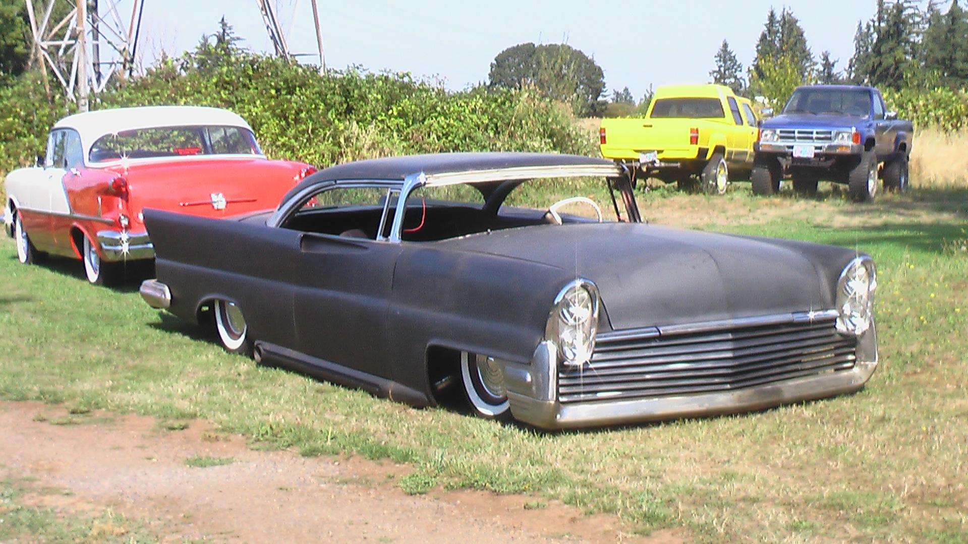

chopped my 57 today
Discussion in 'The Hokey Ass Message Board' started by sonim38, Oct 9, 2010.

    The old guys always told me cut the gl*** 1st, then make the chop conform to the gl***. A good way to have gone with the Lincoln would have been to drop the stock windshield into a pocket made into the firewall/cowl, then no gl*** cutting is needed. Then cut the top to match.

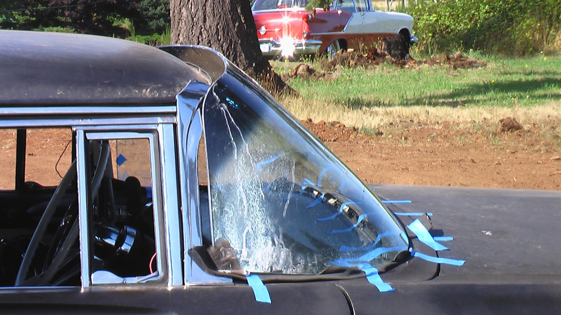

    , i've heard of cutting the roof to the windshield also...but his original windshield is cracked so he doesn't have a good one at the moment. maybe we can cut the cracked windshield to fit and put it in until he finds a good windshield and used his cut cracked one as a template..

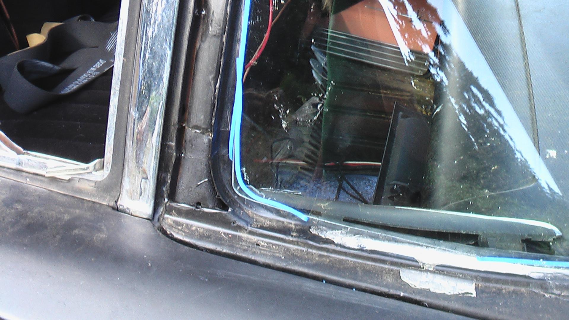

    Looks cool with the chop, but I'm personally terrified of chopping a car with curved gl*** that much. Mark and I have had lengthy discussions about it since he did his Olds. He seems to think that 2" is the max without sinking the gl***. Makes sense because you can cut off the corners and lean the gl*** back, so you get you get the drop but also keep the correct width on the top and bottom. The Kopper Kart is a good example of hat happens when the curved gl*** is chopped past that point, as the corners can't be cut any more and a gap begins to form in the channel, which was masked by custom metal shields. Maybe he can chime in and set the record straight.
    Looks cool though, I did those cars big time. I have faith you guys will figure it out and make it look sick

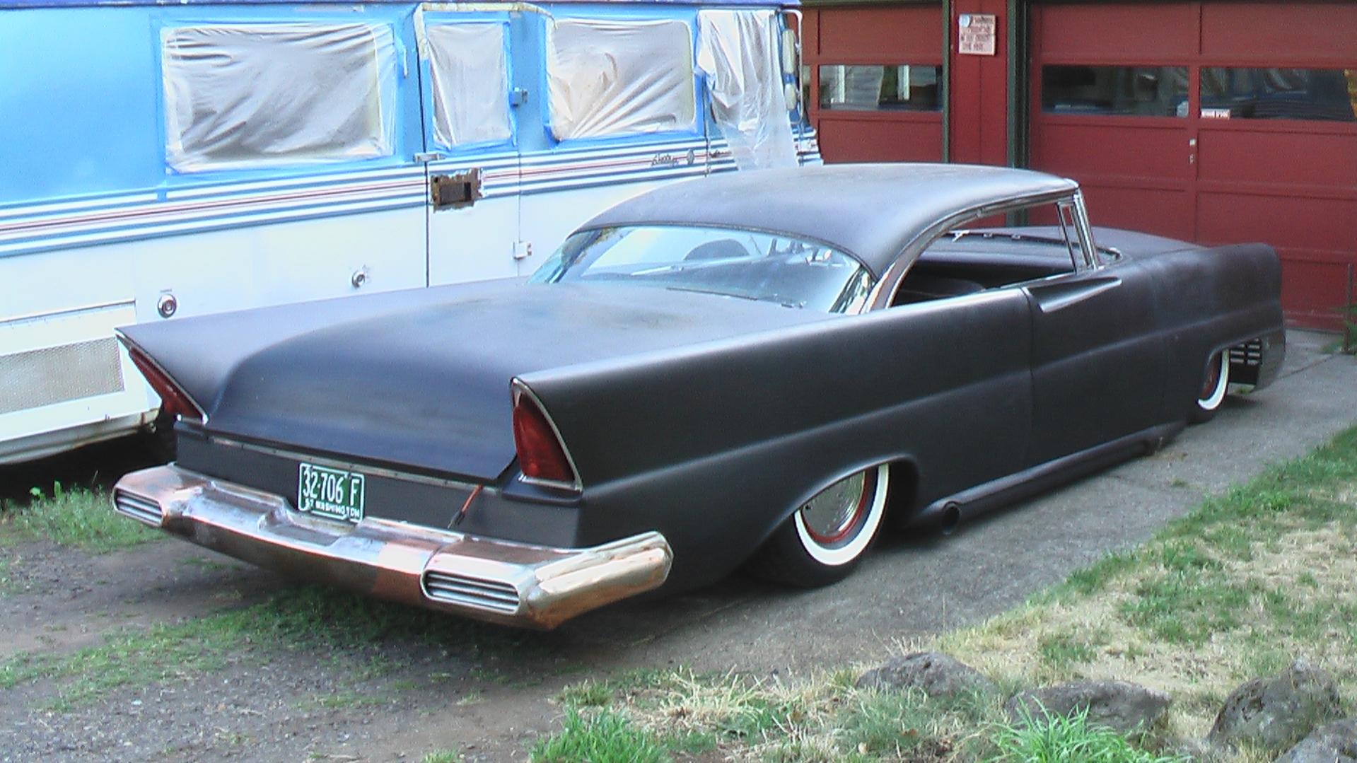

    Man, that chop looks sick in the back!

    Call me for my view on windshield fitting, BEFORE you start cutting and welding the A pillars....IF you want real gl***. 4 in. might be too much, without major trim and pinchweld work.
    Lexan just plain ****s. Can spot it a mile away, and it doesn't hold up well.

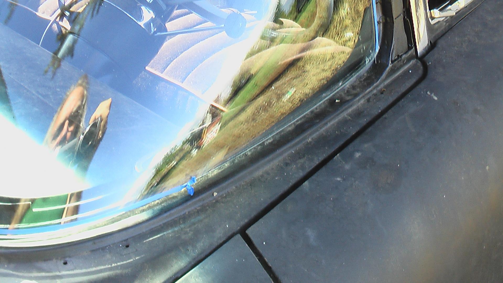

    Talk to a few people who have sucessfully chopped cars with wraparound windshields and got the gl*** to fit. Some think you can just make relief cuts in the upper and lower whindshield posts to line everything up like you would do with a flat gl*** windshield. Others say not to do this as it changes the shape of the windshield frame enough that the gl*** will never fit (cant bend gl***). Ive seen people make their relief cuts in the roof, just inside of the wrap around portion of the opening, and spread the top to fit the lower posts. This way the windshield opening retains its shape.
    A buddy of mine took 2" out of a '57 Chevy wagon roof, relief cutting the upper and lower posts, and they were able to get a windshield in the car. Yours being a 4 1/2" chop, Im thinking you would be better off spreading the top only.
    I would pick the brains of as many experienced customizers as possible before I welded anything up. I think the chop makes the car look great...lexan would do the opposite, IMHO.

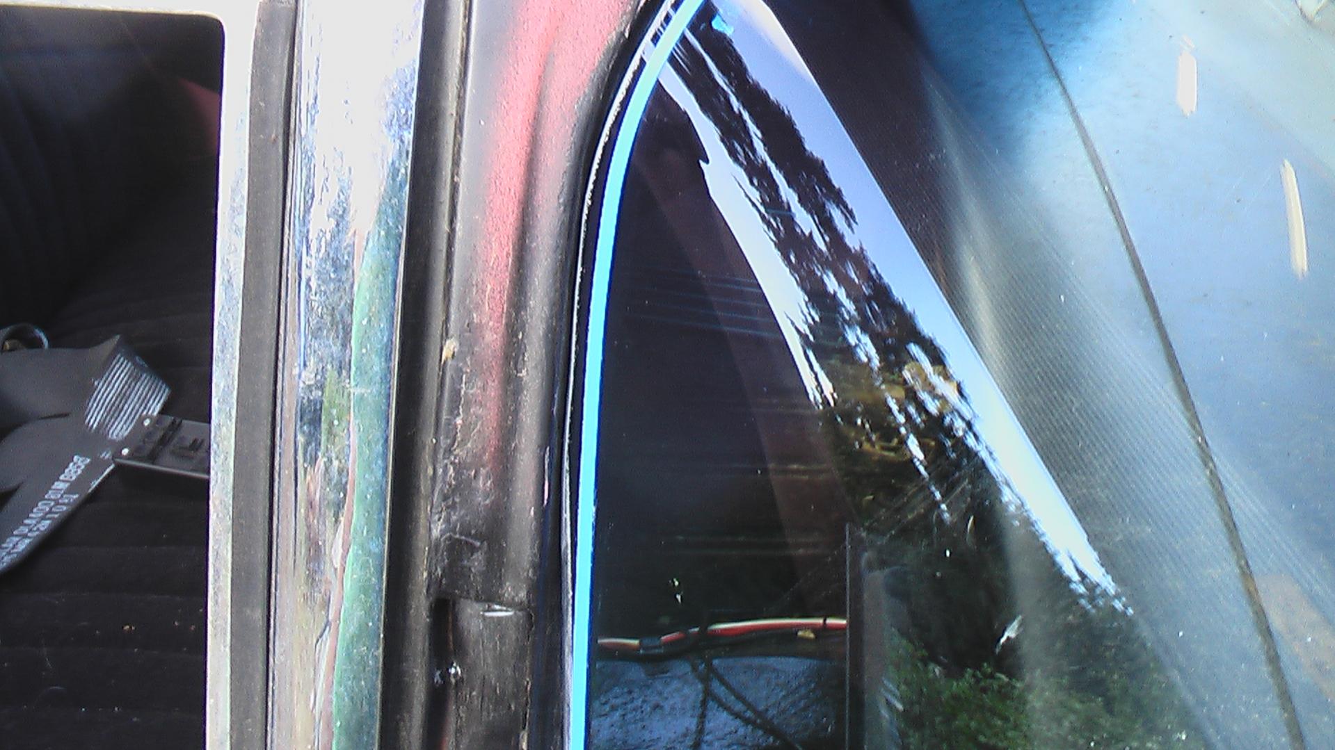

    sink the gl***

    I hope you saved all of the pieces that you cut out. I would recomend the following:
    -tack in temp braces along the side of the roof to hold it up so you can cut the front windsheild area and rear window area free from the roof.
    REAR WINDOW_putting the rear back to it's stock configuration, make sure the window fits, pull the gl*** back out, weld some bracing in the window frame and then lean it forward to match the roof. Almost like the window would pivot from the very rear/lower portion and the front/top would rotate down ward until it matches the roof.
    FRONT WINDOW-sinking it like most of everyone else had said...so putting it back to stock, make sure windsheild fits, weld in braces and then sink the frame into the cowl until it maktches the roof.
