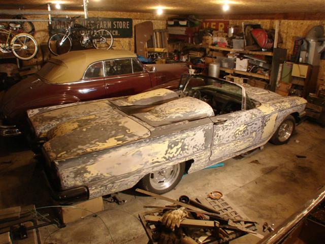

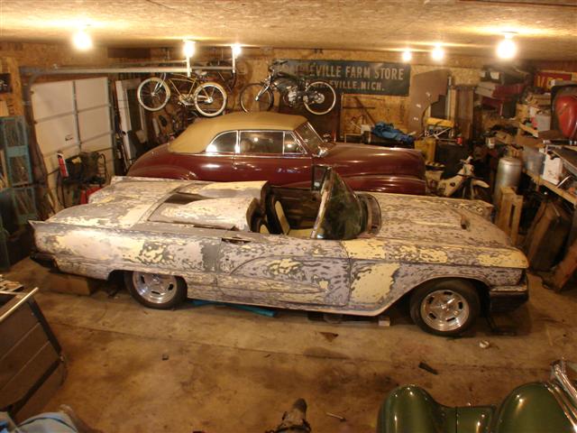

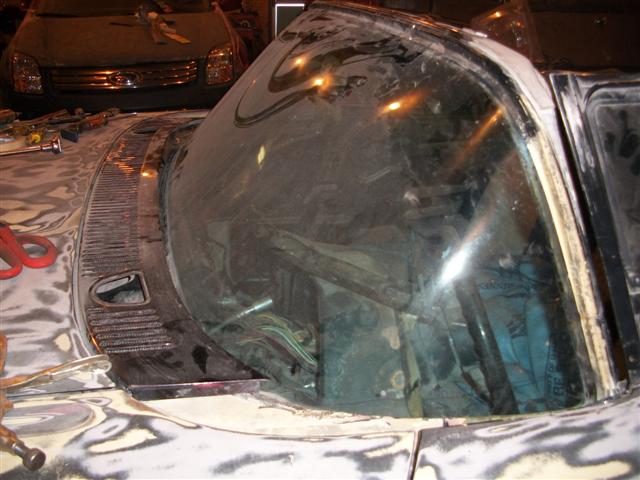

    Ummm... No offense, but have you heard the expression, "Don't put the cart before the horse."? Chopping a wrap around windshield car's top is easy, it's the fitting the gl*** that's the challenge.
    I've done two now, a '56 Cadillac and '59 T'Bird, may I suggest that you cut the w/s FIRST, then fit the frame to the gl***. The way you've gone about cutting the posts looks fine UNTILL you try to fit gl***, which, being compound curves, will NOT be able to be fitted to the frame. You can stretch, shrink, hammer, and reshape the posts to fit the gl***, but not gl***. The Caddy I cut almost 4" off the top and a little of the rear corners, and the upper part of the vertical to lean it back a little. The T'Bird is uncut and sunken into the cowl just over 2". A little more subtle.
    Also, do NOT believe that there's any way a Lexan w/s will be scratch proof. Lexan, even the scratch resistant variety, is very soft, and will scratch. Easily. Again, I'm speaking from experience here, the Lexan w/s in my '36 is scratched badly despite my being very careful to clean it with nothing but microfiber cloths.

    Yes I do. Here's my 'Bird with 2" sunken w/s, all the dog leg will allow.
