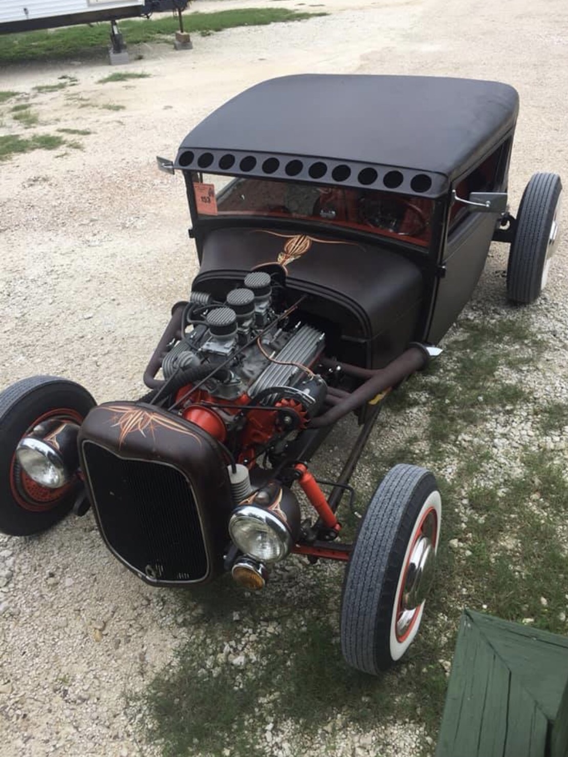

  6. pecker head
    Joined: Nov 8, 2006
    Posts: 4,469
    pecker head
    IMG_5012.jpeg My 28 chopped 5” with 30-31 visor.
  7. Is it? I did not know that, thanks. I was thinking the chop on the car in question is 3" while my '30 Tudor is cut 4" and it is not too bad to see out of.
    Wonder if the O.P. could do something with the seat mount to get it just a little lower... just a thought.
    pecker head likes this.
