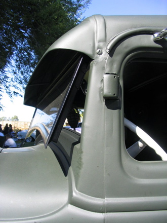

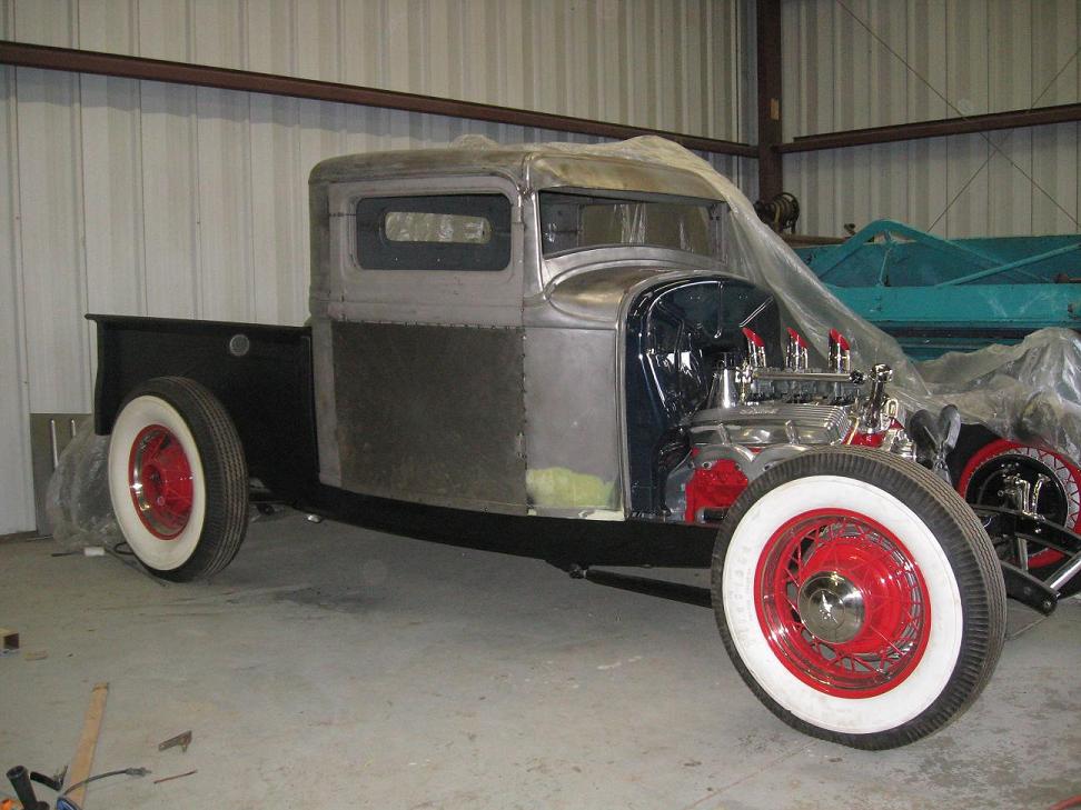

  9. I was looking through a bunch of pictures from old shows and I found these two '33 or '34 trucks that were at Billetproof in Antioch a few years ago.
    I chopped mine like the green primer one, leaving the top of the windshield hinged on in the stock location, and slanting the windshield pillars back in about the same area. You can see where he pie sliced some of the pillar so he could pull it back to line up after the chop. I did a similar chop, but pie sliced it further down so the change in profile would be a little more gradual. When you do it this way the top of the windshield fits fine, but the center of the bottom of the windshield hits sooner than the sides as you start to close the window. I have never seen a truck that's been chopped this way with the windshield closed all the way so that it's flush at the bottom. I think you can get it almost all the way closed, but not completely tight in the lower corners. That's how mine is going to be I guess, so that's why I'm wondering if it's just a waste of time to put rubber gaskets that might not seat against anything. It might look better without them.
    The red primer one looks like they pushed the top of the windshield forward so that it would close right on the bottom end. I don't know if they just slotted the hinge strips to push out the top of the windshield, or if they actually moved the whole mounting area forward.
    I met the guys who owned these two trucks and they were real nice guys -- they had driven there that morning from about 4 hours away -- which is a long way to go in a chopped and channeled pickup. I like those trucks a lot. They have a real nice stance.

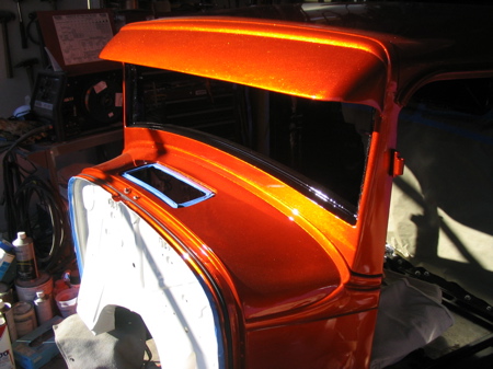

  13. Yeah, I guess I just did it the hard way. I sliced away the outer sheet metal of the pillars and pie sliced the inner structure to chop it and ran some inserts up through the inner structure even to make it stronger, then I pie sliced the outer sheet metal and welded it back on tilted back to line up straight again. It came out pretty smooth. I also welded some radius pieces in the lower corners of the visor to give it a little custom touch there.
    Here's some pictures from a while back after I had just painted the cab. I painted the insides of the openings black and masked them off first because it would have been a pain trying to get candy inside there.
    I later chopped and then pie sliced the moldings that go in there on the sides.
    I think the windshield will work fine, but it will just be poking out a little in the corners instead of lying completely flush. There might be a gap of 1/8" or 1/4" or so behind the corners. I think I'm probably going to be driving around with the windshield propped out most of the time anyway for lots of fresh air.

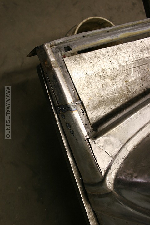

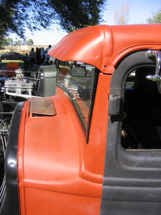

    Here's one that is chopped 6", not sure if it helps, but may be a good reference for someone else. Top of the A-pillar was pie cut on the side and pulled out, bottom was pulled in.

    Let's see a pic of a full on shot of your truck. That color is badass on it. Just gives me all the more drive to finish mine. As far as the w/s frame chop I had no problems with my last truck with a 3" subtle chop? I probably did something wrong and yet to realize it! It opened and shut just fine.
  19. Nice pic! Says a 1000 words. Got any more? How about the whole truck? I want to see how short 6" is :D

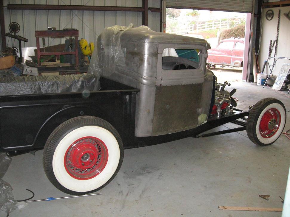

    this one is cut 6" and the window shuts, forget what i did to make the window shut, its been awhile since i did it, didn t pie cut the a pillar though, i think i extended the pivot flange where it bolts to the roof, but im not positive at the moment:rolleyes:

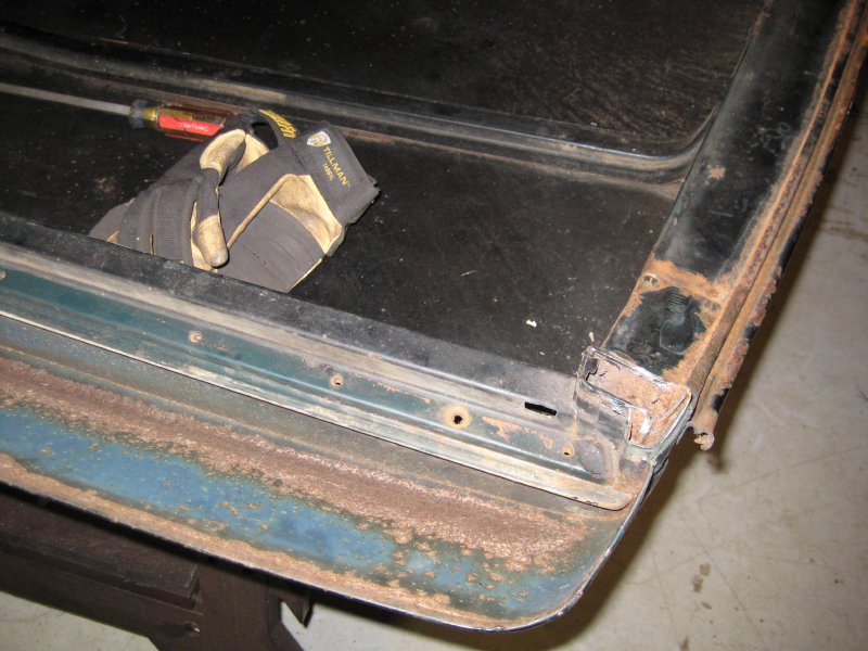

  30. Dznuts - we just did this last night :D - I'm still tired. I'll tell you what we did - maybe right - maybe there are better ways. I was glad to see this post before we got into though.
    6" chop - cut the front post right where the curve starts. Tudor is up to the task.
    Then squared up some stuff. The top of the upper post and the roof post are now offset.
    We took all the screws and rivets out where we could and still had to work the header pretty good to get it out of the roof.
    Then you can see where the front needs split and widened to fit the wider lower post.
    The other thing that showed up - need to take about 1/2" out of the middle of the header. It was too wide to fit now. Will probably be making new holes for the window hinge.
    Then I'll make a few small patches to fill in the new space in the upper post.
