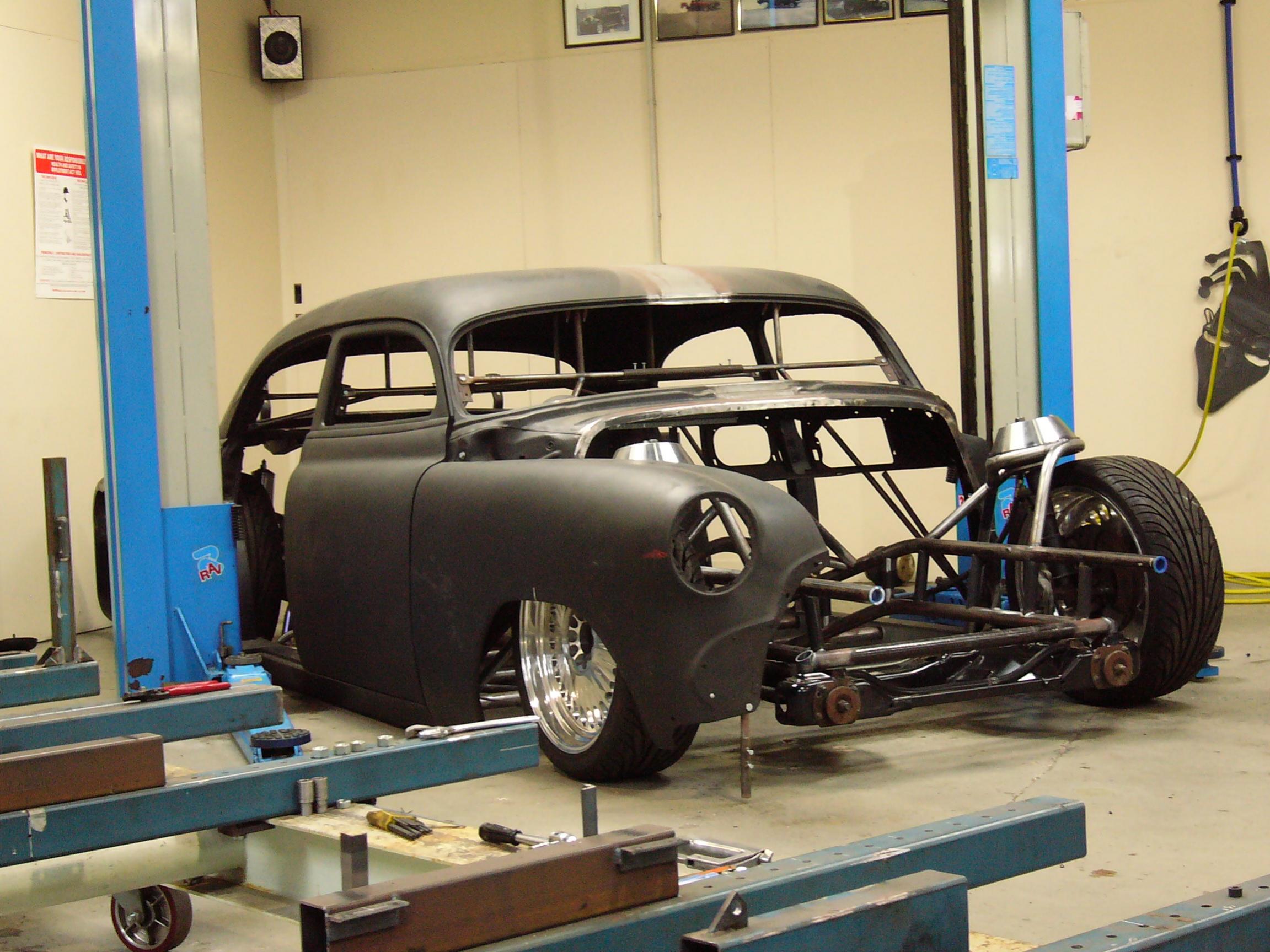

    Widened right down the middle! I've never seen that before. I really want to see this car with paint and glass in it. That was an insane amount of welding and fab work.
    It's going to be a lot tougher now for the naysayers to tell you it isn't going to work when it's already done!
    So what are the plans from here on out? Paint, chrome? Are the back doors functional? For a 4 door with stock length front doors, it has a nice quarter window to door glass ratio. That's usually where a lot of 4 door chops lose it for me.

    all the sheetmetal used on the car is 18 guage so im not worried about that at all. :D

    thats a problem with an easy fix the only reason it wasnt fixed in the pics was i didnt have a way to get enough muscle from teh inside of the car to fix the low spot, i have a porta power jack now that will allow me to correct it.
    took me over 2 monthes to find the caprice in my budget, i wanted an 80's malibu ( as a matter of fact i havent found a good donor car since either because i want one for another project) thats why i used it.
    plus what the hell ive never seen a car widened before.

    So rather than cutting the frame to fit under the car, you made the car bigger to fit over the frame.

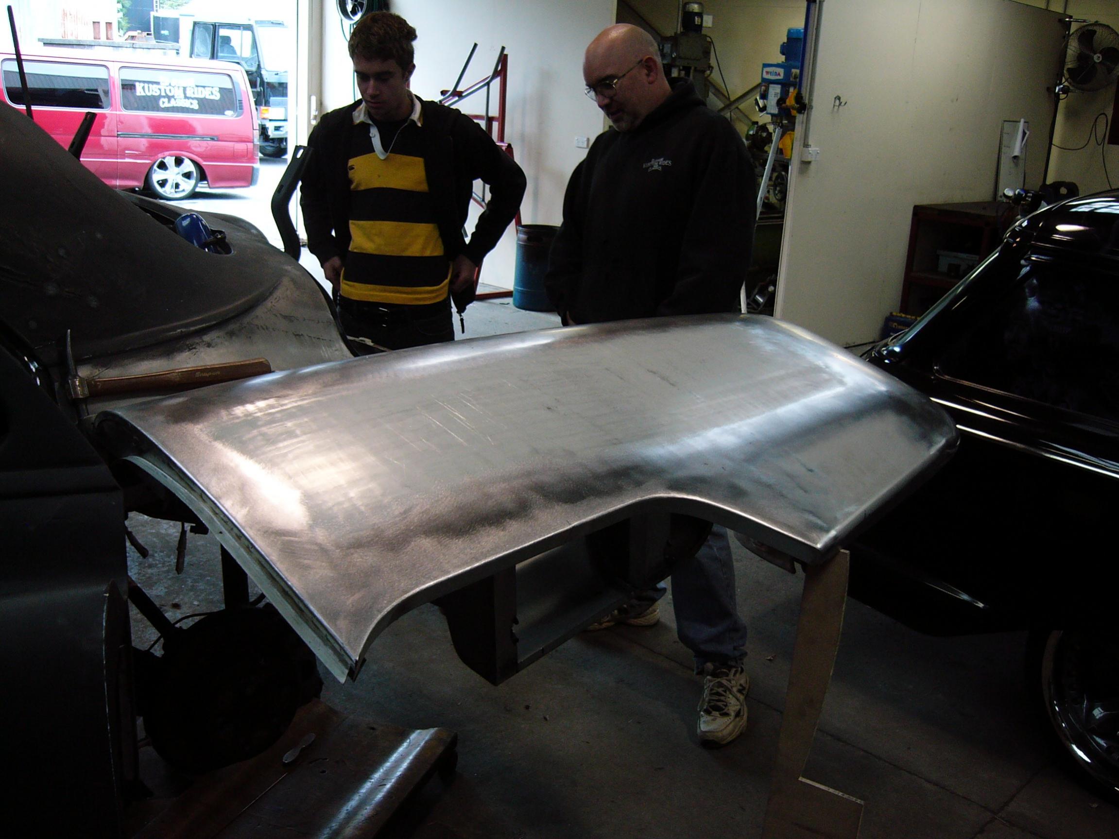

    I went back through all the pics with good shots of the roof, and it looks like you're going to have a hell of a time popping that out. It almost looks like the piece you welded in was a hair too narrow, which forced the side pillars to lean toward the center of the car. Or, like the pillars needed to be pie cut to allow them lean outward so the roof sections could line up better.
    I hope the porta power works for you though, cause it would suck to have to cut it apart again.
    Good luck!

    Looks like the reason the fenders are lengthened is to allow the car to have a radiator...without having to relocate the engine rearward and all that would involve.
    Makes me realize something;
    Placing cuts where they require the least amount of welding doesn't always equate to the least amount of total work!
    Next time...plan your cuts around the high points of the crown in the panels...even if that requires long runs of horizontal cuts to make everything work.
    More welding...but you keep the pleasing roll in the various body panels and less metal shaping.
    I give you an A for seeing it thru. You tackled a job many would have let rot and did it your way without blinking an eye!
    Thats pretty cool.
    Use what you learned from this one to make your next one even better!

    the stock 83 caprice engine and drivetrain.
    350 chevy with 350 turbo

    mostly just get it all driveable and wired ect. ect. , proly got another 3-4 weeks until completely done.
    then drive the wheels off it this summer in bare metal ( clear coated), and tackle all the body work and get it painted this winter.
