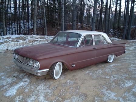

    another pic. How do you guys think it looks now? Thanks Nate

    I'd drive the hell out of it- as is. The only thing I'd change is the 6 cylinder part.

    Kustomizer, your Comet looks great the way it is. In my opinion, I wouldn't bother with the Cragars. Those full moons look really good.

    i like the 6 cyl. Unless your building a go fast car i think the only good part about a v8 is the sound. I think my 6 sounds good thats why im keeping it! Thanks for the feedback! Nate

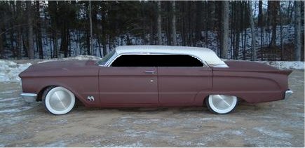

  10. heres my idea, still looks stupid choped... But it sertantly looks cool strait like that..

    builtbyme
    Just needs a little tweakin Rat Rodder...
    Sorry bout the size. Gotta get some editing software 'stead of using Paint.

  20. Scraper
    Joined: Oct 1, 2003
    Posts: 91
    Scraper
    Geez..I lay low for a while and look what happens. Just kidding. Nate, I drive a uni-body car that I chopped 3.5". No twist, no flex, no craked glass, no shit. If you want to chop it,besides completely gutting it, start by forming x-braces at the b- pillars right below where you plan on making the bottom cut of your 4 inch chop. Weld it to the pillar on one side and the floor to the opposite side, do the same with another piece ( I'd use 3/4" conduit) from the other pillar and weld where they intersect. This will keep the sides of the car from wanting to fall in. Then, with the glass out front and rear, take the same conduit and measure from the top pinch weld that the wheatherstrip holds onto to the bottom one. Do the same for the rear window and cut 3 pieces that length for each opening. Why? Because the way I did mine, I didn't cut into the A-pillar, My front windshield is leaned back and rear glass leaned forward. The windshield was done by cutting the roof off about an inch behind where the pillar meets the roof (it is a vertical cut) and through the roof skin across to the other side. By cutting there, it makes it easier to line it back up due to the extra material. Then, at the base of the pillar, take a wedge cut far enough in to allow the pillar to lean back. Take a grip of measurements! You can never have too many of the stock top as a reference for the chop. You do want a squared-up roof, right? Also, to get the pillar back, it will be neccessary to either cut through the inner skin of the fire wall or through the cowl. The dash will have to be cut out for the chop anyway so the choice is up to you, I've done them both ways. I did mine through the cowl and cowl vent which I sheeted while welding the top back on..we don't need no stinking vents! Air gets pulled through the inside of the front fenders so you're not sealing any thing off completely. The cowl cut also helps the wipers because they will end up leaning the same as the windshield. Anyway I can go on for days, but the point is it can and has been done. About the column in the chest thing, it will happen either way so I wouldn't worry about it. Cars from the 60's WERE crumple zones. If you are that worried, get a fucking collapseable column. I figure if I die in my car I'll die happy so personally, I don't care. Good luck with the chop, and remember..Measure, measure, measure, and brace it. and if you notice the car sags in the rockers with the top off, support it with a floor jack when you weld it back together. Mine didn't but I've seen cars that sagged and had one that bowed up, which was fixed by putting a jack undr the rear of the car and lifting untill it was gone. You will know if anything moved by checking the door gaps, if they aren't the same as they were before you cut, it moved. later. Btw, I've done 7 chops with no problems that couldn't easily be fixed..just expect shit to go wrong.
