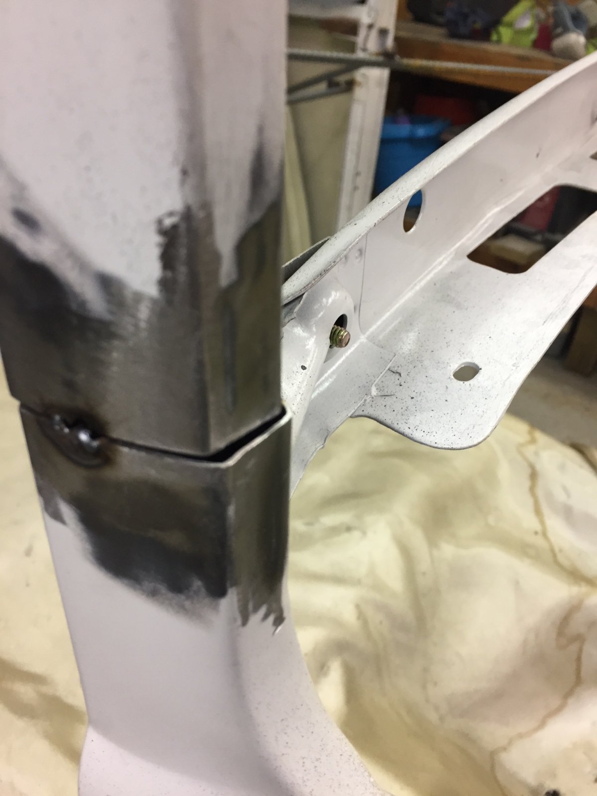

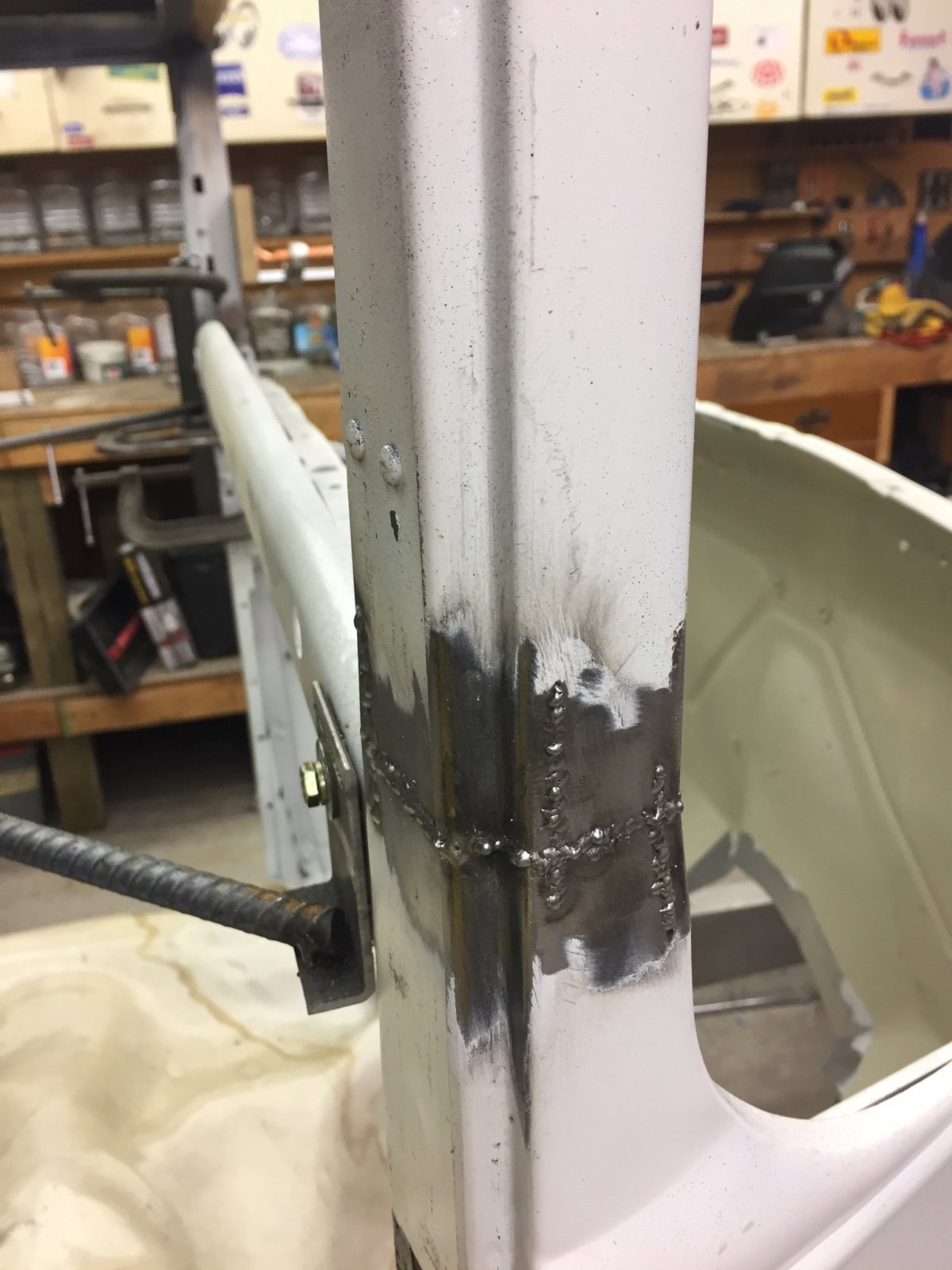

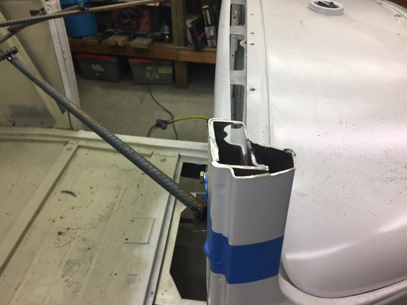

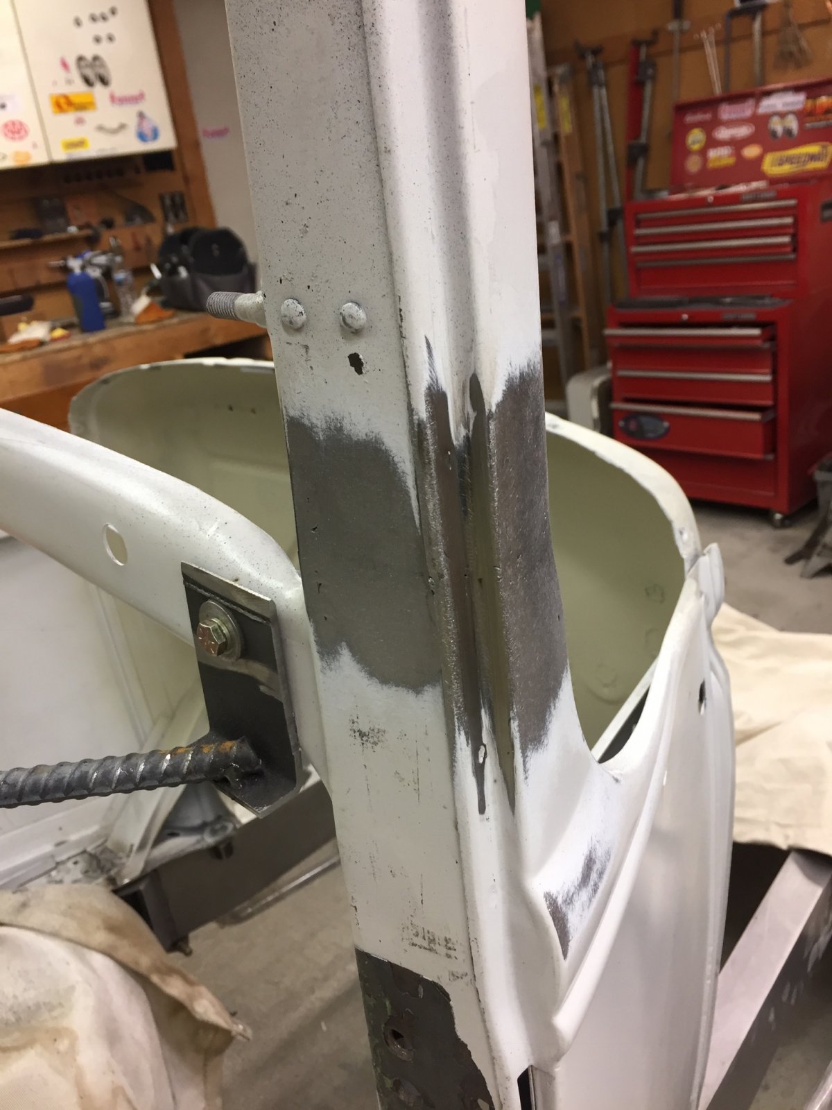

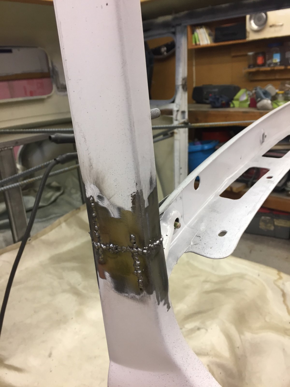

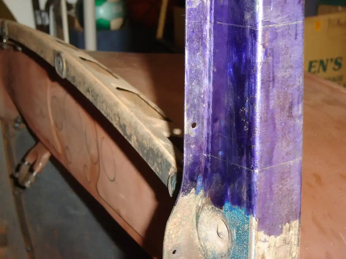

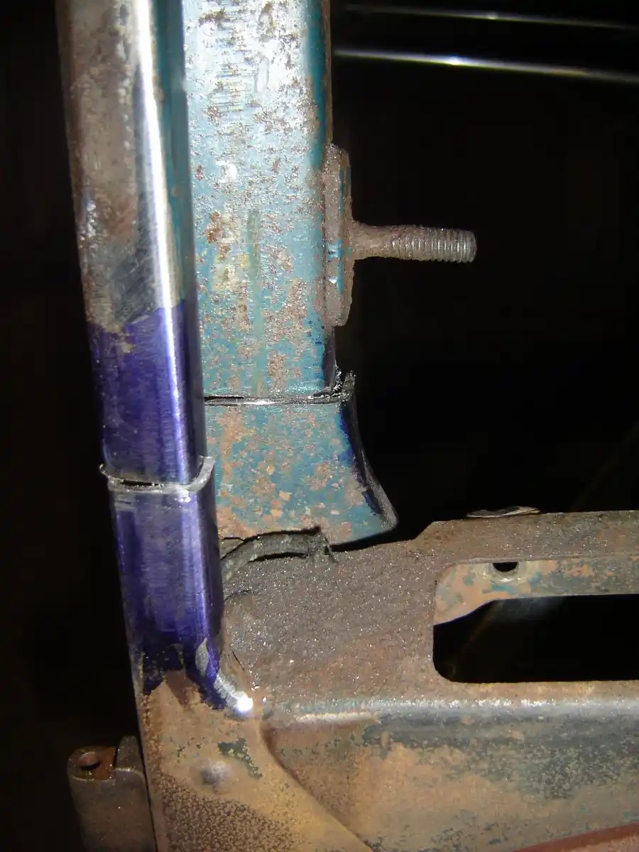

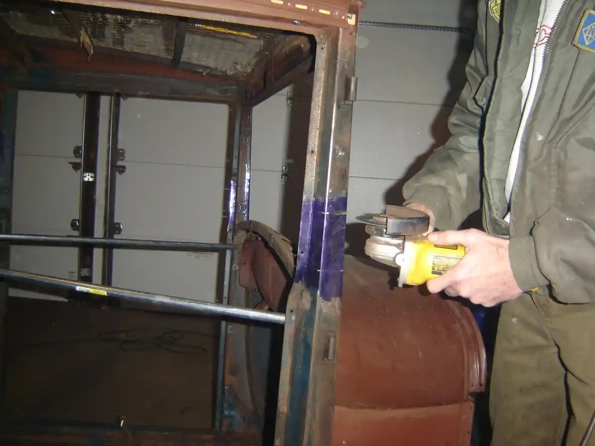

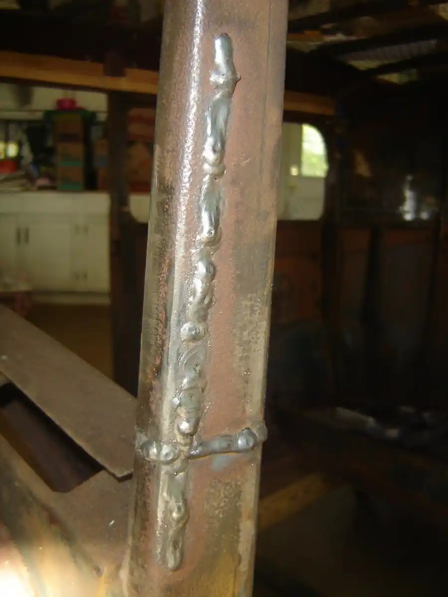

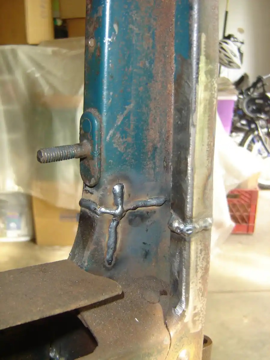

    Here is how I did the 3 chop on my 31 tudor.
    I actually split the corners of the post and worked the edges until they basically lined up then welded the corners back up, some grinding with a disc and it really worked out well.

    I have some chop pics in my thread in the early pages. There may be some details that help.
    @Just Gary gives good advice, my windshield pivot studs are a little low. I/we didn't know better back then.

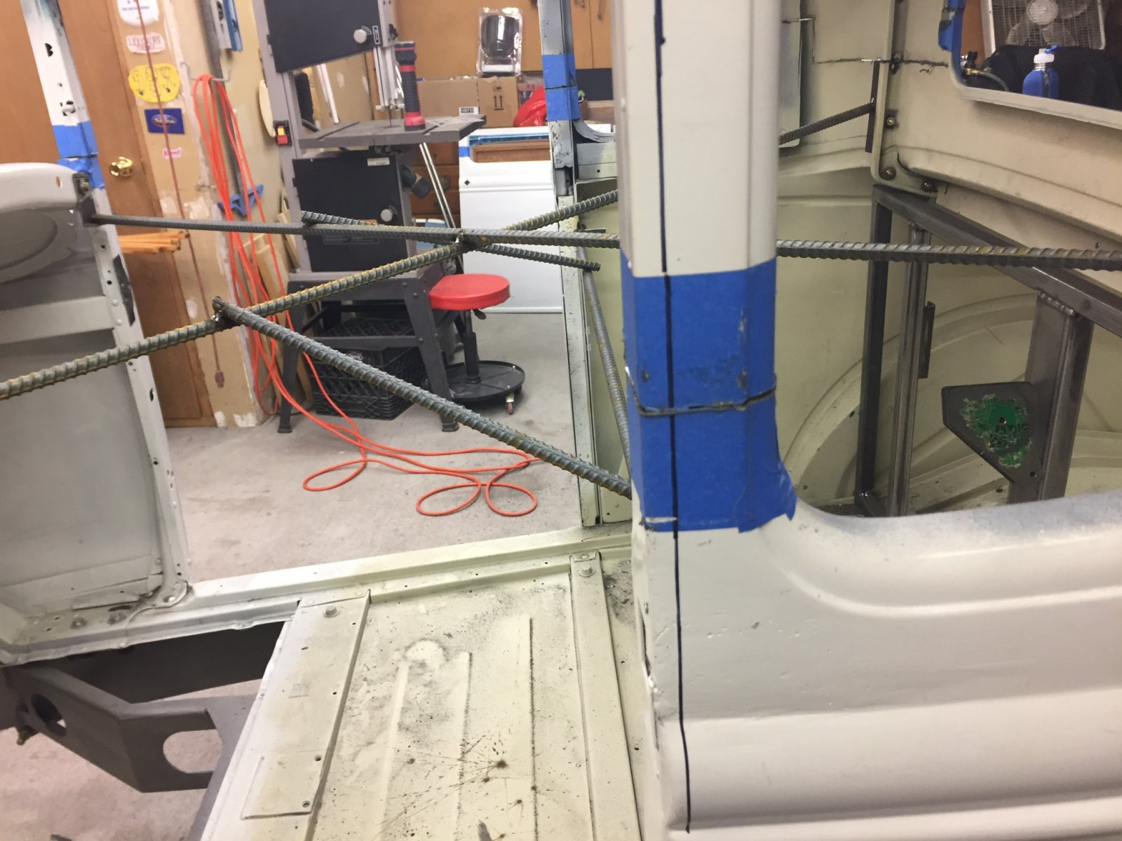

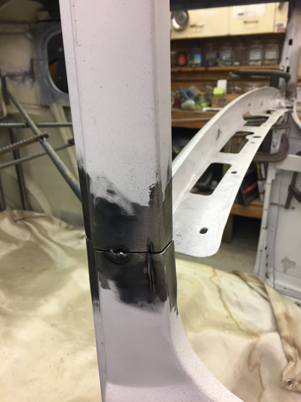

    Here’s a close of my 31 A pillar 56AA2238-0332-44FD-8DB0-2CDADA3E143E.jpeg F3BE133F-648C-4866-9038-B791F6091B40.jpeg BC9C431A-1F1A-40D4-9988-2BD159200F3B.jpeg DA8EC9D6-A2EB-48C8-A3B4-CA10B0039F06.jpeg 2BAC9112-88C9-4330-ACD1-A9CBCC37393A.jpeg 3919C885-24BD-4C53-B932-D2338BAEE2AD.jpeg 6E63D0E1-45B9-4E90-A985-FDFD3937B92C.jpeg

    Pic #2 is the B pillar :eek::rolleyes: sorry:D:D
