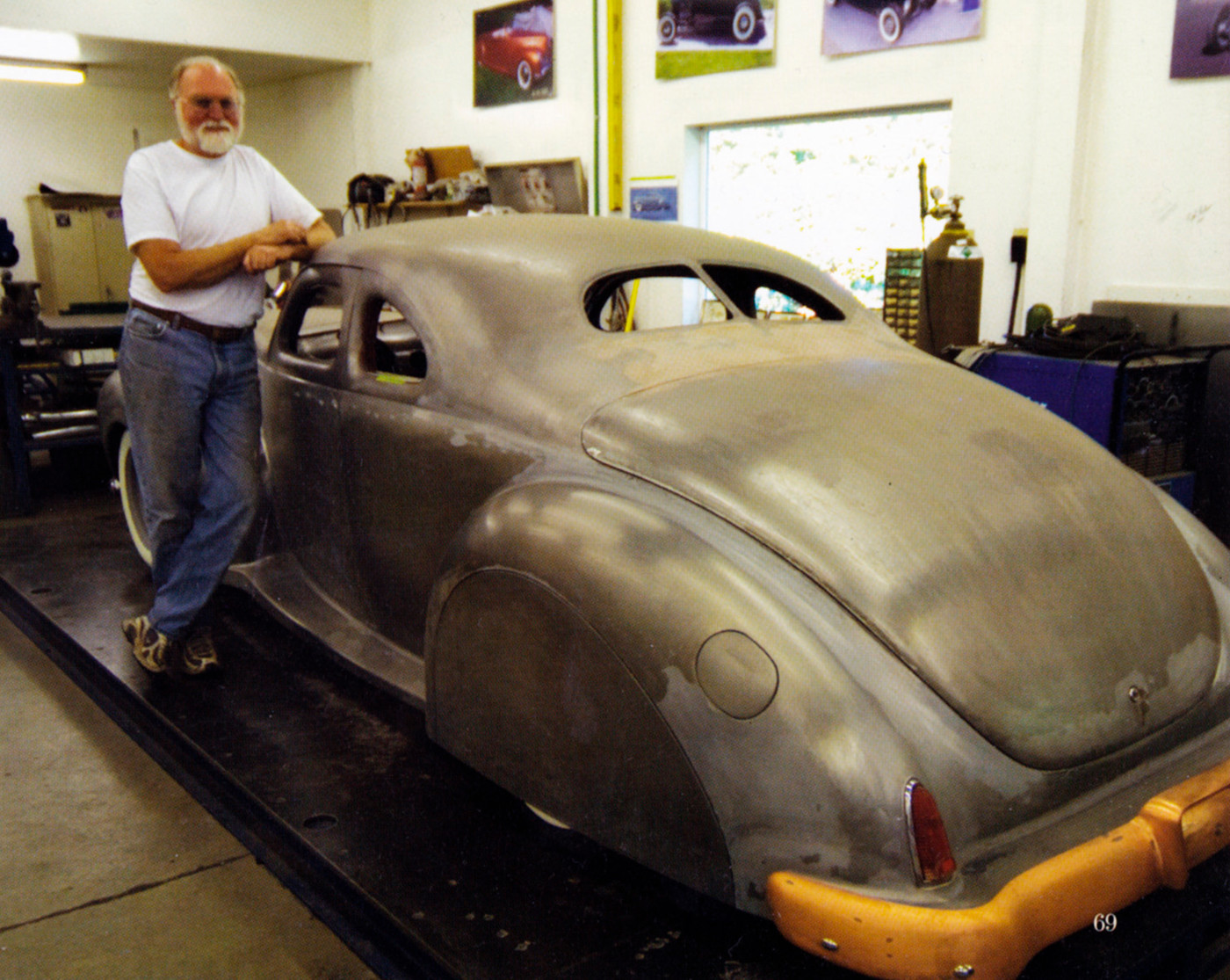

    In the latest Hop Up magazine there is a 1940 Ford coupe being built by Donn Lowe.... that car is just as perfect as it can get.
    Chopped and sectioned.. and a lot more done to it.. so elegant!!!
    I have seen other photos which I cant show.. but this scan below is from the Hop Up magazine.. and it proofs - once again - that even 1940 Ford coupes can be chopped and that it will look very good.
    But as said before, a chop like this needs to be planned and very well designed to work. The windshield has to be angled back, but just the right amount. The hump at the rear of the top needs to come down... but not to much.
    Both samples in this post show that it can be done.. and there are plenty of other samples of chopped 1939-40 Ford coups that look very good.
    So... please go ahead and chop it.... but take your time and study as many samples as you can find.

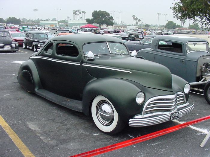

  29. shoebox1950
    Joined: Jul 17, 2008
    Posts: 1,221
    shoebox1950
    This car was chopped by my pal Brandon Winters from Jack's Lowrodders in Fountain Valley, Ca. One of my favorite '39-'40 Ford coupe chops...well proportioned.
