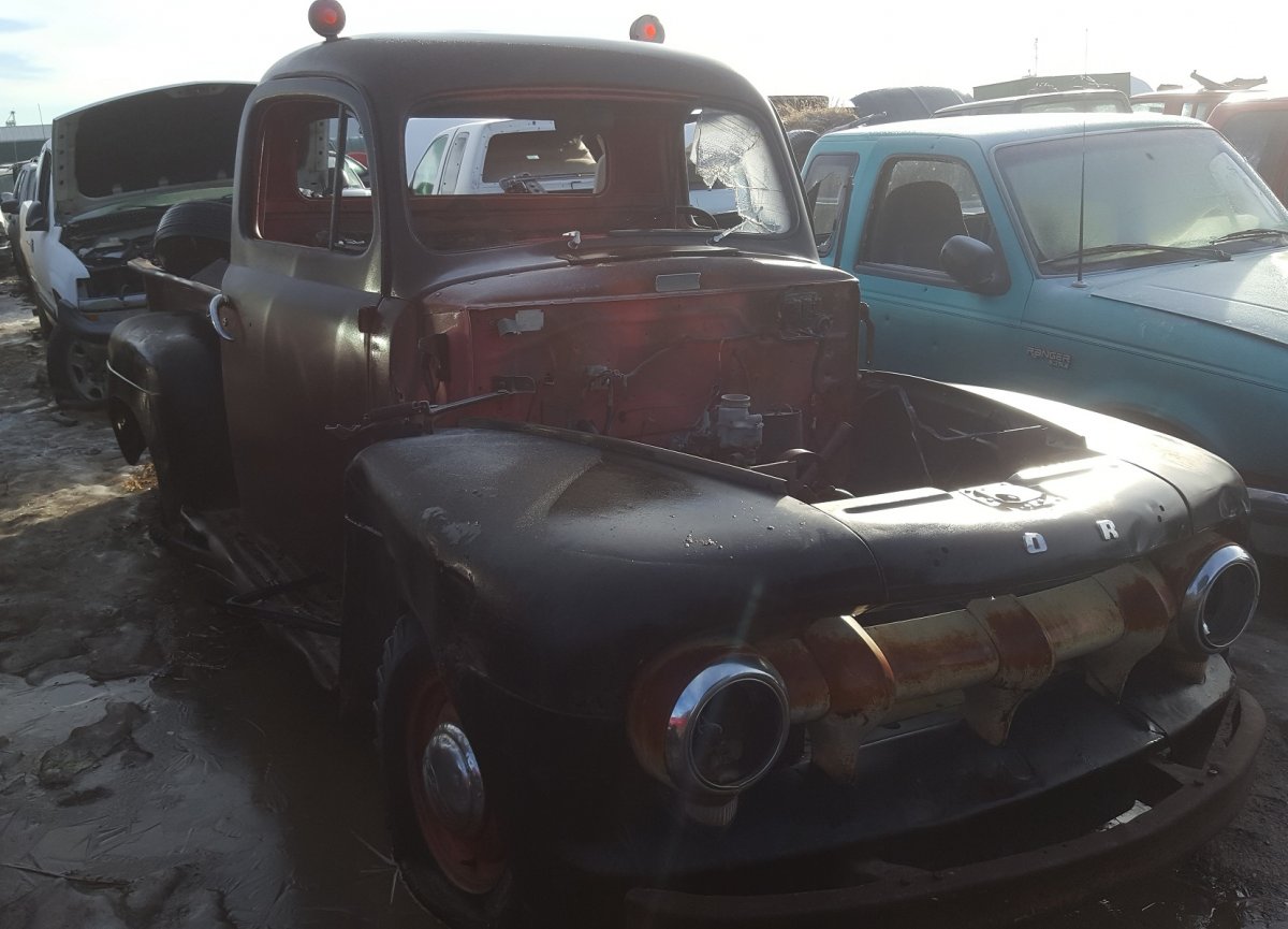

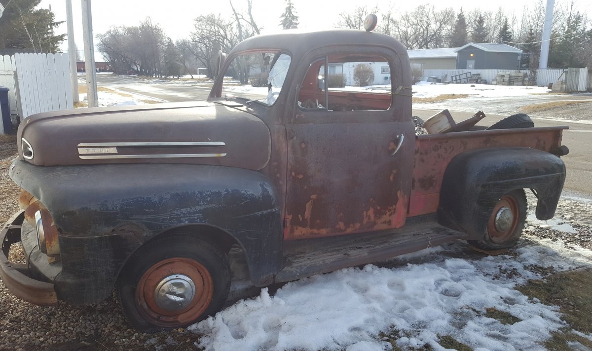

    Nice save there. I've got a Fargo that came from out your way, in Zelma, Sask. Sure nice to see this Ford get saved.

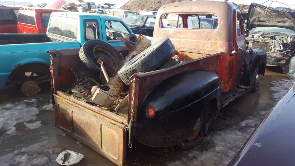

    getting an old truckster like that at Pick n pull is like rescuing a one eyed 3 legged 10 year old dog from the pound. your neighbors will think you are crazy, but all the cool kids will think of you as some kind of hero.
    at the "corporate" junk yards around here they put cars they may be able to sell as whole in a used car area up front.

    Scrap is about $150 a ton.truck with motor and trans comes in at around 3000 lbs.so if you got it for $150 you did OK.

    That truck looks nicer than some of the ones I checked out on CL!

    Good save, anything you do with it will be bringing it back to life, it's on its second life, barely escaped becoming lawn furniture, sbc-thats fine.
    Lot of good threads on here about budget trucks, pulling pieces from all model trucks and using them to make a great driver. Why not go thru the parts pile and use up some stuff you have on hand.
    Are you keeping the frame as is, or considering a front suspension, clip swap?
