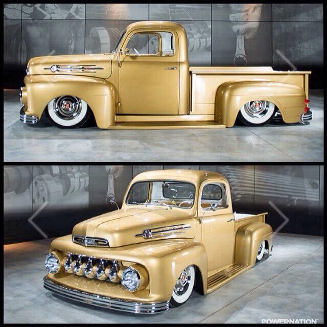

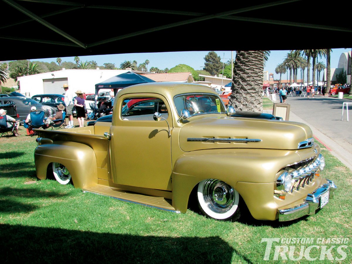

  6. love these trucks
    excellent work and nice save
    here are a couple of my favorite f!s

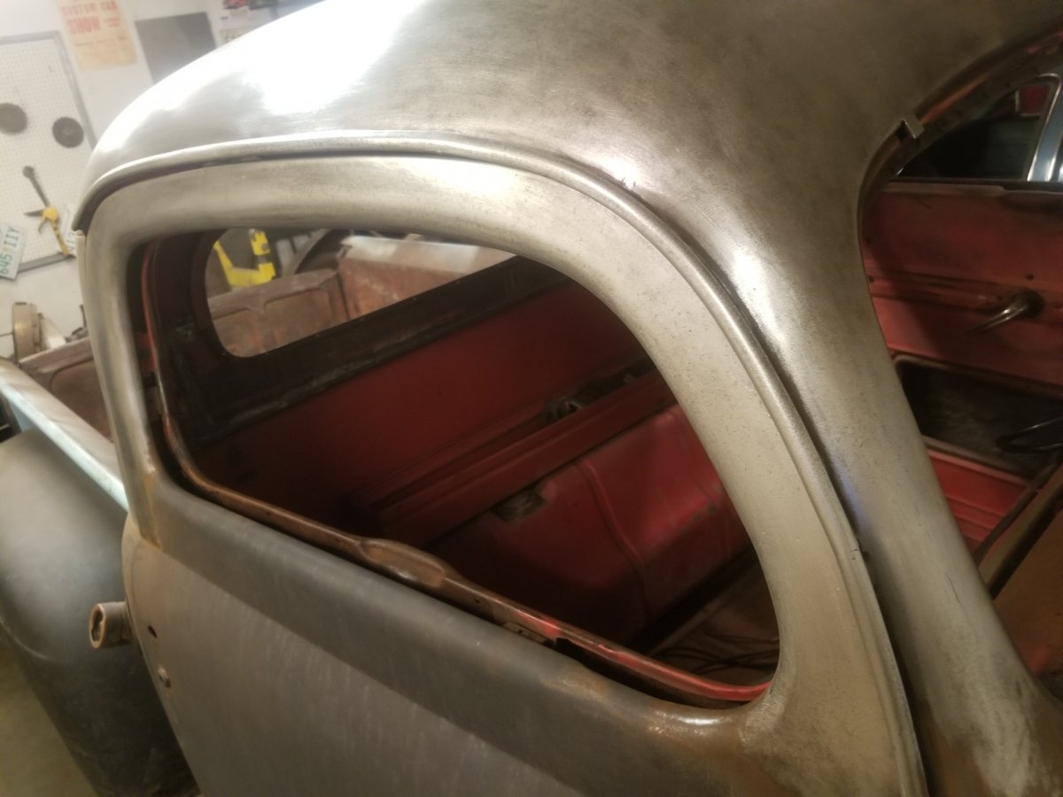

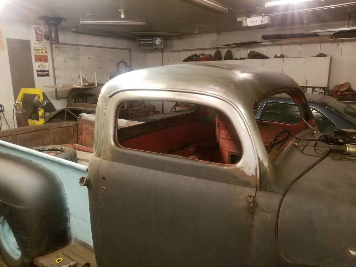

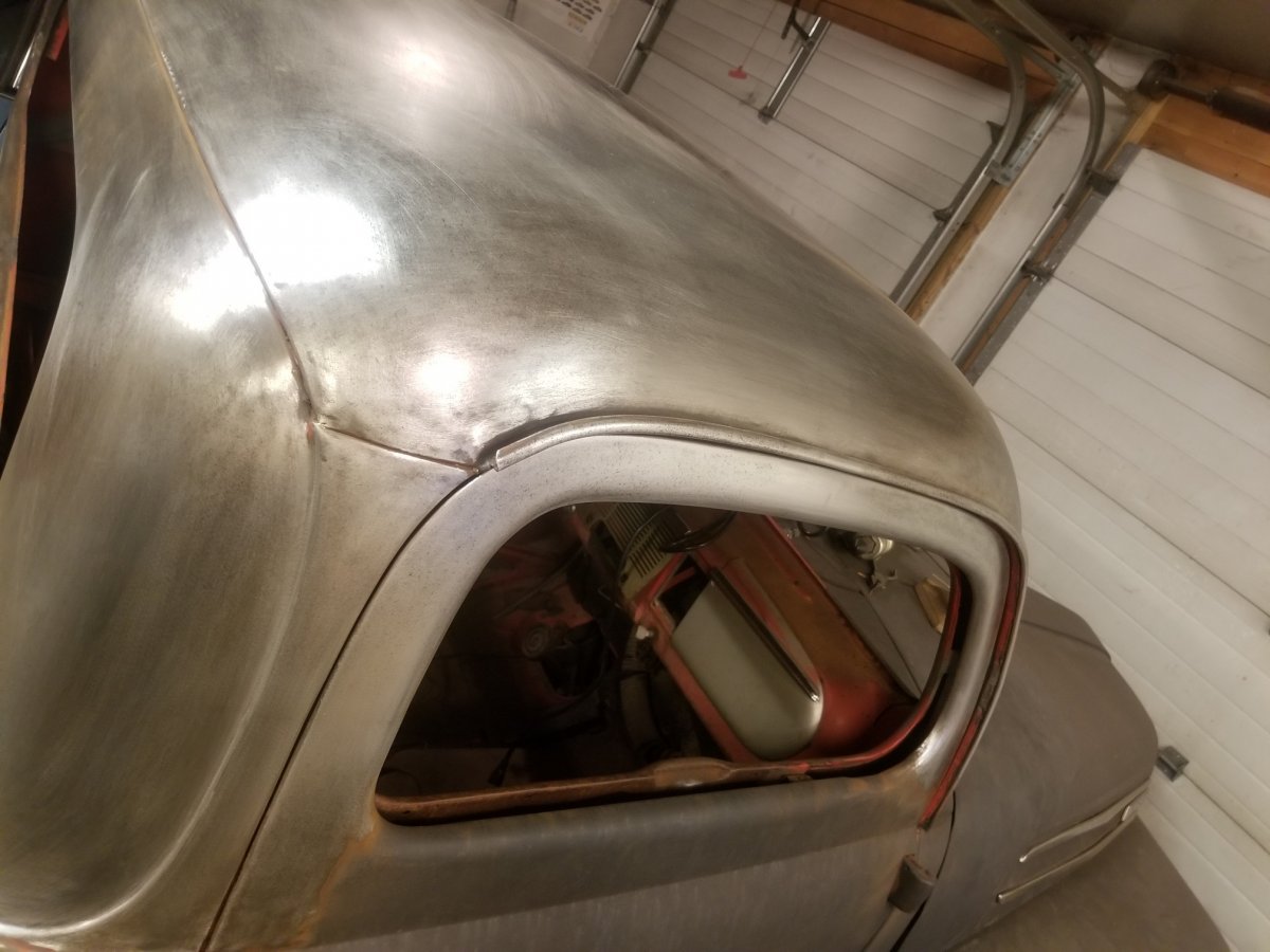

    Fast forward to last month I decided the most responsible thing to do during a global pandemic would be to drag this thing back in the garage and finish the chop.
    I decided to start beating the roof skin back into submission. This was a daunting task seeing as how I have no idea what the hell Im doing, and also I didnt do myself any favors by welding the **** out of the roof 2 years ago...
    These pictures are the results of many many hours of barbaric hammering, the drivers side and center is more or less ironed out, where the p***enger side is still being finessed
    20200429_210111_resized.jpg 20200429_210138_resized.jpg 20200429_205818_resized.jpg 20200429_205857_resized.jpg 20200429_210222_resized.jpg 20200429_211902_resized.jpg 20200429_211930_resized.jpg
