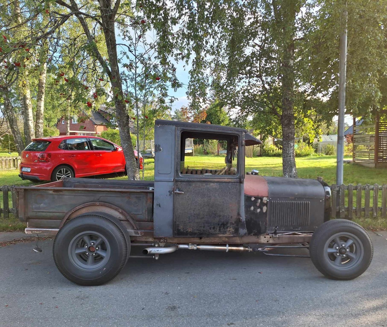

    I bought a 29 pickup a couple weeks ago, ive sorted out some "rat rod" mounts/frame work on it and other stuff and now its time for some fun.
    Im leaning towards a chopped top, planning on a mild chop and eliminate the panel over the windshield.
    Has anyone got pics of doing a 28/29 pickup chop?
    Im thinkin of the really small rear window, i have to keep that intact.
    The rear cab is just bolted pieces so im thinkin of cut the lower piece under the rear window panel and keep the top panel with the rear window intact.
    Any tips and suggestions would help.

    Make sure you can still fit in it, not only head room wise, but pedal placement. Those cabs get very small very quickly.
    Neat little truck, good luck with it.

    Well, you can't put the seat back, so get some blocks of wood (or something else), put them on the seat in increasing depth 'til you can't see out the front. Rinse and adjust.

    Like what was shared previously, these trucks get very small fast.
    I built a 29 phone booth fendered pickup three years ago. There’s not a lot of places to put batteries, a heater if wanted, or room to bend your knees so that you can operate the vehicle and still be comfortable along with seeing out of the windshield. I’m 5’ 8” and I could last about an hour driving till I wanted out so I stretch. Mine was not an all day driver that I would want to travel long distances in.
    Don’t get me wrong, it was a fun truck but not really comfortable IMG_5040.jpeg IMG_3482.jpeg

    Additionally, if you remove the upper header panel then you will need to change the mount for a windshield wiper (easy enough to do, except now that’s going to be in your vision space above the windshield frame).
    Then what will you do with the visor? IMG_1885.jpeg It mounts over the header panel. When you drop the height of the cab then you will be dropping the vertical location of the visor so now you are limiting your visibility again.
    To me, the visor is such an important piece of the visual presentation of the truck so removing it would be a shame
    Be aware, the rear window panel is busy with raised sections. It won’t be a nightmare but you will have some work to keep everything flat IMG_2345.jpeg
    Don’t want to rain on your parade, just some food for thought

    No chop, your vision out the front is going to ****. Fenders and no chop.

    I like the way yours looks without the fenders. Almost inspiring me to build my patina CCPU fenderless annd unchopped while I wait until I find a set of perfect black lacquer fenders.
    idk maybe it’s the dark grey mags and hairpins that are doin it for me but I love it.
