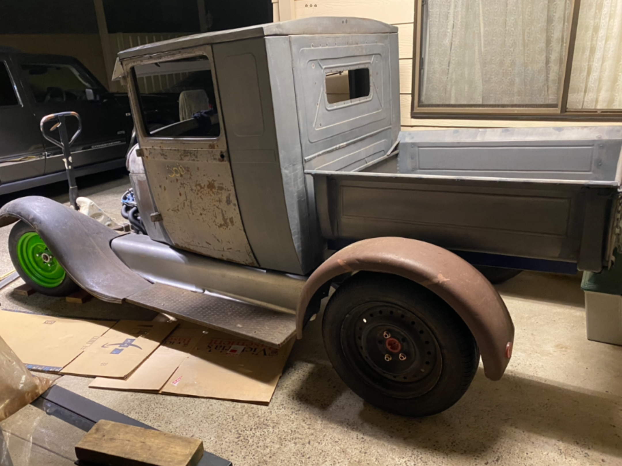

    I extended the cab 3 inches

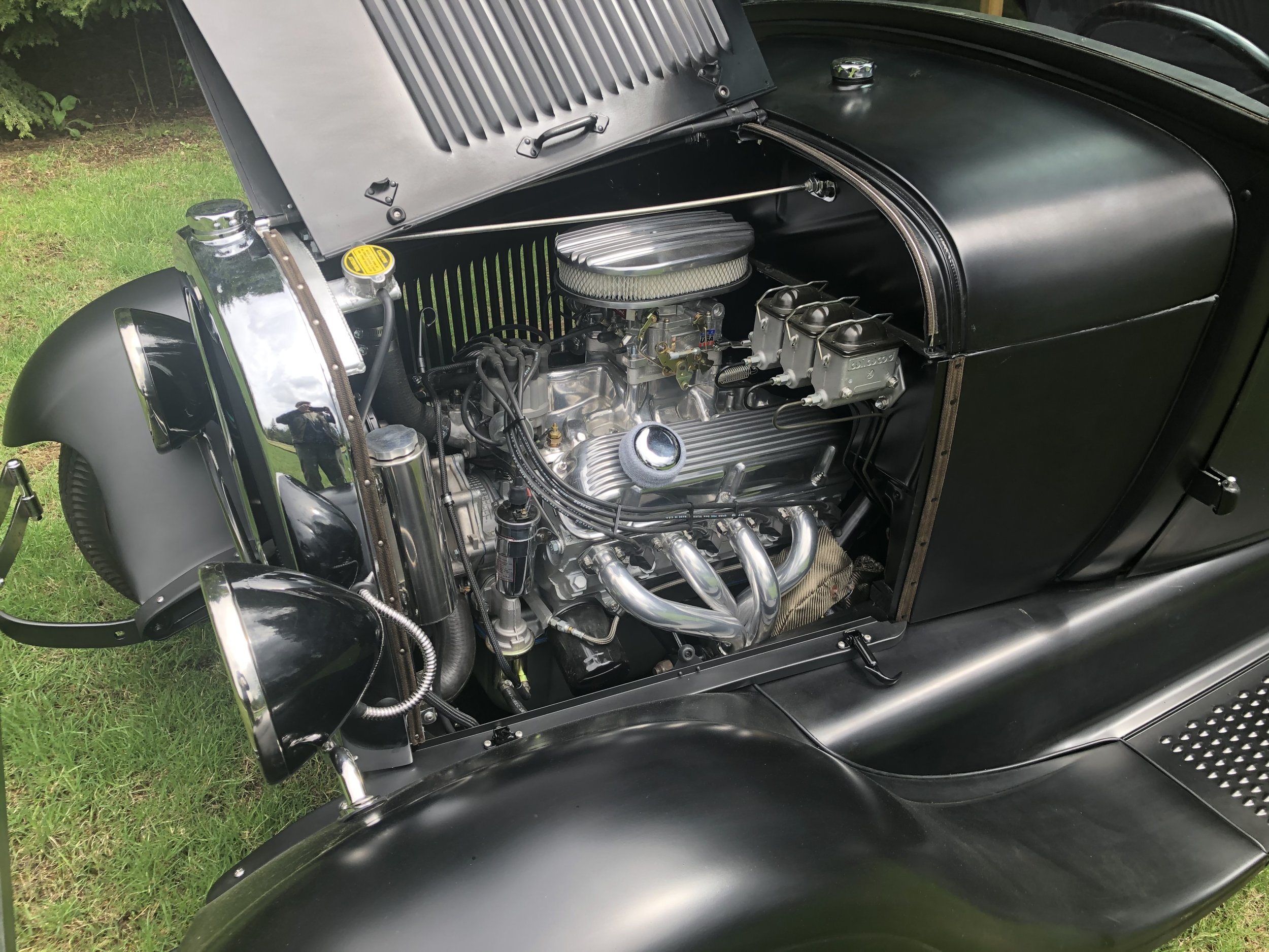

    302 Ford w/toploader, 2 1/2” recess. Interior floor was stock except for small crescent moon shaped section added to the bottom of the toe board
    The 351 “Windsor” is only slightly different than the 302
    A “Cleveland” 351 is definitely a larger combination
    I’ll probably get slammed because my
    engine/truck looks too much like a street rod.
    Whatever…
