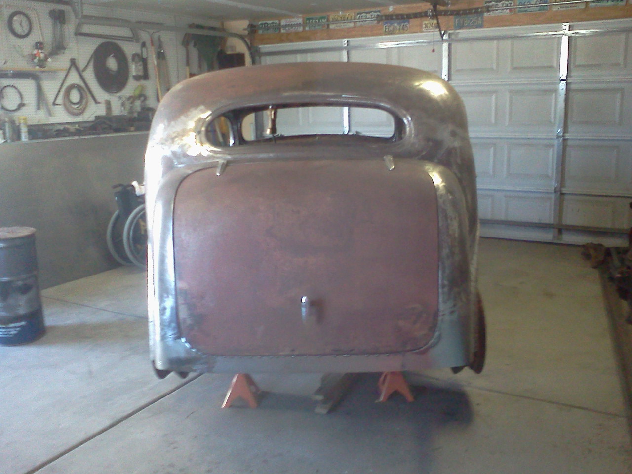

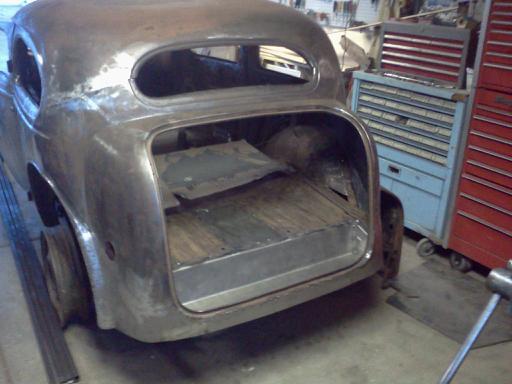

    I had always pictured a set of '50 Pontiac taillights in the trunk lid but the idea of having the lights go up whenever the lid was raised got the best of me.
    I'm sectioning the lid just a little more than the channel to increase the height of panel below. Now I'm thinking of a pair of the same lights on each side, just below the trunk.

    And with a false bottom over the pan in the trunk behind the panel, I'll have easy - but hidden - access to the backs of the tail lights, room for jack stowage, tools, etc.

    Fitting the sectioned lid.
    [The tape arrow is my reminder to self to raise the gas filler hole to make up for the drop from the channel.]

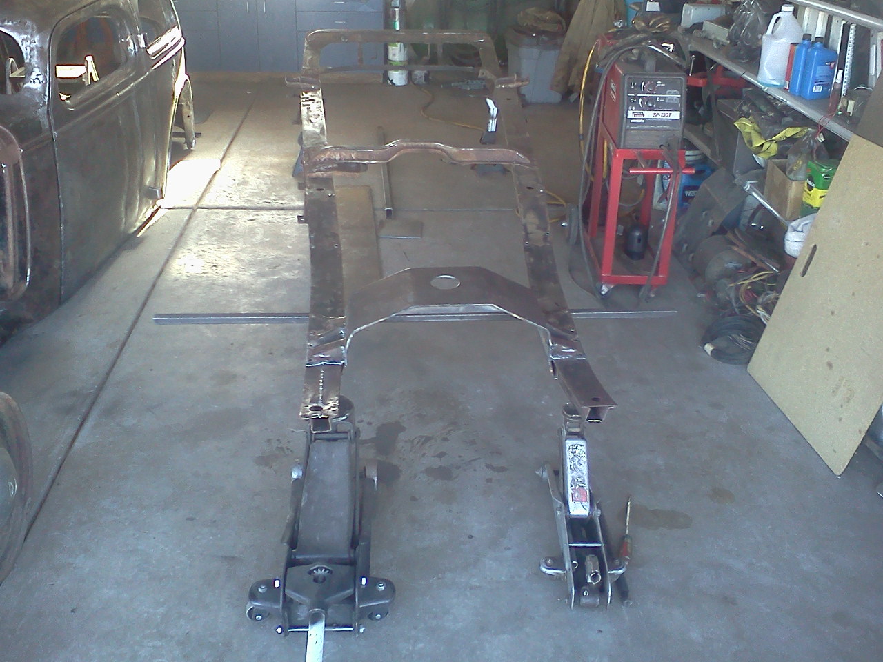

    With that done, I can make a lower, front cross-member that will allow the top of the grill shell to align with the channeled body.
    The box tube between the front rails was welded in place to hold the width before cutting the crossmember loose. The plate behind it is 1/4" with some 1-1/2" box tube behind that. The piece in the very rear is 3/8".
    I took some of the 1/4" x 8-1/2" x 48", heated it at measured distances from the center and bent it to match the original. Then I tacked a "T" to it with some soapstone marks indicating the inside width of the frame rails. This allowed me to make my next set of bends for the drop at equal angles and end-up with something that fit and was centered. All that's needed it to cut the excess to length.

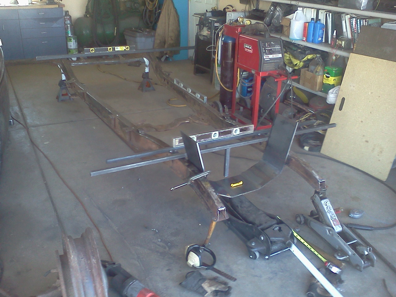

    But before I weld anything solid, I want to make sure:
    • the front of the frame is level
    • the rear of the frame is also level
    • the frame is level front to rear
    • the crossmember is level - side-to-side & front-to-rear
    Then I welded it in along with a piece of the 1-1/2" square box to mimic the original grill shell/radiator mount that allows for the lower radiator hose connection. Then I cut a hole in it to allow for drainage and minimize any ac***ulations.
    I'm now to the point where I've got the whole thing flipped-over and can solidify the cross-piece with a little more box tube.

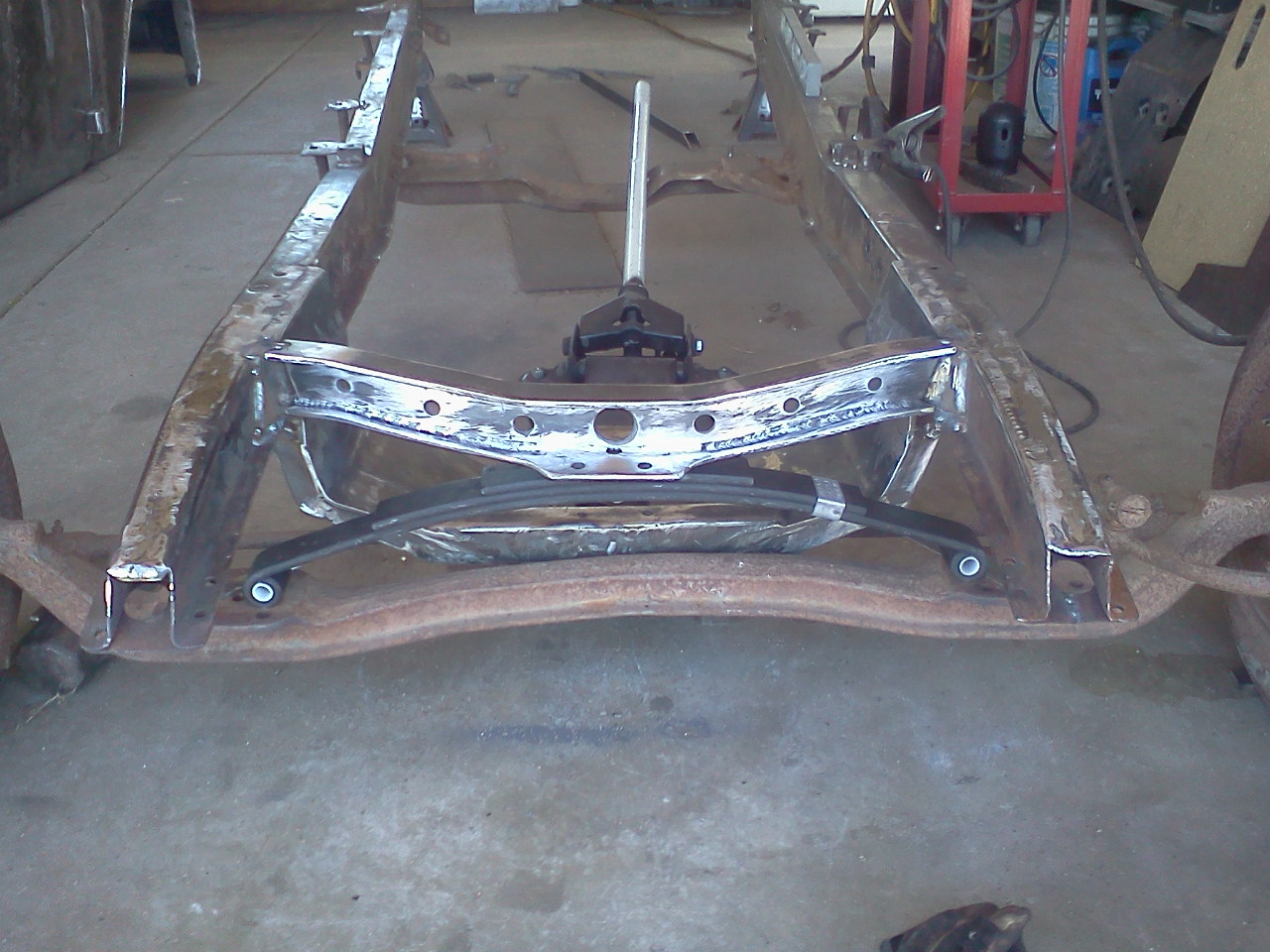

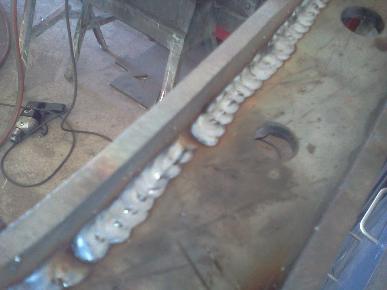

    I reinforced the underside of the crossmember today with some of the 1-1/2" square box.
    I ran the box tube along the sides, but used a strip of 1/4" for the
    very bottom. With the box tube on the top side already, there was no
    need to make hang down it any lower.
    And I flipped it back over and mocked-up the front suspension.

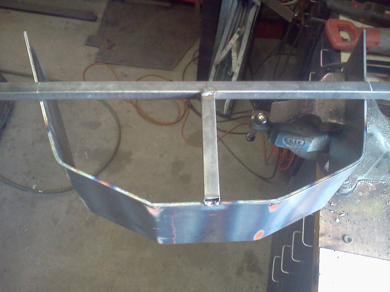

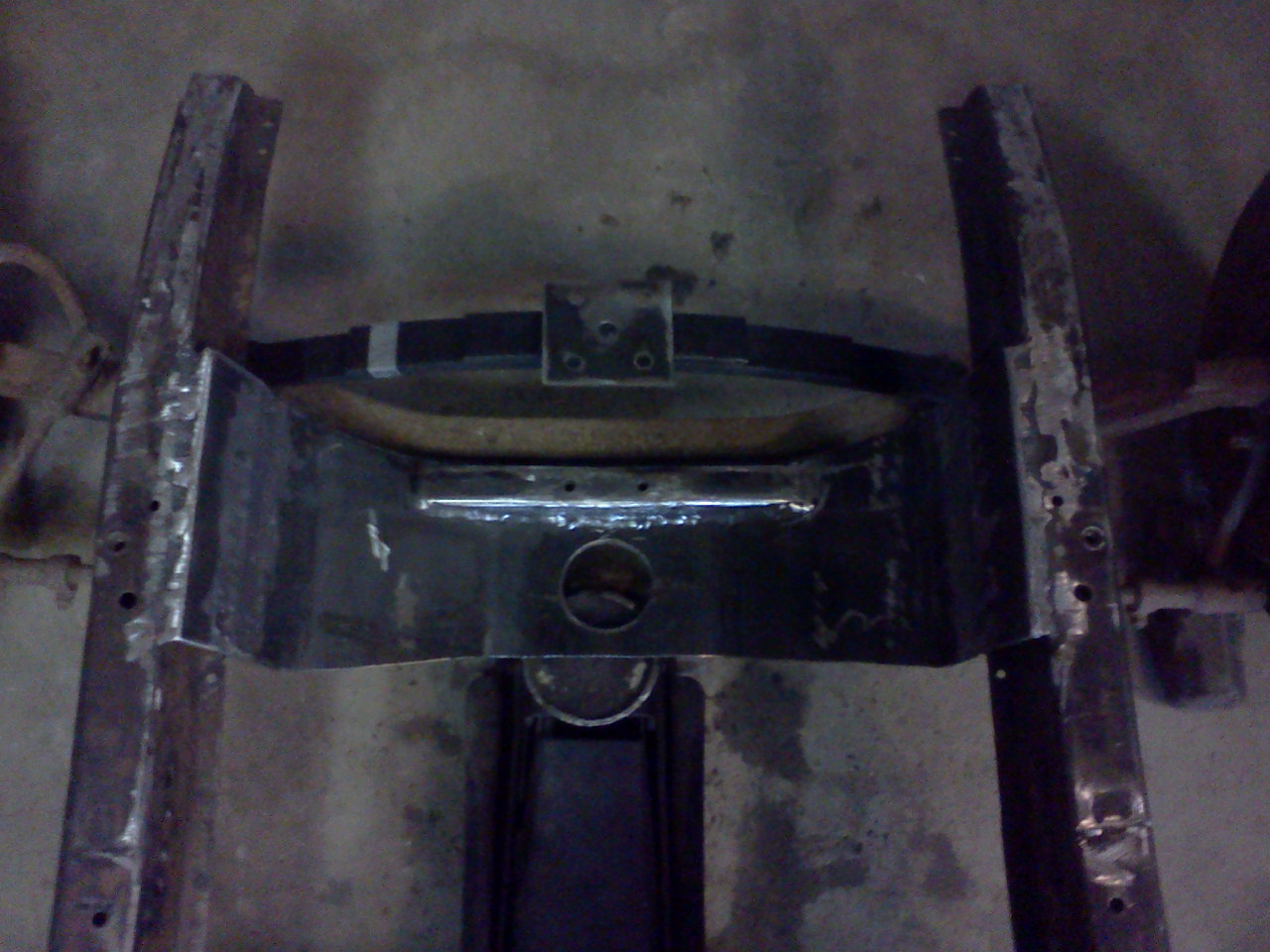

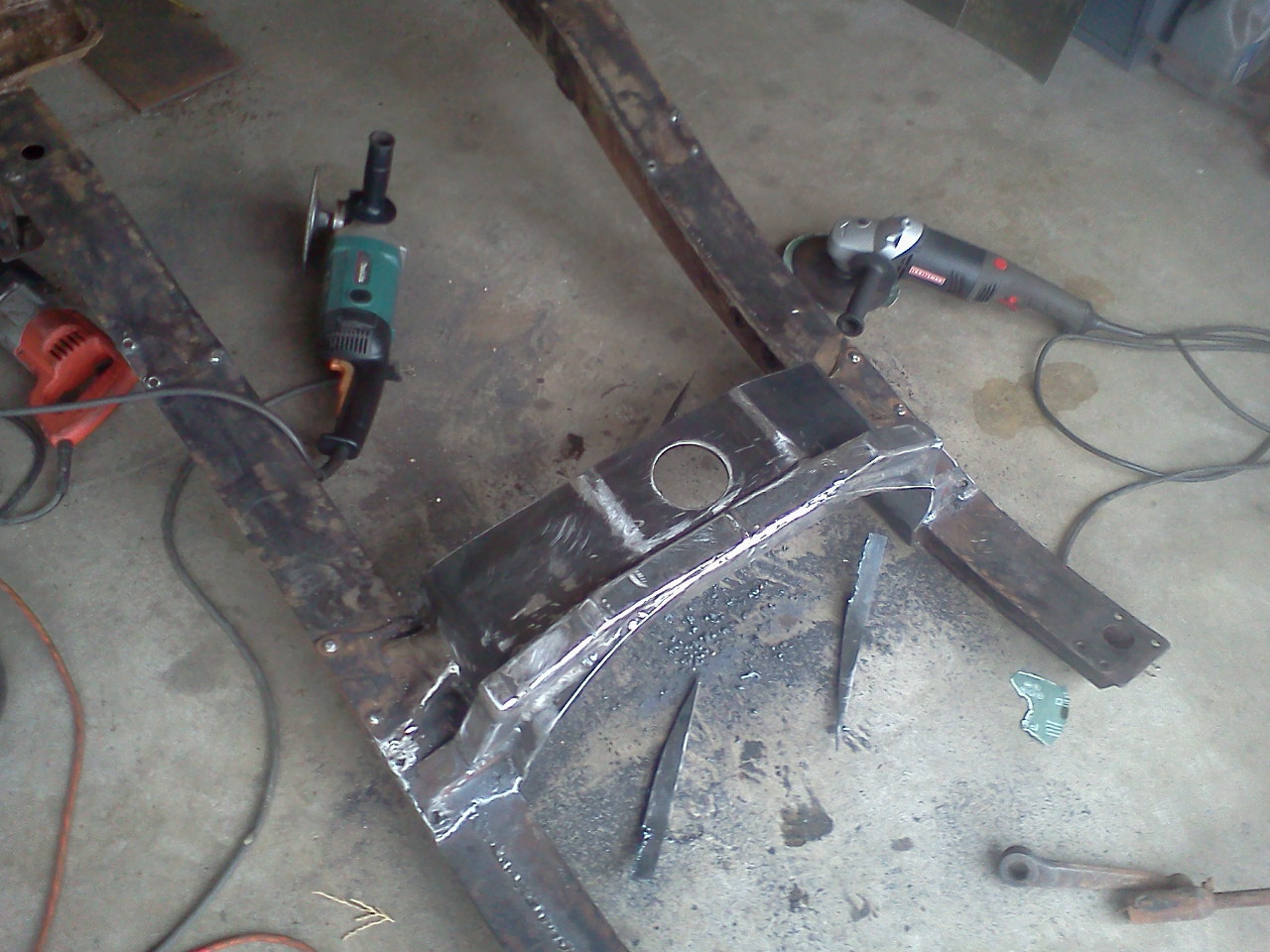

    With the frame upside-down, I cut some of the unnecessary bulk from the front and back of the crossmember. I made a template from some card stock so the curve would be the same on both sides and set after it with the torch and grinder.

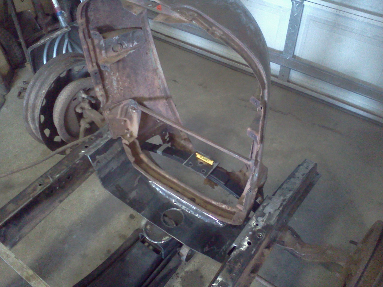

    Cutting the curve in the front not only eliminates some of the bulkiness but since the axle also has that rearward curvature to it, it allowed me to set it back just that little bit more to get the wheel center inline with the grill as viewed from the profile.
    Once I flipped the frame back over and got everything where I wanted it, I placed the mounting bracket I made earlier on top of the spring so I could start taking some measurements.

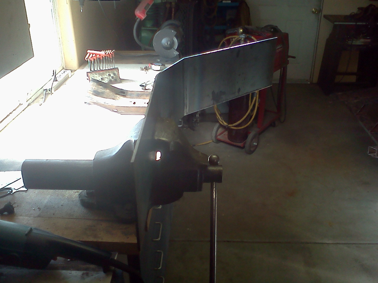

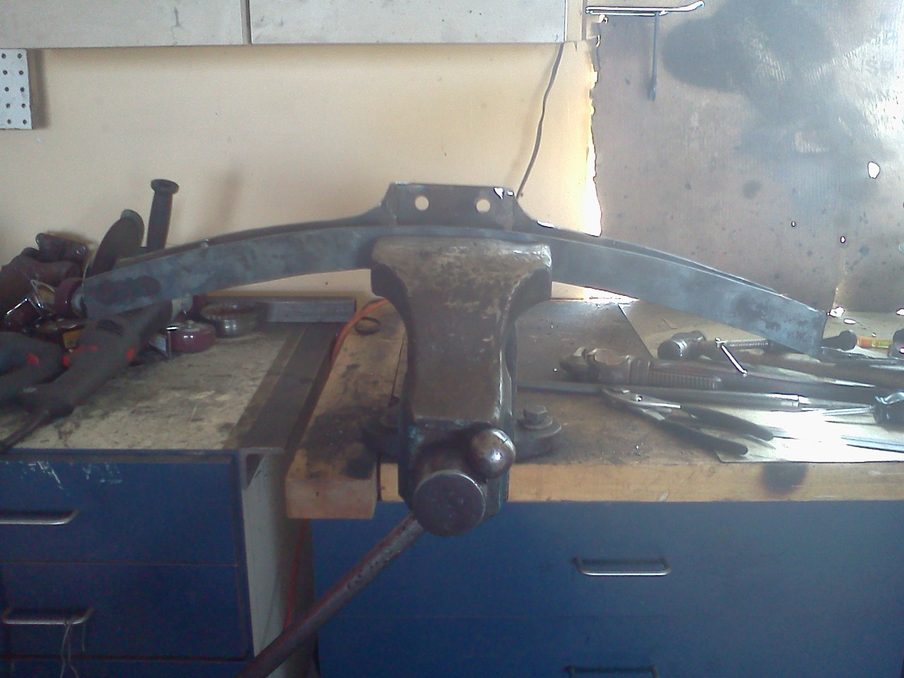

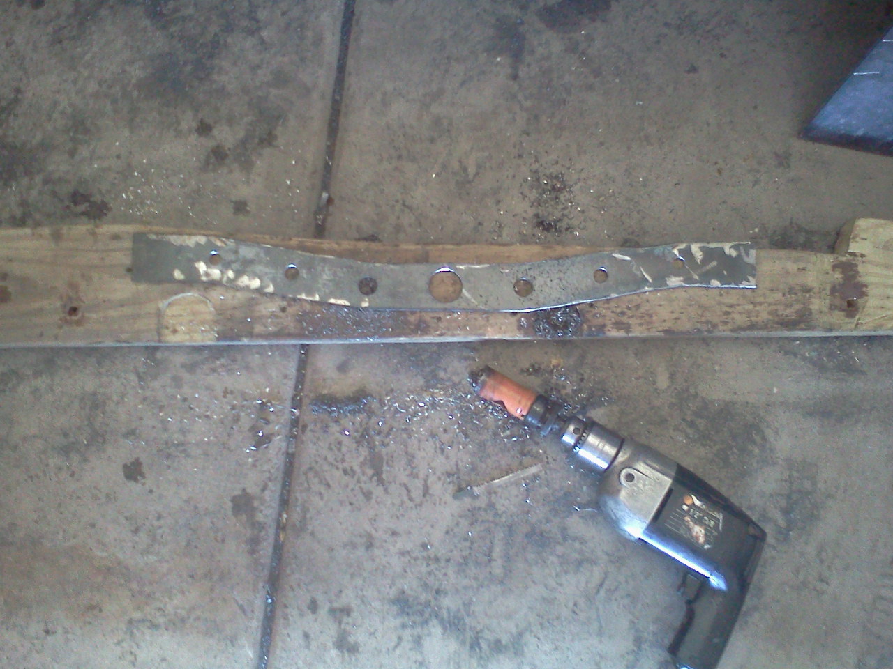

    I know I could’ve welded a piece of square-box tube between the rails and called it good, but what would be the fun in that?
    Instead, I cut a piece of 1/4″ to shape with the right amount of drop to meet the mounting bracket and poked a few holes in it for good measure.
  27. Woob
    Joined: May 11, 2004
    Posts: 353
    Woob
    from Falcon, CO
    Then, by alternating heat from the torch with welding, I was able to bend that face-piece to match the curve of the 1/4" I cut for a top.

    Granted that all of this would have been much easier had I owned a drill press or still had a band saw, but I was raised on the old axiom that “It’s a poor craftsman who blames his tools.”
    It may have taken me longer – much longer – to do it this way, but it got done. :cool:

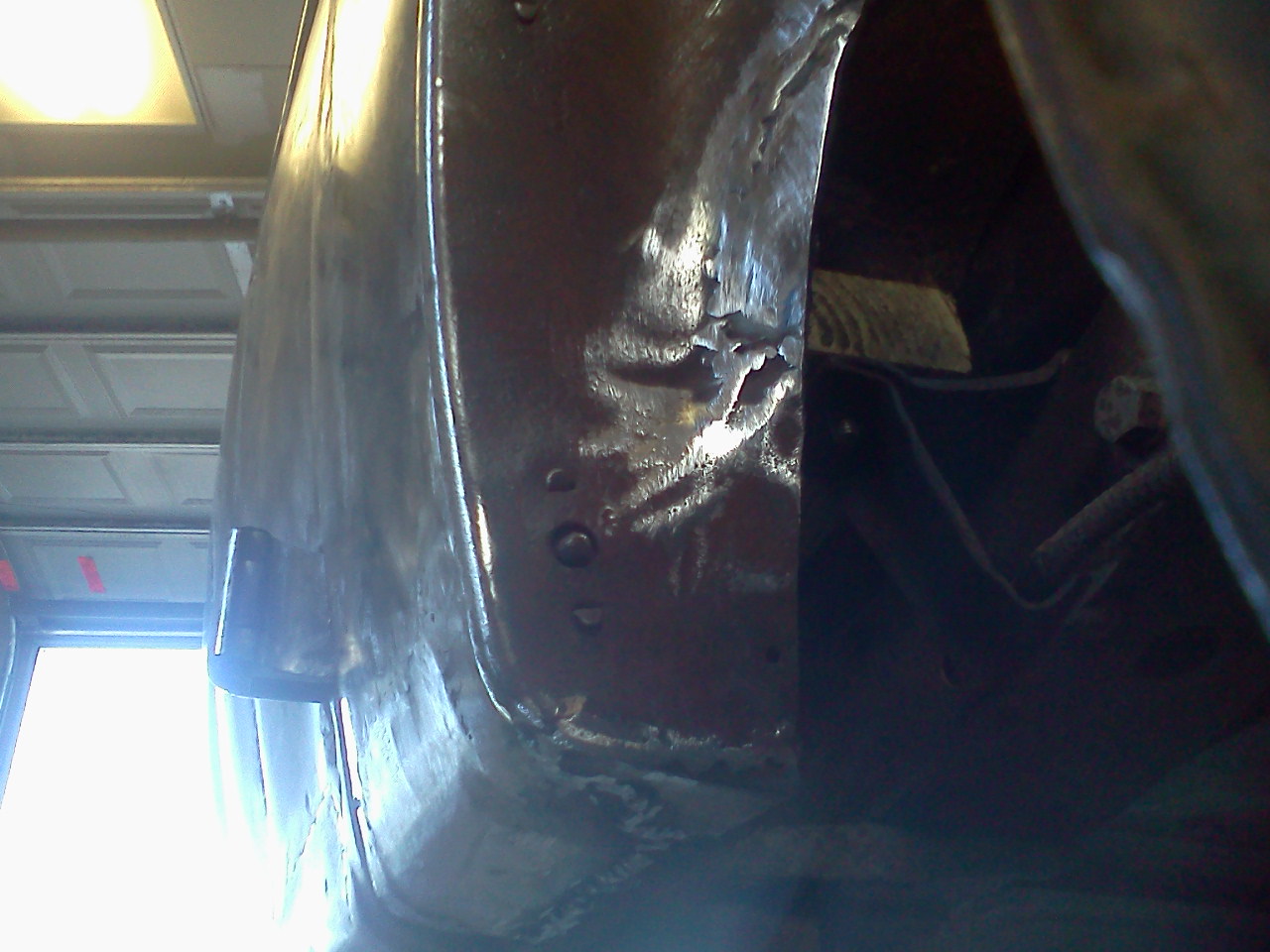

    Try as I might to weld as close to the leaf-spring pin centering hole without messing it up, I noticed a small booger in the hole between 3 & 4 o’clock when I was done.
    Sure enough, it prevented the spring from seating fully on its mount when I tried to test fit everything. I have a small chainsaw sharpening file that would fit, but if you’ve ever tried to hand file a weld with the smallest of hand tools, you’ll know why I say, “Thank God for Albert J. Dremel"
