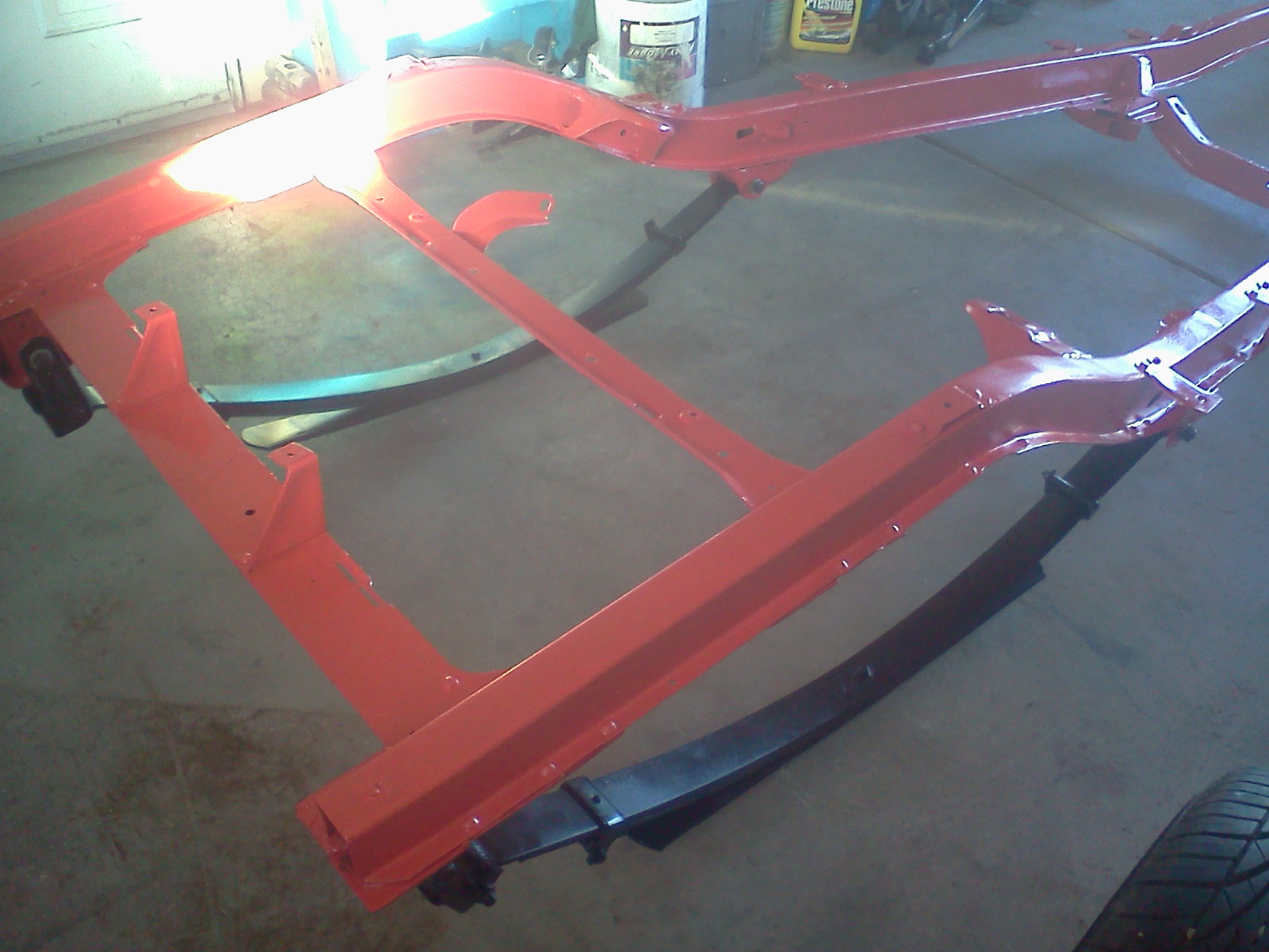

    235 Straight Six & 4 Speed Trans
    10 Bolt Rear
    One front mount for the rear spring cut. One to go:
    Putting it together:
    The frame rails are tapered, front to rear. The mounts have to be parallel, like the leaves. You can't just align the mounts with the rails otherwise they'll be pointing away from one another.
    My son and I snapped a line across the rails at two measured points on the rails. This created a line across each rail that was perpendicular to the leaves and in line with each spring bolt.

    The rear mount from the inside:
    The shocks can't stay here. This space is for the gas tank. They'll get moved over the weekend.
    Rear View:
    and I still have to finish the front:

    The rear shocks are where the gas tank is supposed to go...
    so I swapped the lower brackets left-for-right to move them to the front,
    and welded the upper brackets.
    The upper left bracket already had clearance to allow for plumbing brakes and fuel between the frame and bracket (previous image), so all that was really left was to make an elevated anchor point for the differential vent tube and add the bracket for the connection between the hard plumbing and flexible section of brake line.

    I finished the underside of the motor mounts and it’s no mistake that the cross-piece between the front and rear gussets doesn’t meet the lower portion of the frame rail. The front shocks bolt through the frame right behind these and I’ll need to be able to get a nut and a wrench up through here when that time comes.
    Previously I had picked-up some 7/8″ x .156″ DOM tubing to make a set of front radius rods.
    From here it was a little move to start setting up the front suspension to get the radius-rod mounting brackets properly located. With the frame still upside-down, I transferred a few dimensions from the front axle to a piece of 1″ square-box tube in white chalk. Since the brakes, backing plates, spindles and hubs are still on the front axle, it’s going to be a lot easier to move this piece of tubing around in small increments than it would be to use the real deal. “Easier” doesn’t necessarily translate into “better” but it does mean I don’t have to go through an undue fight to get an accurate placement.
    I knew I wanted the bracket to go in the same location as the old spring hanger. The frame already kicks-up here because of the original suspension, so there’s already plenty of clearance for freedom of movement, but the bracket won’t hang down unnecessarily and cause ground-clearance issues. The original spring hangers were cast-iron and riveted in place. Having removed them, the first order of business was to reinforce the frame in the same locations with 1/4″ plate.

    The rear of the frame is still up on the jack but the wooden blocks are no longer needed under the differential. It’s pointing in the right direction on its own. I’ll pull the whole ***embly out on my next set of days off to finish welding the perches before bolting it back where it belongs.
    The front is all bolted-up to the spring and supporting its own weight.
