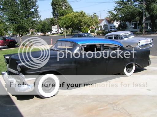

    Markanthony is right.. i did mine myself .. and i studied, asked alot of questions, and just stared at my car for hours... I didnt know any body work, or even knoew how to weld.. but If other guys can do it SO CAN YOU... peace and chicken grease
    here is mine with the back doors welded shut..
    and here is a 4 door with the back doors welded shut hardtop
    and here is mine as i welded my back doors shut.. if you noticed i could have still had a 4 door chopped top

    Heres a picture of my fiances 56 he did. Its not done, but getting there...

    This thing left my garage yesterday.
  18. NortonG
    Joined: Dec 26, 2003
    Posts: 2,117
    NortonG
    Kartsa, thats amazing! I dig that car. Any more details about it?

  21. GREAT work Kartsa....[as can be expected in your case!]
    That ought to show the rest of us ,just what some P***ION and a little shortage of the "right" car, can result in,when mixed properly....
  22. Kartsa...wow, your the man ! Proportions are great in this side view, another great Kartsa chop see the light of day.

    Yes,I have more pics of the conversion and chop.Anyone know how I can resice multiple pics.I think it can be done with IrfanView.But how?I try to upload some pics today.
