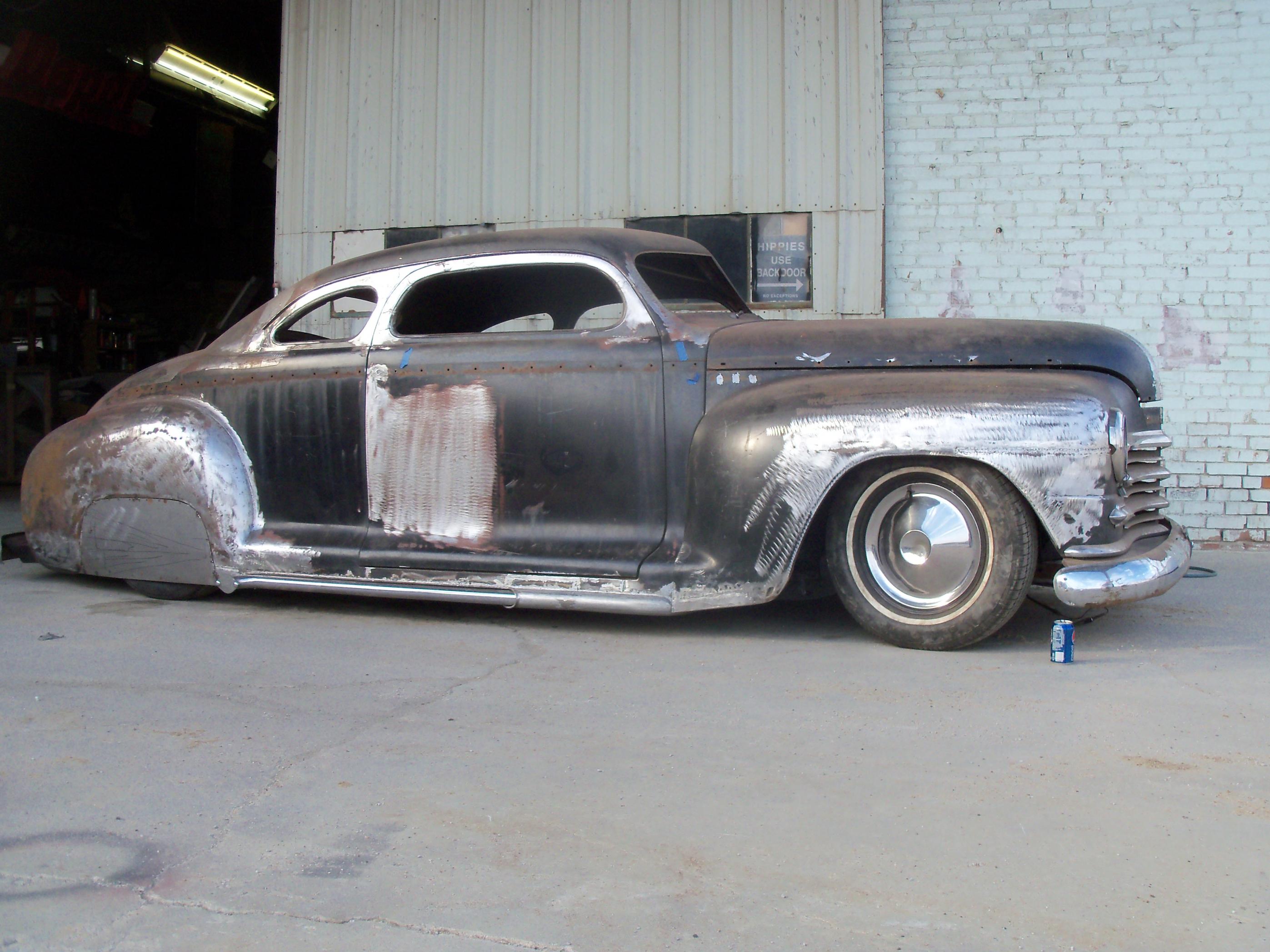

  1. rear fenders were bolted to body with welting in between , i cut off bolt flange and welded fender to body, then will lead all the welded seams , just in case there are pinholes i missed , dont want moisture to transfer to underside of paint , i use a 100 watt light bulb to shine behind the welds to check for pinholes but rather be safe than sorry later on
    after car body mods are done and all the welding is done pulling body off again and throwing on a rotisserie and having it sandblasted inside and out then shot in sealer then will undercoat the entire bottom before putting back on frame for the last time

    You're creating one beautiful car. Great flowing lines! Did you experience any problems when you welded the fenders? I'd like to do the same on mine.
  6. not really , i removed the fender and welded in the bolt holes in the body and then took a cutoff wheel and cutoff the bolt flange leaving about a 1/16 th of the edge of the flange on to keep the fender rigid and then lined up the gap and tacked the entire fender on , then i started welding seam together with short tacks starting at front side and worked to rear continuously , was not to concerned with warpage because i was going pretty fast and it was right there at the doubled up seam . checked it as i was going along and tapped fender down when needed to align seams then i shined a 100 watt light bulb underneath to check for pinholes and spot welded them , no problems at all when i got done

  10. progress , patched holes and rust on p***enger side , finished molding in lake pipes , radiused the rear window , , started making the framework for the fender skirt . lowered the rear fender 4 inches after welding it in ,
  11. progress , peaked the hood with 1/4 round bar , removed front fender side trim and welded fender seam , shaved the door handles and lock hole , shaved all emblems , and tail lights , started to mock up the rear , going to use kaiser bumper guard on bumper will have to grind to fit undecided on tail lights

  19. today i skinned the fender skirt after i shaped it a little bit on the english wheel , deciding on how to mount them , thinking about pins on top and maybe some hasp latches on either side of the inside

  21. long weekend welding tackled drivers side , patched holes in inner fender and welded fender to body , extended fender bottoms lower , patched rusted out rocker , molded in lakepipes , not bad for two days
  22. extended rear bumper lower and fabbed up some brackets for mounting
  23. side views
  24. lastly me standing next to car to show how low it is , for some reason i look like a crazed idiot in this picture!!

  27. rounded the p***enger side door top flows pretty well , looks factory , trying to get rid of the few sharp corners of the car
  28. pushed car out into the sun today to get a better look at it
  29. first all aired down , 2nd front aired up fully, crazy lift height ! 3rd rear bumper laying on the ground
