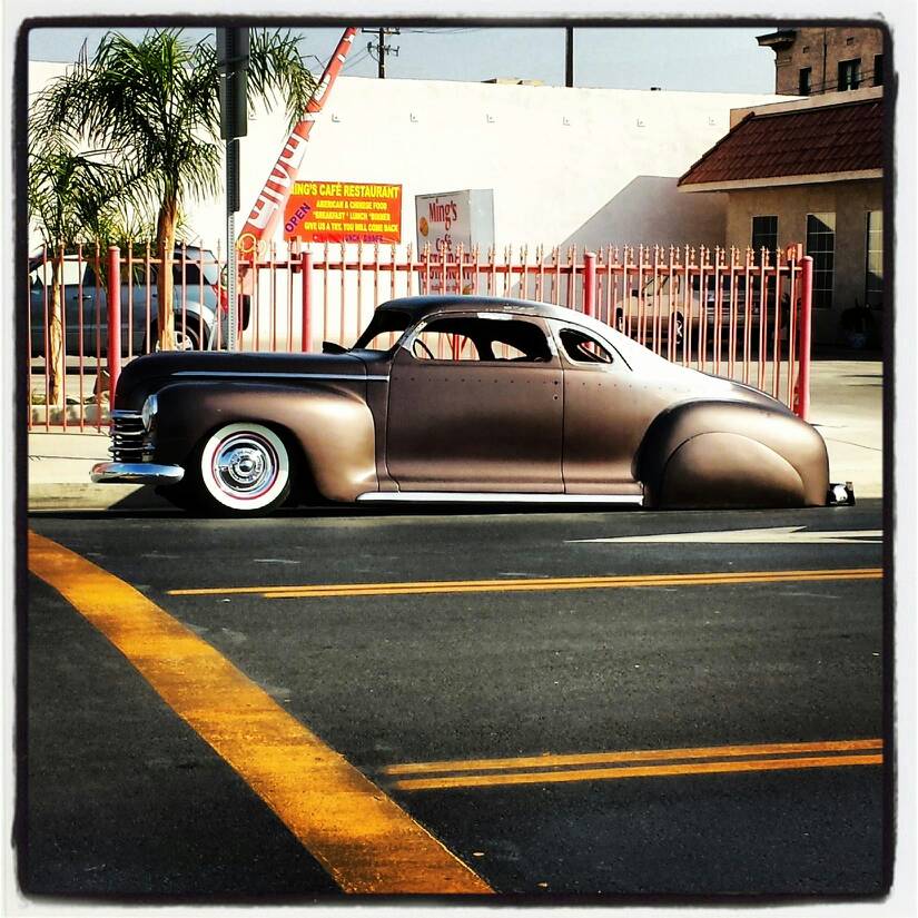

    Something like this? It's a 41 coupe but it has the flow you mean I think.

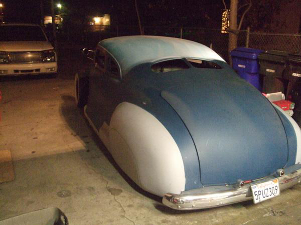

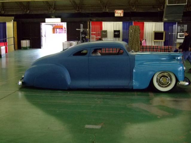

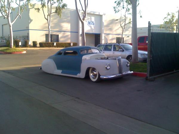

  9. I think he is talking like this.

    farmer- that's exactly what im looking for a lot of em are chopped but that hump is there and I like how yours flows into the trunk.

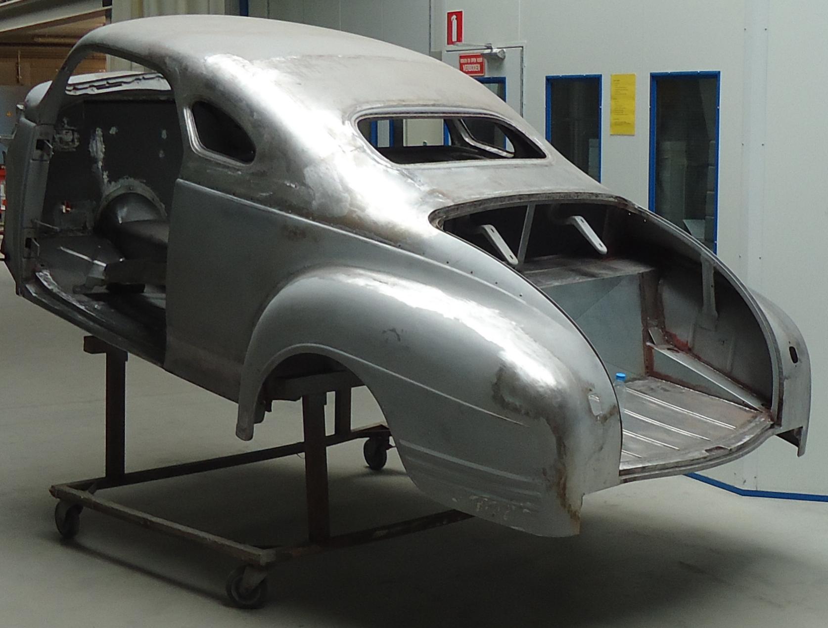

    rod- that's the car ive been looking at for refrence try to see how he cut.thats a 47 I believe.
  12. 46-48 are the same. If you look at the 41 it has a reverse curve under the window, as soon as you cut you will see where you need to do the curve to make it blend into the trunk, the sides are the trouble parts lots going on there! Our 47 is halfway through the chop and i need to get back on it, spent a lot of time getting the back just right so it flows. Got 4 projects going on at the same time got to stop that crap!

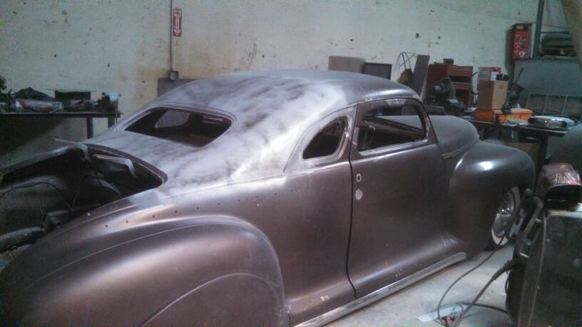

    Some pics of the chop guys thanks for help there's plenty more in my profile and rodhots as soon as I moved the roof I learned what a reverse curve is. Chopped it 3" and set the back were it looked right to me roughly 4"
