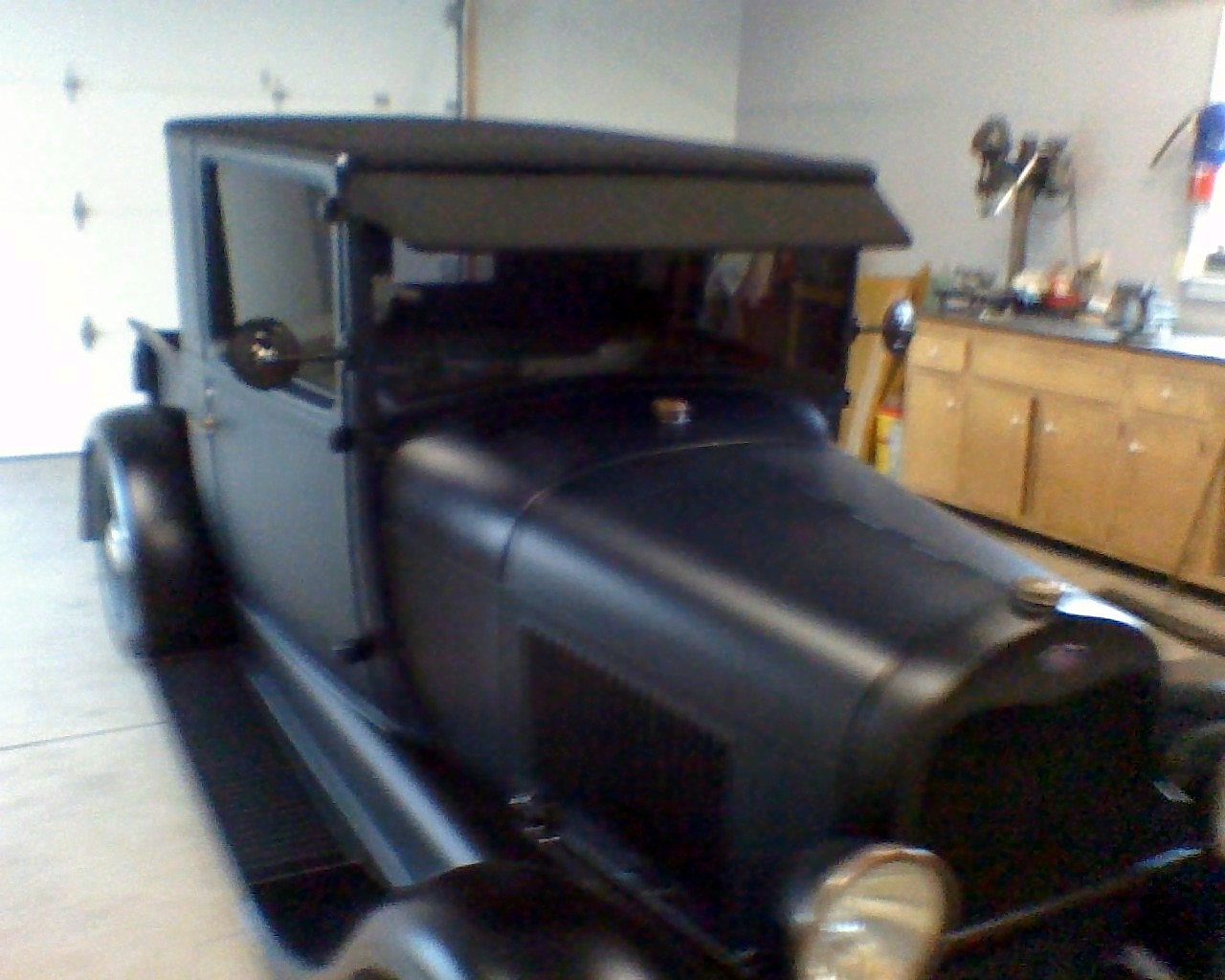

  1. 20241115_110841.jpg Screenshot_20241212_140710_YouTube.jpg ok hambers it's been decided I want a mild chop like the green truck In the pic has, I'm thinking of doing it about the windshield and adding a 28-29 car visor instead of the big pickup/truck visor, I'd like to make all my cuts around the gl*** in order to keep stock windshield and rear window, do you guys have any insight on Chopping one of these things?

    I don't think most around here would consider what you've posted as an example a "mild chop". It also doesn't fit your description of what you want to do with stock windshield height.

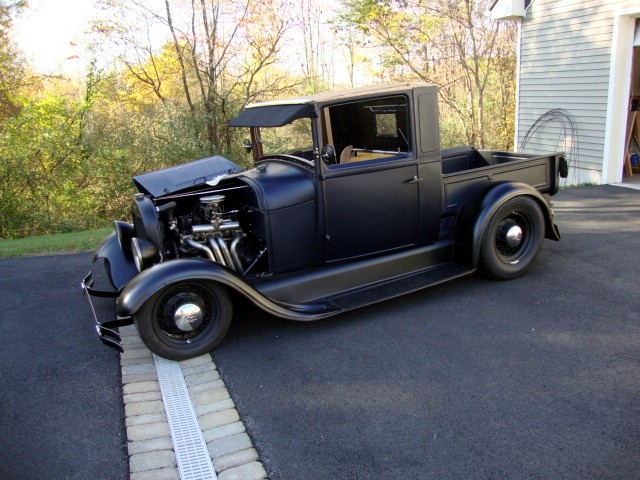

    The truck below, posted on one of your other threads, has about the chop you're describing.
    The build thread kind of describes what was done to the roof. https://www.jalopyjournal.com/forum...y-suede-can’t-get-no-lovin’-this-year.377527/
    More photos/info here after it was completed:
    https://theamazoeffect.blogspot.com/2012/11/1929-ford-model-truck-marine-rod-ology.html?m=1
    https://www.hotrod.com/features/hrxp-1203-1929-ford-truck-living-art/

    here's a few more of that pickup, the chop is midway of the middle and upper door hinges , you will have to cut the windshield, door gl*** and rear window , no way around that, yet being it's flat gl*** there's not much of a issue

    Why rear window? Looks stock size?

    Man, that thing is perfect in my eyes. Well done.
