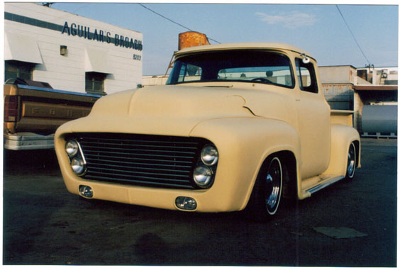

  18. If you decide to have someone chop your truck you give my buddy a call at the Drag-N-Shop-Joseph Garcia. I know this is'nt a 5 window Chevy but I posted it to show you what he is capable of, this truck has a 2 1/2" chop. If you need design ideas his younger brother 'D.A. Designs'-David Garcia is the man to see. His work will blow your mind. Hope this helps get you closer to rolling in a cool kustom truck. :cool:
