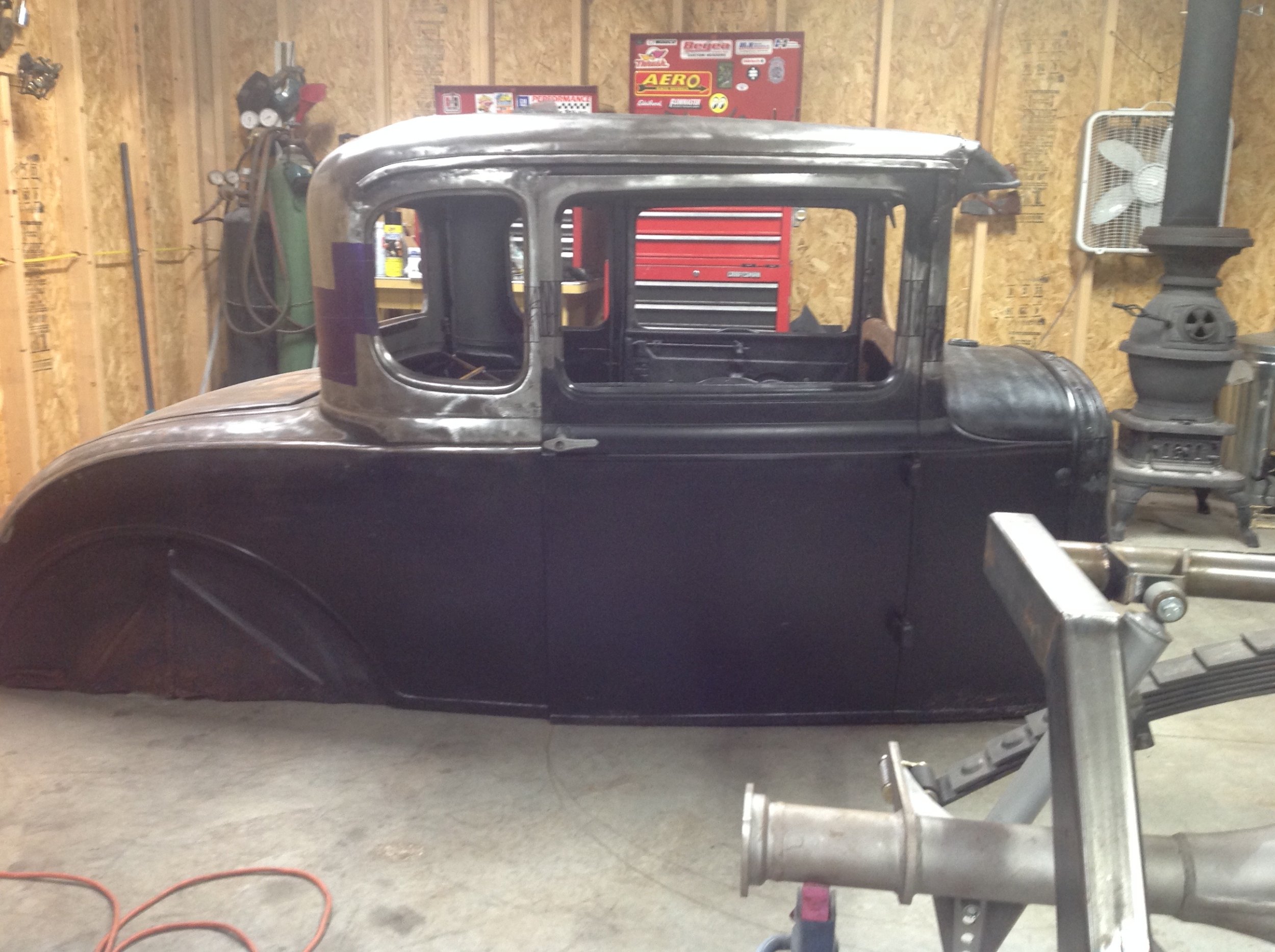

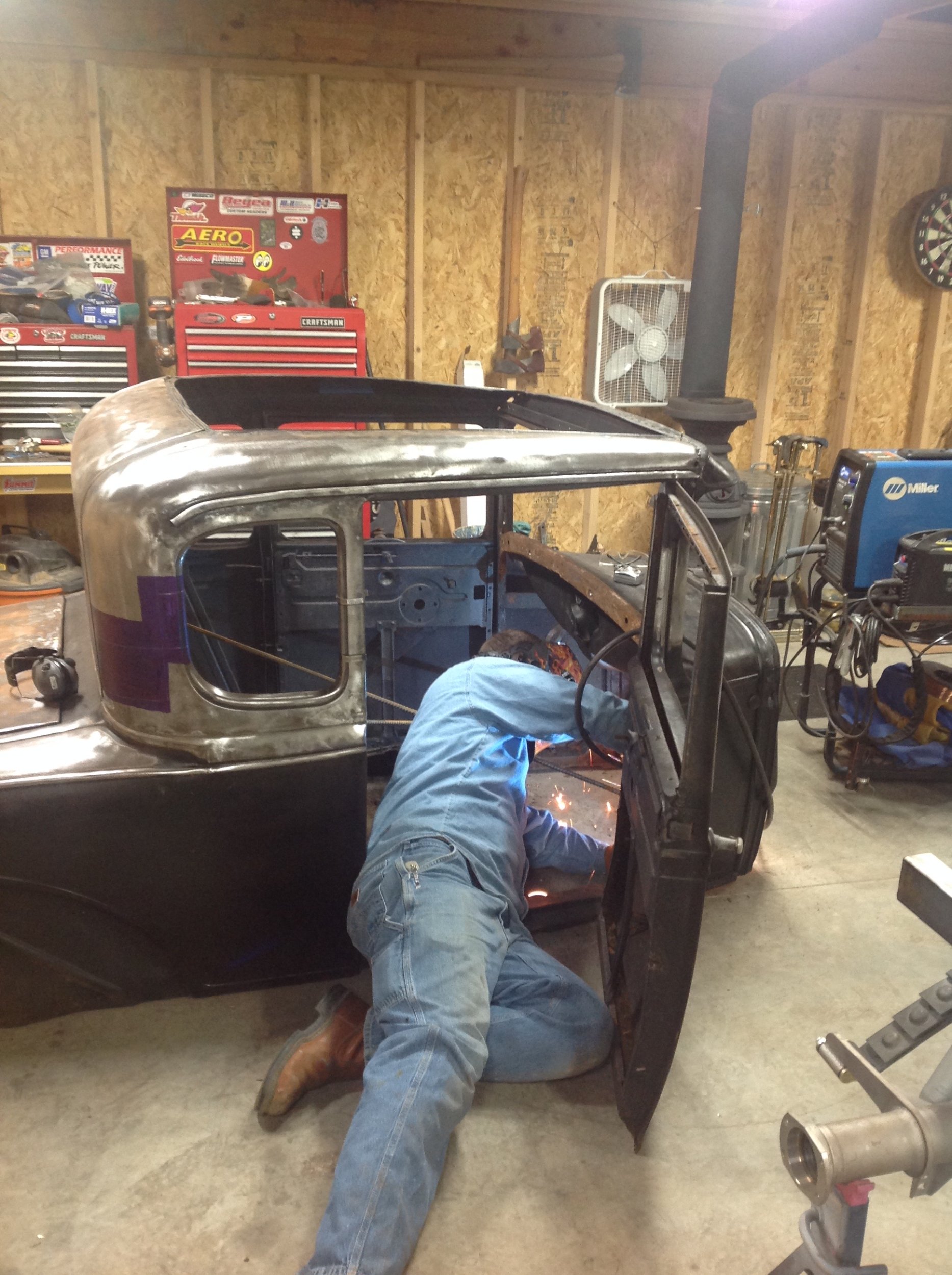

    my 17 year old son and his buddy chopped his coupe 10458670_10153490970434917_7463761190270923109_n.jpg

    Most pieces are cut and drop . The windshield and front door pots require some spreading to match the parts . But nothing you can not handle at home . When welding tack and move around , warping it up will kill a beautiful chop . If you were near I’d gladly lend a hand and TIG welding skills for a hand shake .

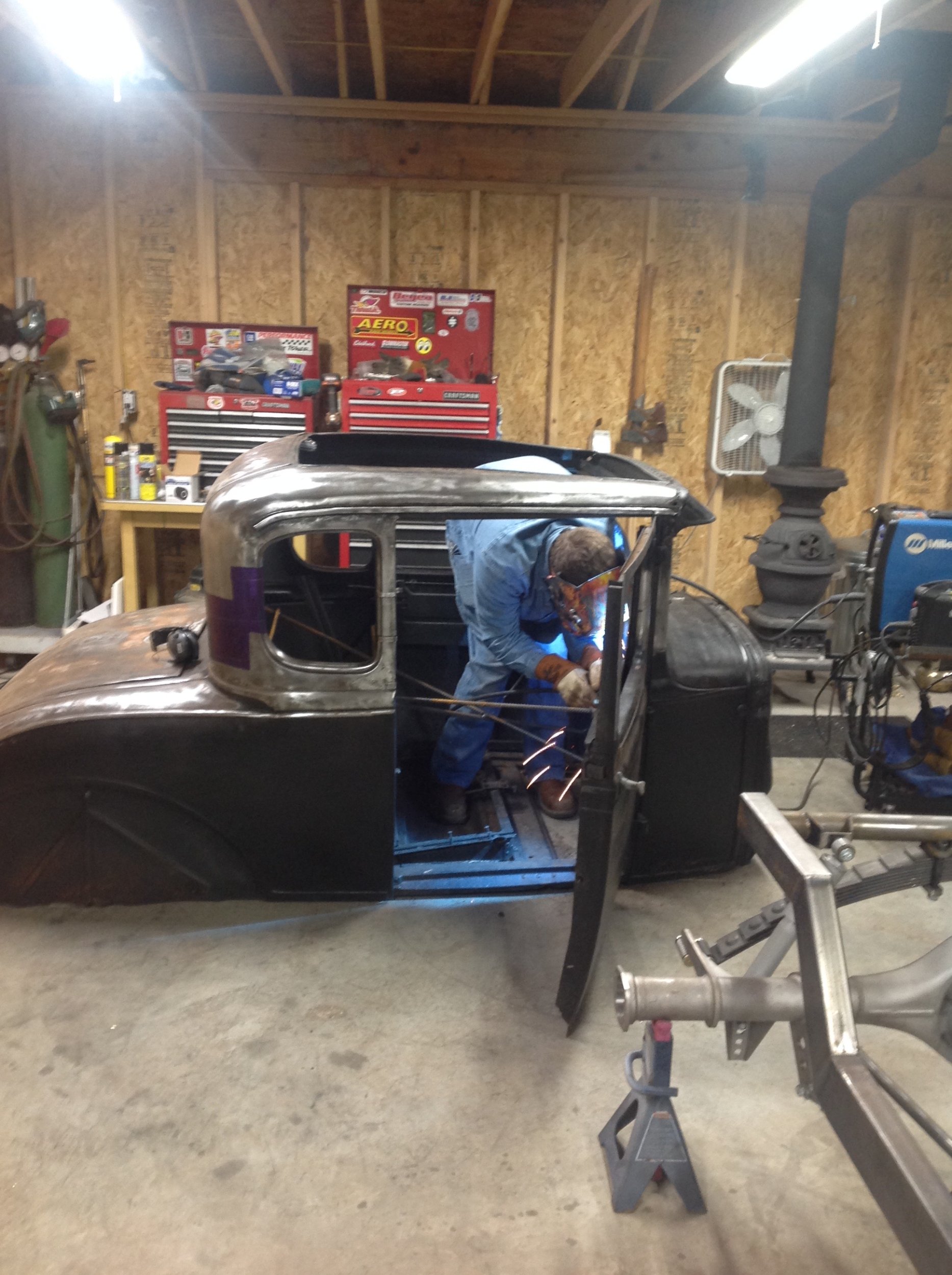

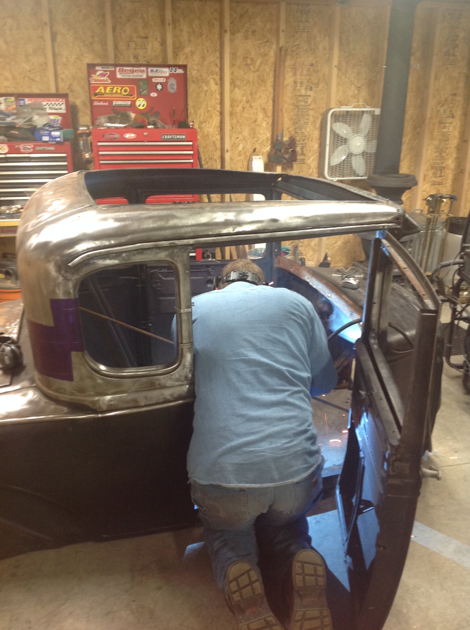

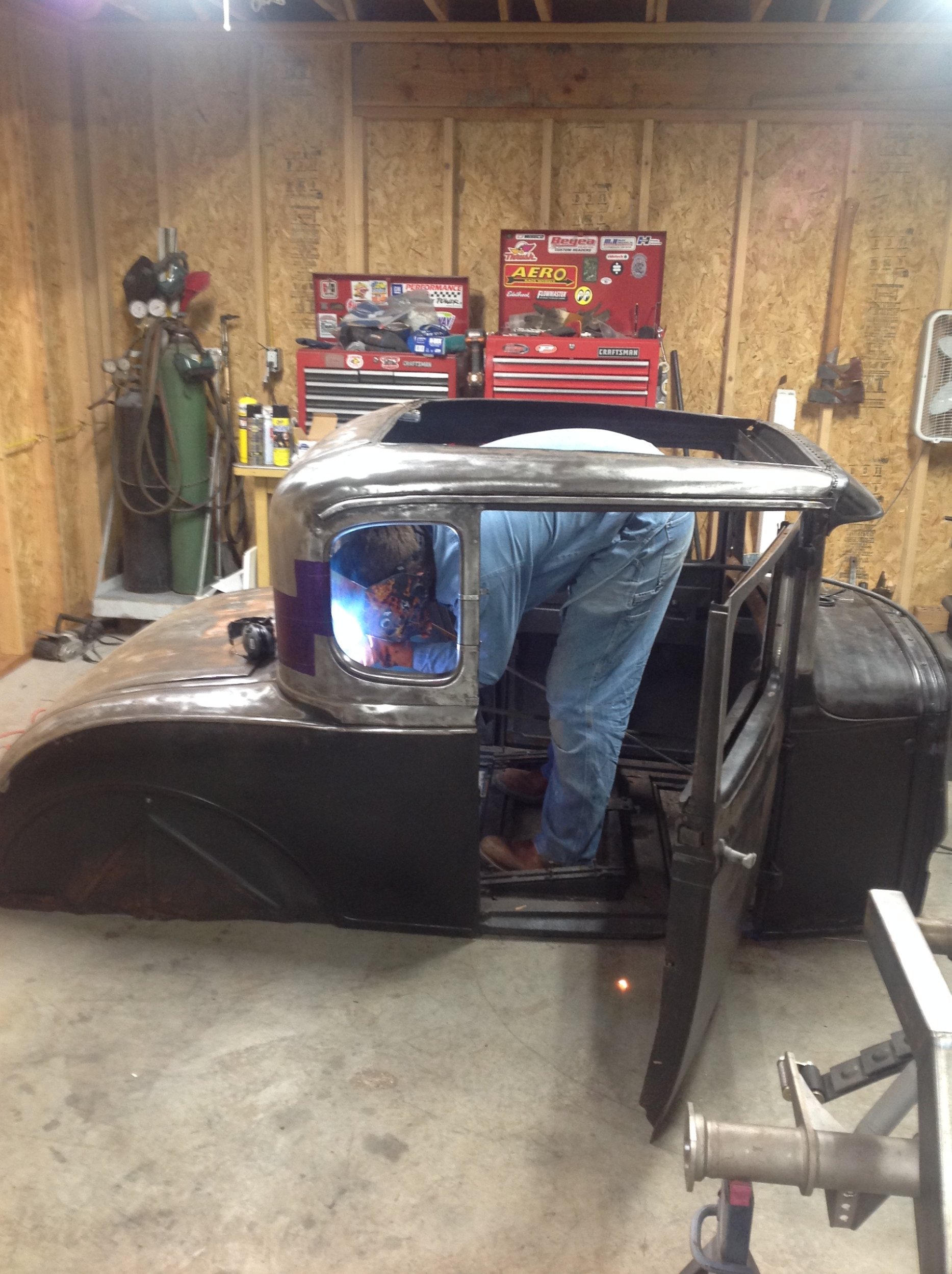

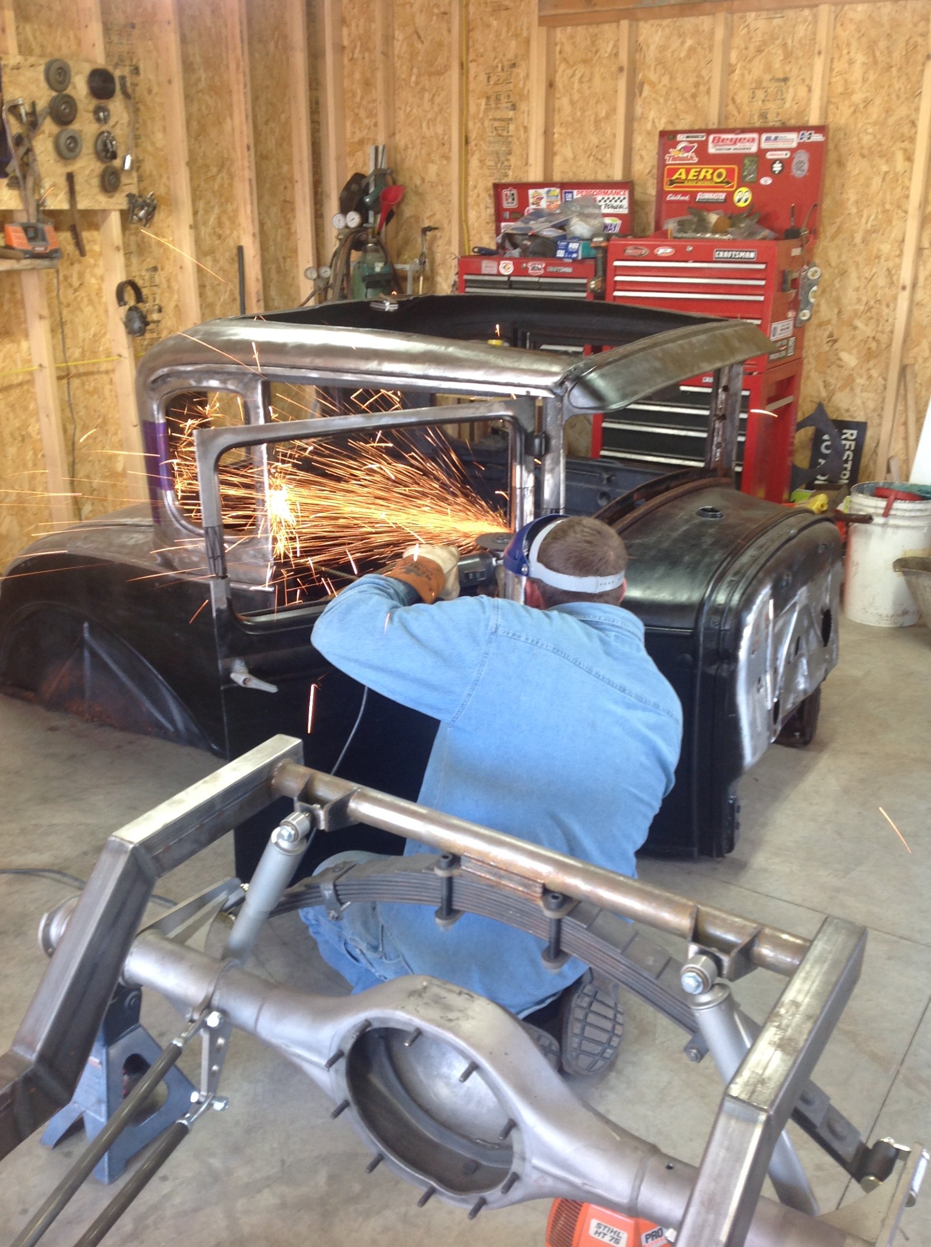

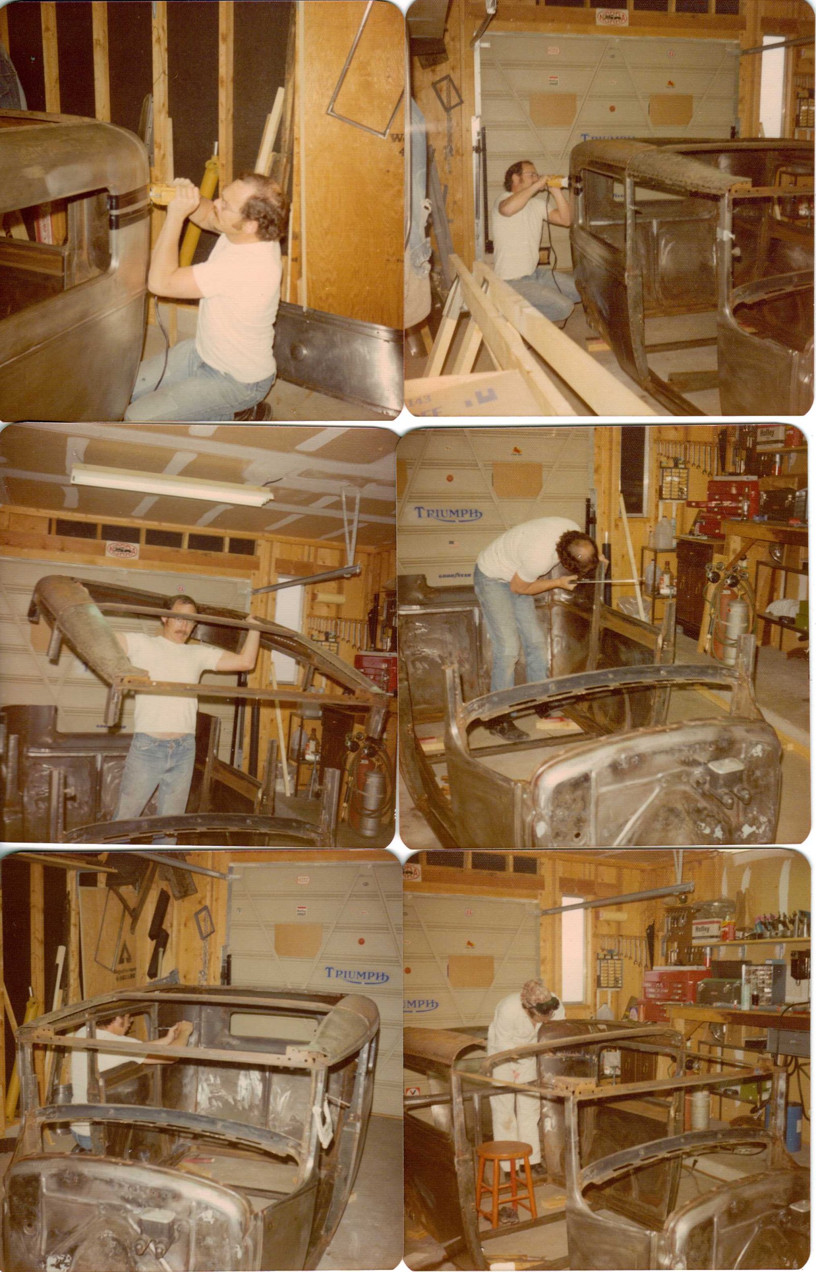

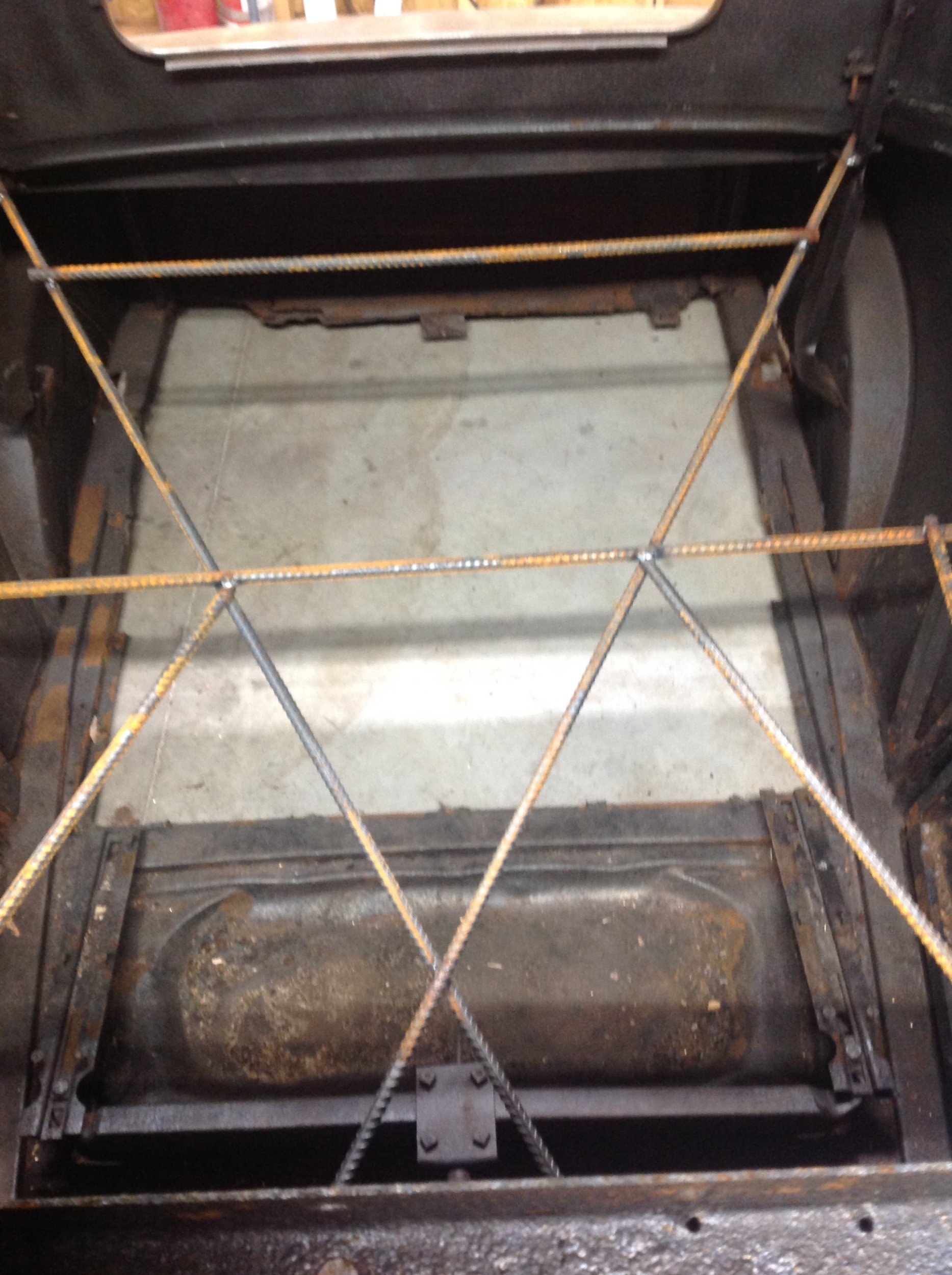

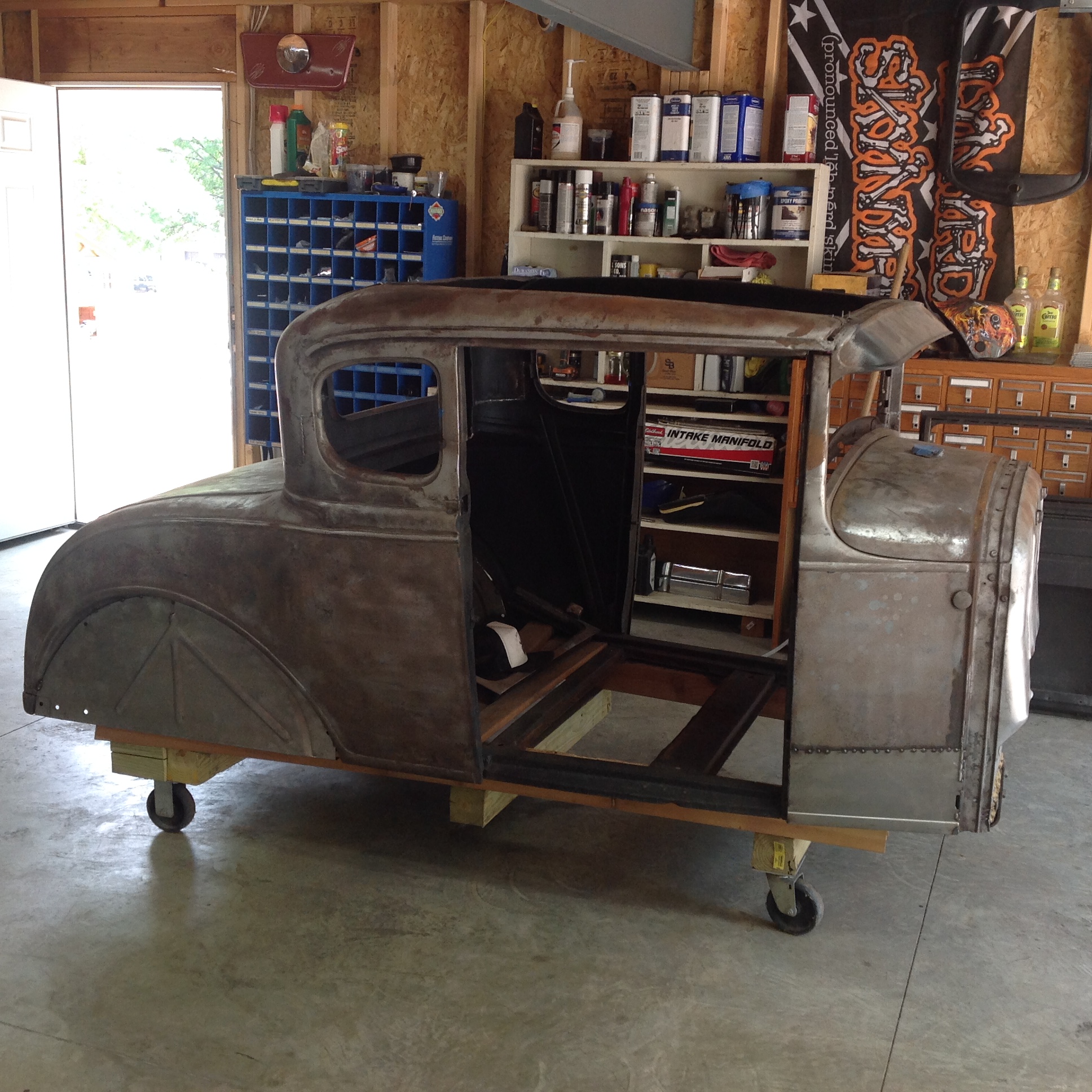

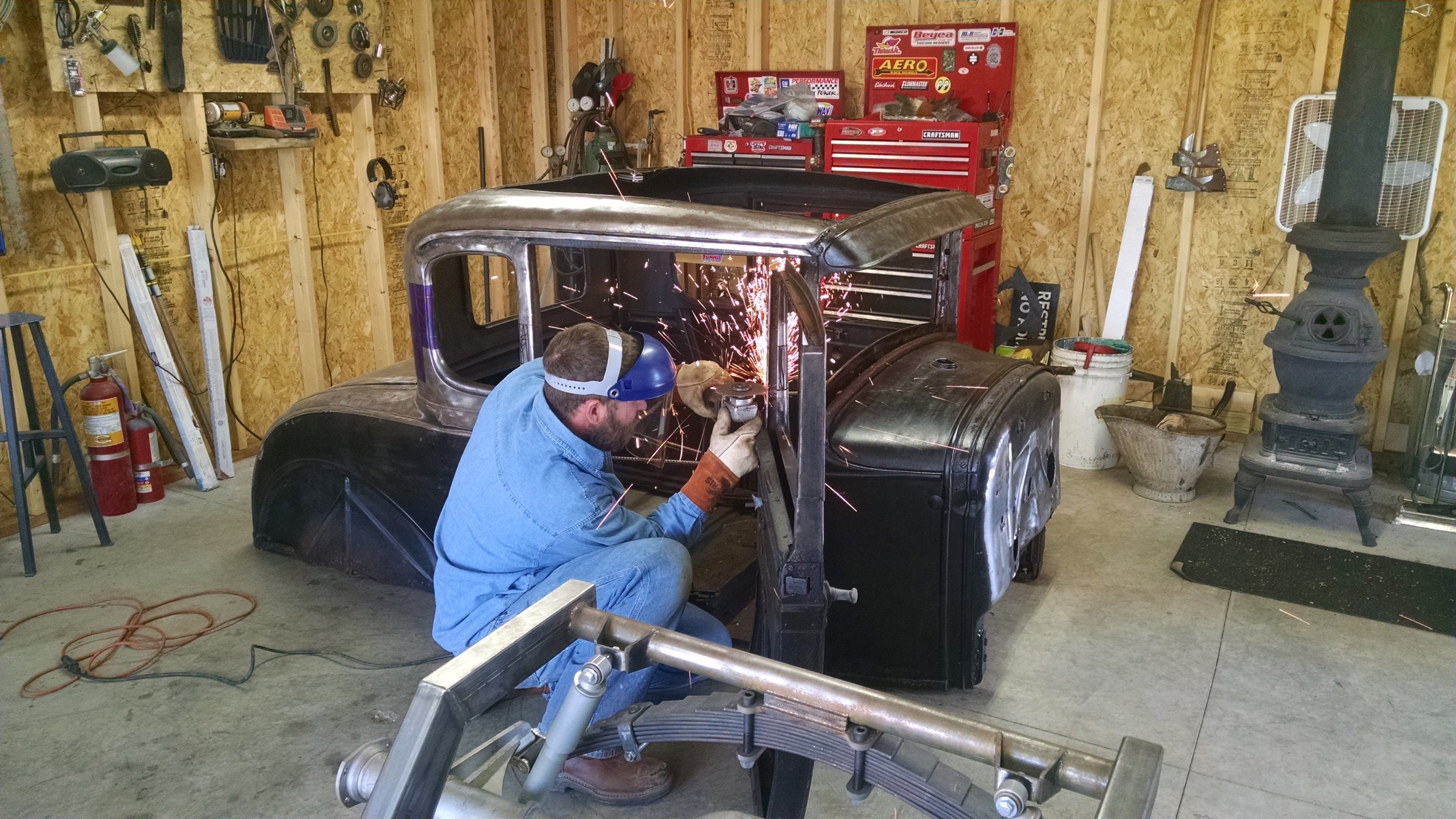

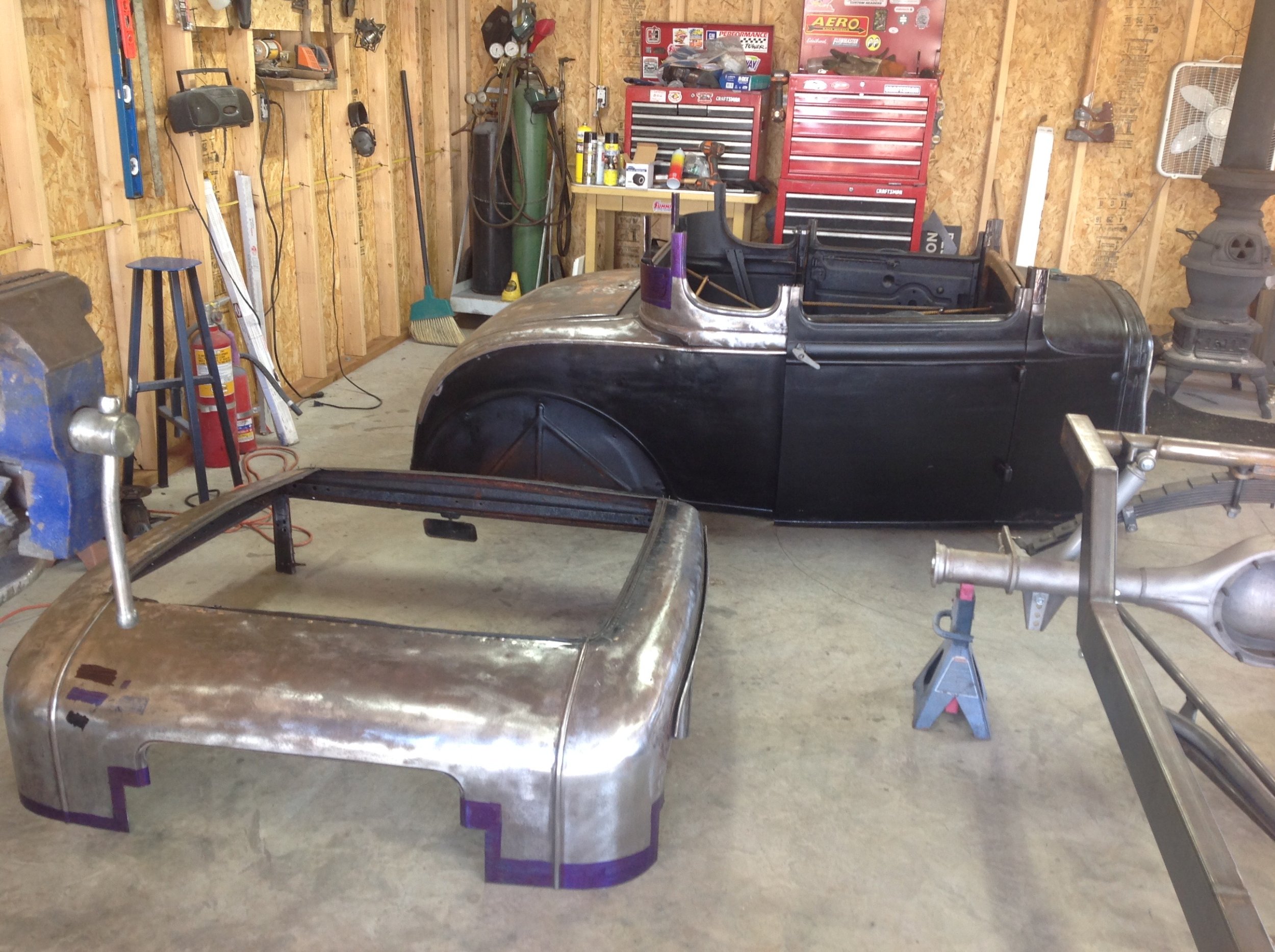

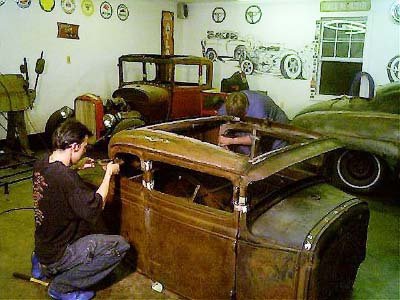

    My son did ours after researching the HAMB and else were. Plenty of bracing inside the body as well as bolting it to a home built dolly. The area between quarter gl*** and rear window was cut offset to minimize the mail slot look. He used a permanent marker to define the areas to be cut and scribed the cut lines. Use a cutoff wheel and took his time. See photos. IMG_0114.jpeg IMG_0107.jpeg IMG_0111.jpeg IMG_0110.jpeg IMG_0104.jpeg IMG_0006.jpeg IMG_0115.jpeg IMG_0116.jpeg IMG_0175.jpeg IMG_0550.jpeg IMG_0119.jpeg

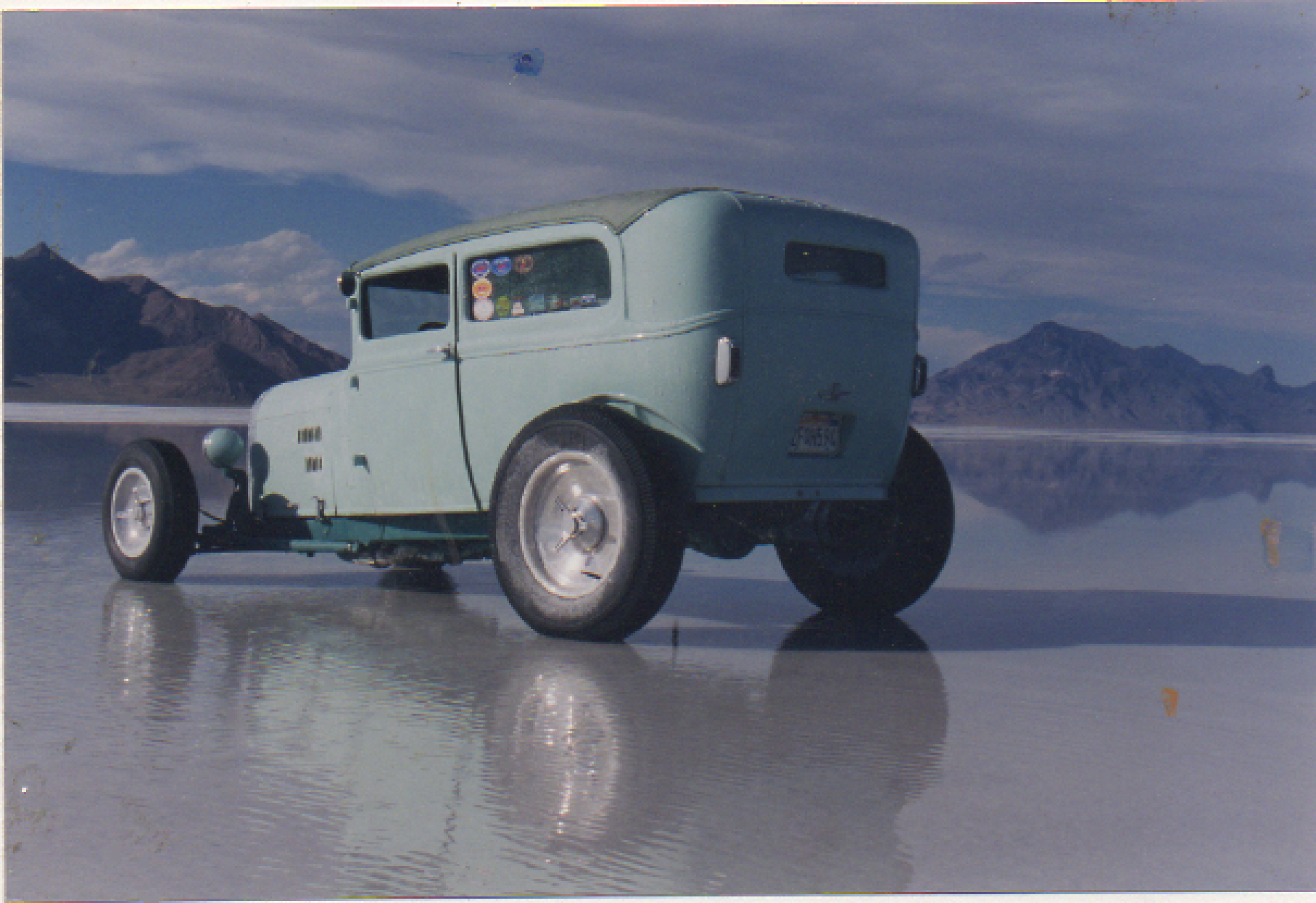

    While you are at it, I'd build a roll-down back window. It would surely help air flow during the summer. I'm reminded of not doing this as for a few years I drove mine to Bonneville and back. I wish I had done that 30 years ago.
