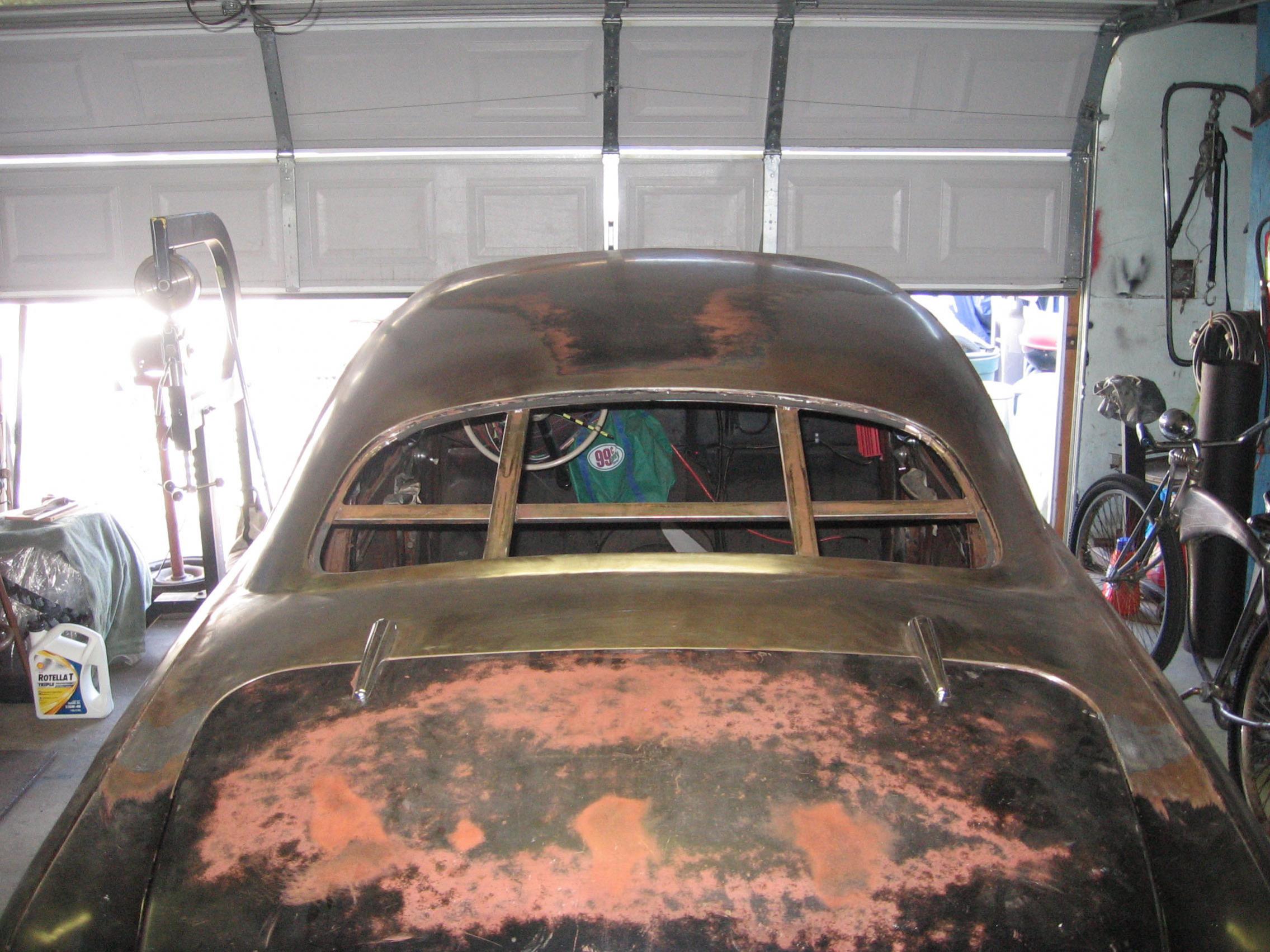

  24. chillywilly
    Joined: Jul 28, 2009
    Posts: 274
    chillywilly
    If that was your car I would recommend not touching it! The wrap around back window does cause some difficulty. Sometimes you have to "sink" the corners into the package tray which is a boatload of work. If you look at the 51 merc that we did you can see that the tips of the gl*** just above the beltline. Even though using that back window is much more difficult, the outcome is is a lot nicer as it gives a more "stockish" appearance. IMO

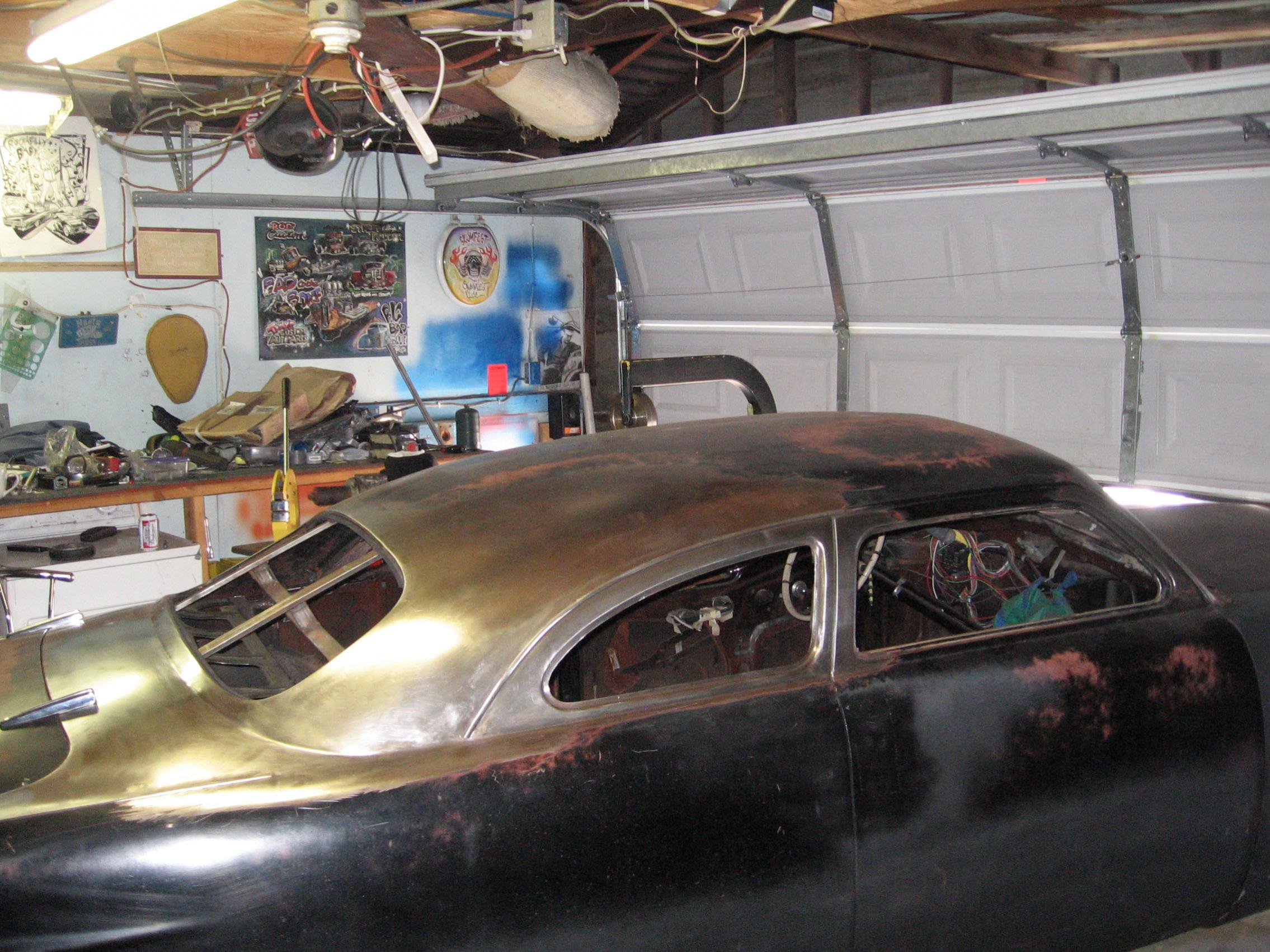

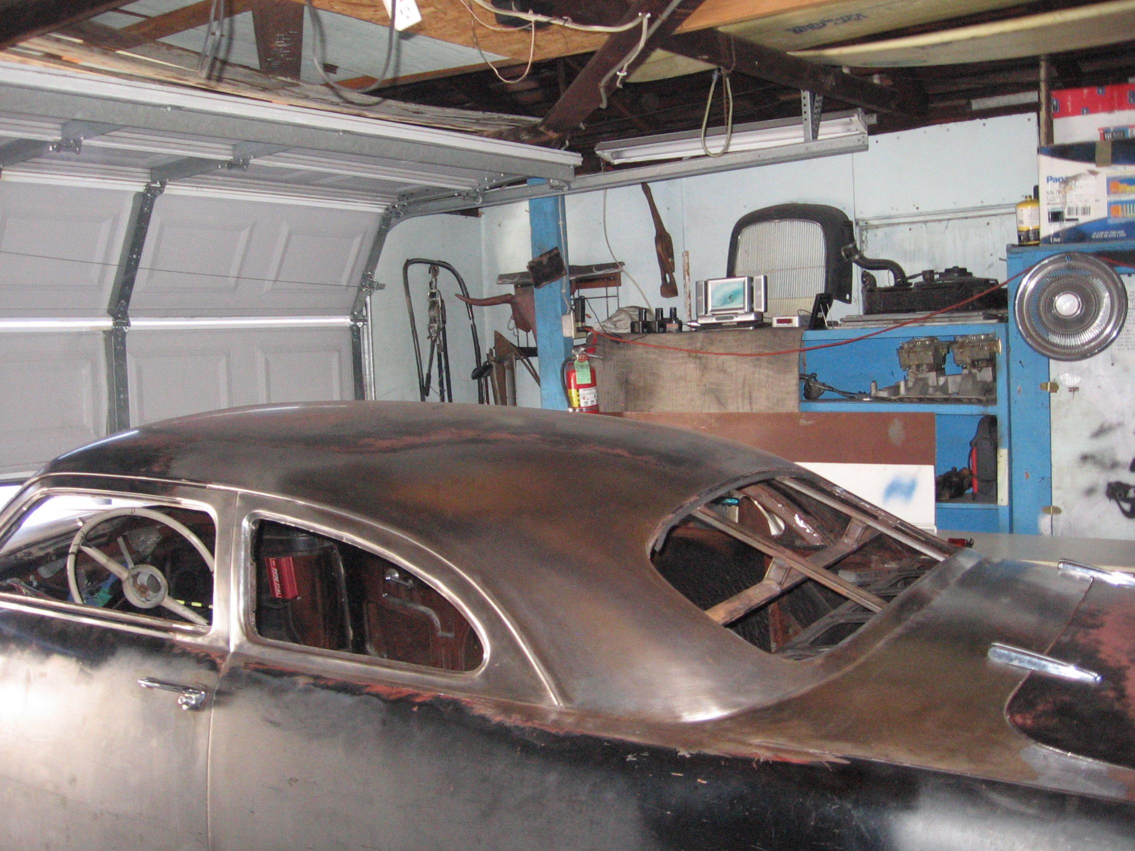

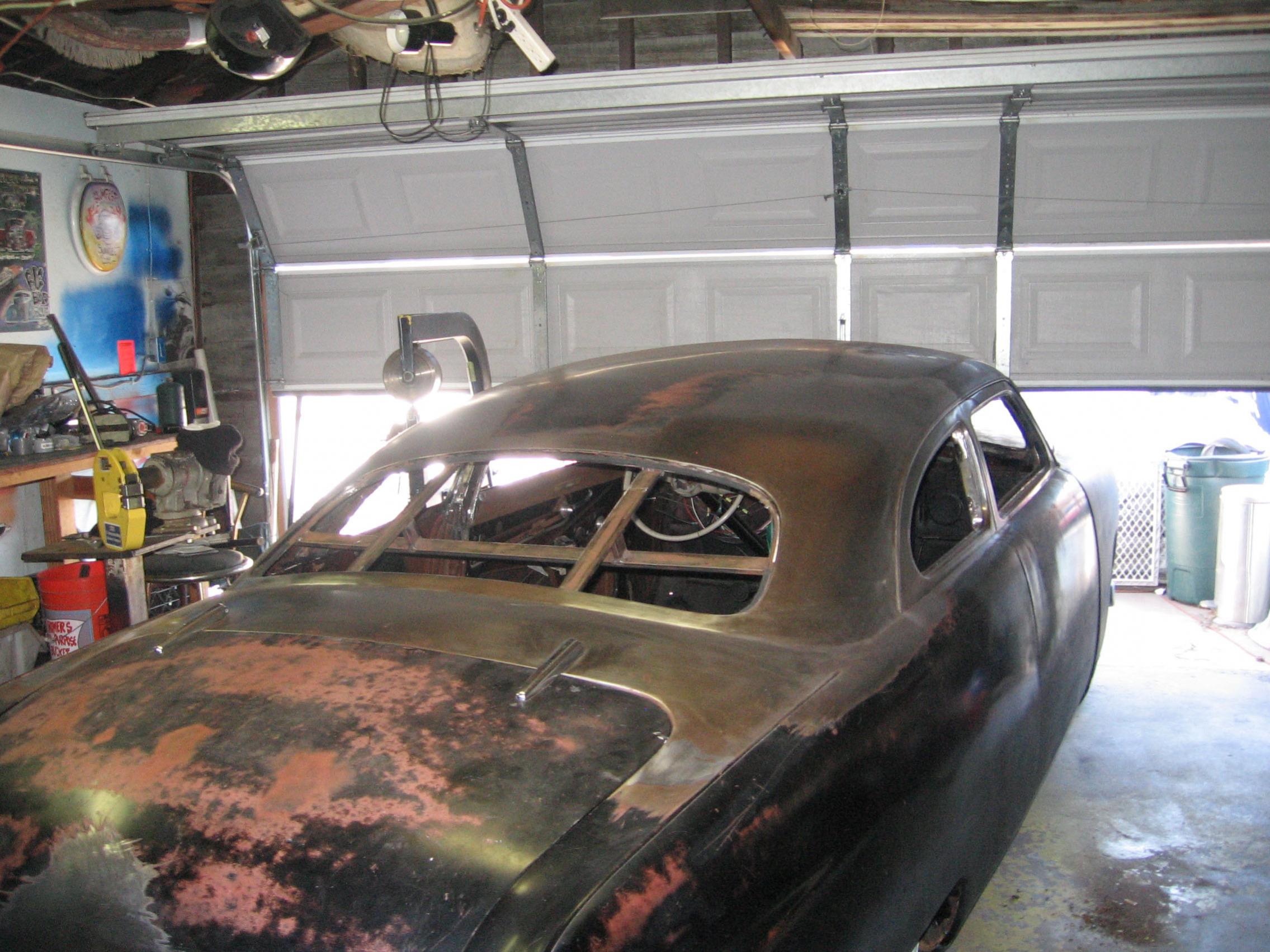

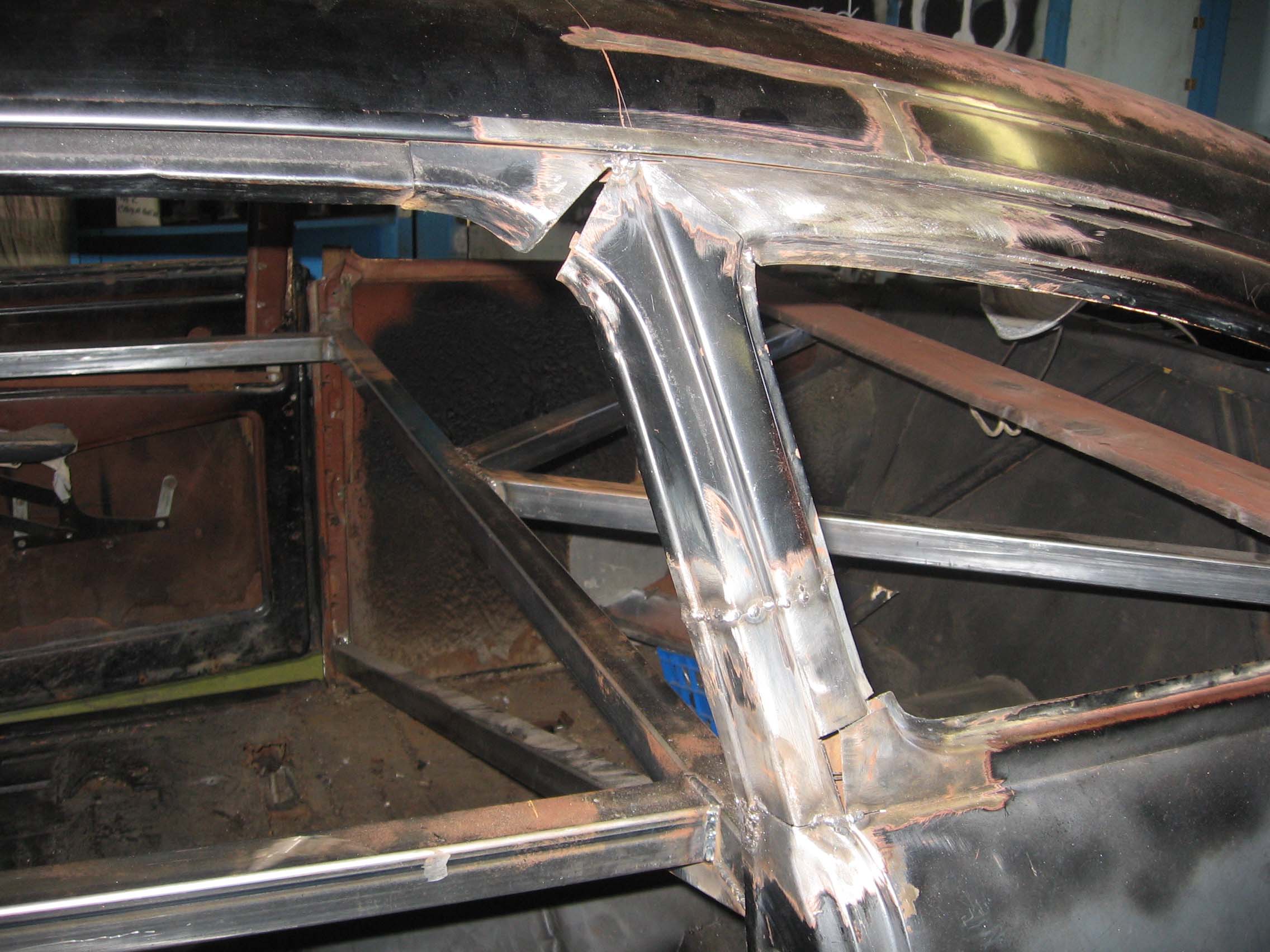

    So this ought to blow your minds... I don't have a tig welder. Brandon is doing all this with a 110 MIG welder. Hes fricken incredible. When he has access to better equipment it gets ridiculous how nice stuff looks. I can't wait to get some pics up of the coupe quarter windows and some lead work on the sedan! Thanks for all the compliments fellas !!!
  30. chillywilly
    Posts: 274
    chillywilly
    Alright!! I got some pics of the coupe uploaded ... super excited to be moving on this one again. I'll try to do it in step by step fashion - we'll pretend it's tech week;)
    First - you situate the c- pillar or sail panel against the quarter panel. Height will be pre determined by the chop. You can see the relief cut running vertical to relieve the metal and allow it to be pulled toward the quarter. Weld the roof section in place at the belt line and tack together in the interior of the window bottom. You will have a hard angle at the back corner - this is not ok! Cut away the outermost layer of sheet metal where the window comes together. By leaving the inner metal intact you will not lose the rigidity from the tacks placed earlier
