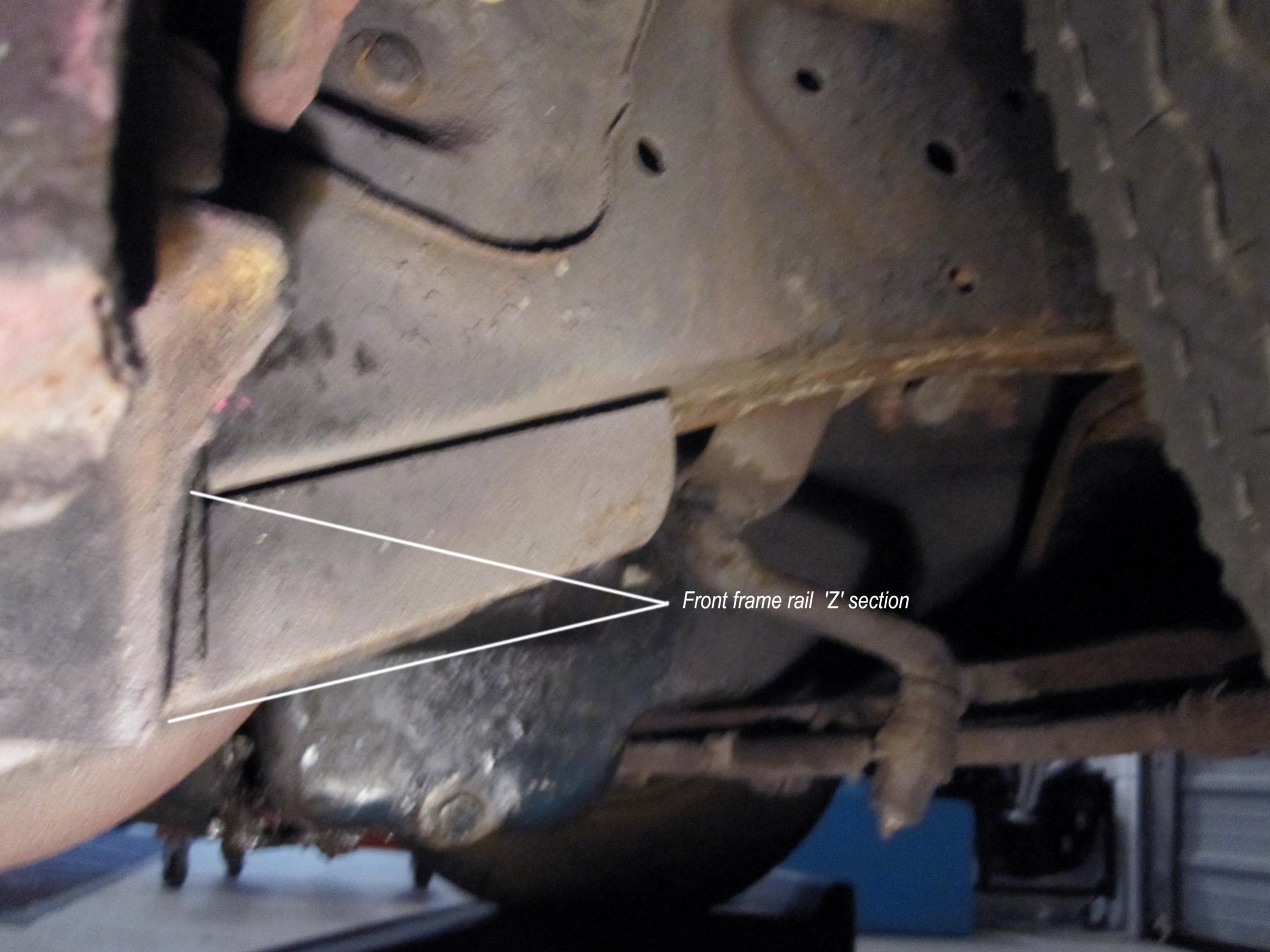

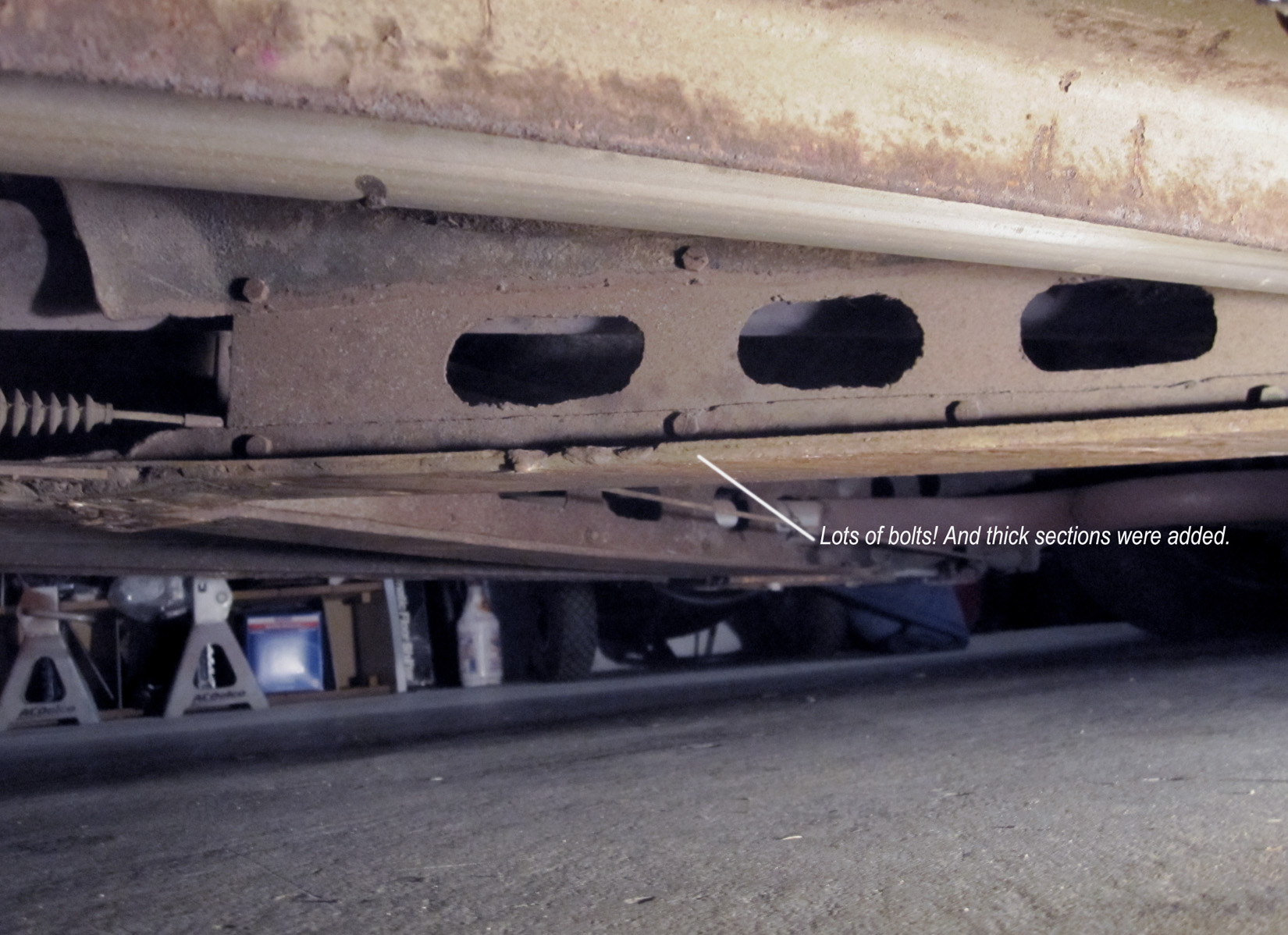

    Just saw this car in issue 30 of Rod and Kulture... Holy ****... mind blowing for sure. Chris, or anyone else, do you have pictures of the ch***is where it was bolted together? Id love to see that piece of engineering... glad to see another beautiful custom from back in the day being preserved and driven.

    VanHorton, I was doing a little work today in my shop so I took a couple of pics. Sorry for the poor quality, but I tried to get a few of the areas that show the modifications and the bolted in reinforcments. The frame rails have been sectioned to thin up the cross section so the frame was not visible from the side view, then a 1/4 or 3/16" beam section was bolted in. I have not taken exact measurements of stock Merc frame but I think it is sectioned 1.5-2", I was told the 'Z' to the frame was approximately 6" I think it might be 5", but who's counting!
    Some of the details in the article were not correct, so don't go by what you read, for example, the body section is more than 1.5", probably a typo since it is closer to 4.5" It is really noticable when I park next to a stock Merc.The article has a small photo of a stock but lowered 51 Merc next to the Mystery Merc for comparison.

    wow, thanks for the info and pics... I had a feeling it was sectioned more than the article said it was. So much work went into that car its amazing, I am so glad it it still on the road and the builders are getting the recognition they deserve. takes balls of steel to do that work in the driveway like that too..

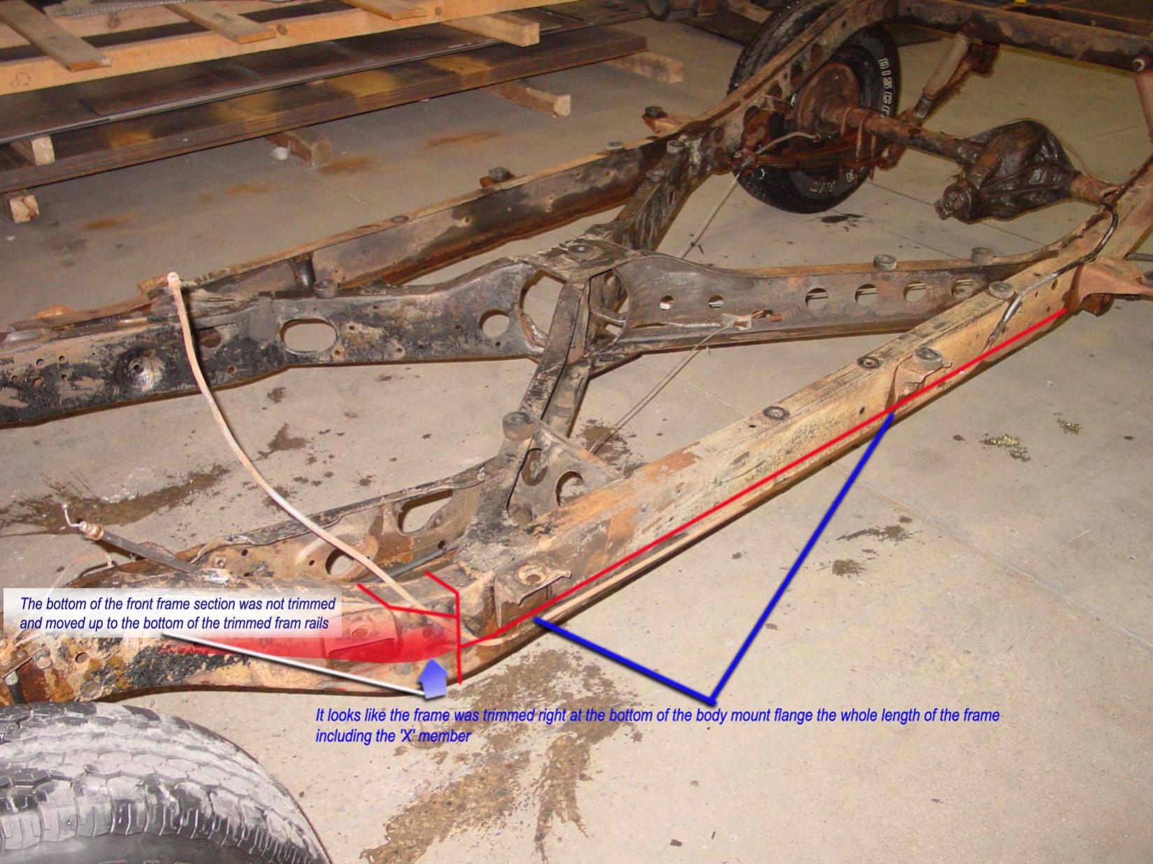

    I found a pic of a stock Merc frame in another thread, I did my best to illustrate what I 'think' was done to the ch***is section and the 'Z' at the front and back. The floor at the door opening is still flat, it is channeled behind the seats and front toe board, so the legroom is not compromised. It has a Cadillac seat in it now that should have been cutdown, but it is not, so the steering wheel to seat cushion is really tight.
