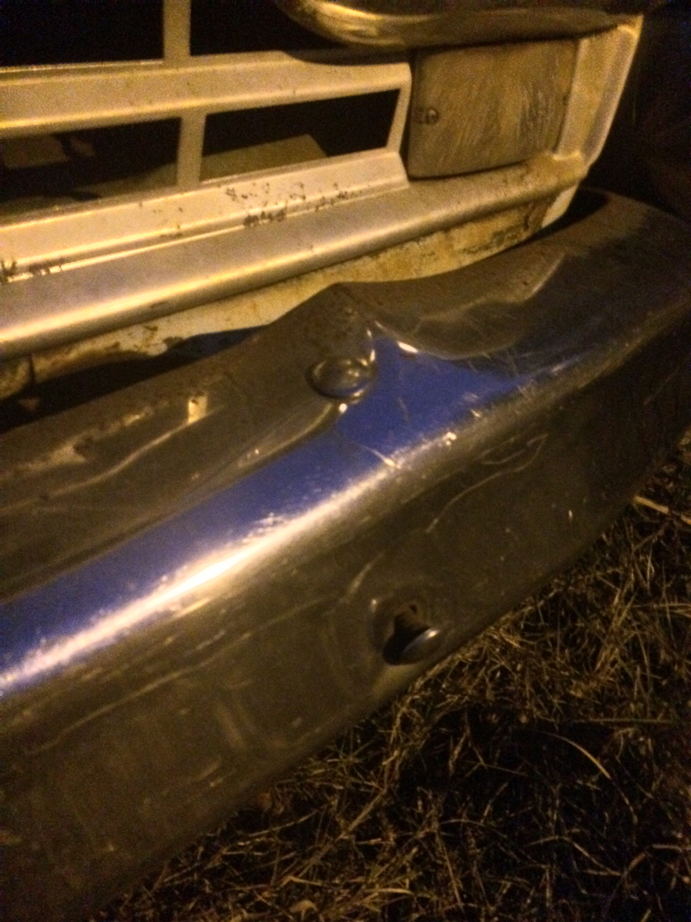

    Thanks for the help guys. A couple of pics, sorry about the poor quality...

    A few things I've done...as mentioned, a press might work to get the bolt hole back out close to where it belongs. And you might be able to grab the end of the bumper and yank it back a little bit, then with it removed, carefully put the kink in a vise, between two pieces of wood, and flatten it out some. The bend in the bumper will have to be pulled as you straighten the kink.
    You might be able to get it a bit better, but try not to make it worse..

  18. indyjps
    Joined: Feb 21, 2007
    Posts: 5,397
    indyjps
    Ouch, that kink in the top won't buff out, Squirrel's got the plan, you can improve it but it won't be straight without trashing the chrome.
  19. Squablow
    Joined: Apr 26, 2005
    Posts: 18,574
    Squablow
    I'd do the vice thing too, I bet you could get it close. Put paint sticks between the vice jaws to keep it from marring. Once you get it real close, some times you can clamp a really big adjustable wrench over the lip and bend it down a bit to get the edge flatter.
  20. squirrel
    Joined: Sep 23, 2004
    Posts: 60,043
    squirrel
    good point on the wrench thing, I forgot to mention that. Go real easy with it though.
  21. 30dodge
    Joined: Jan 3, 2007
    Posts: 498
    30dodge
    from Pahrump nv
    Bolt it on the best you can. If you can, tie the frame rail down. Jack up under the twisted end and hit the bent peak with a B.F.H. (you may want someone holding a good chunk of oak on it). Repeat, repeat.
