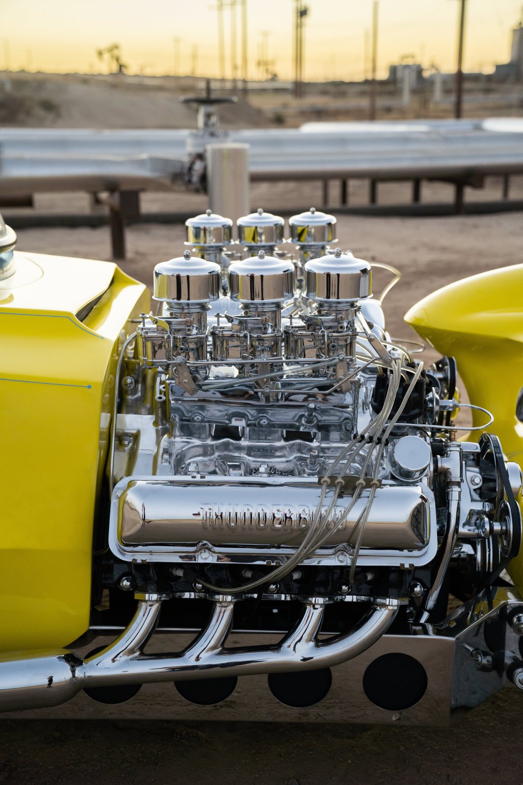

    Go ceramic, if the coating is quality it is very tough, looks very close to chrome and lasts a very long time. It can be polished. picture032.jpg

  8. Mikey,,,,,,beautiful pic,,,,,,love the view angle .
    That’s a real hot rod !
    Tommy

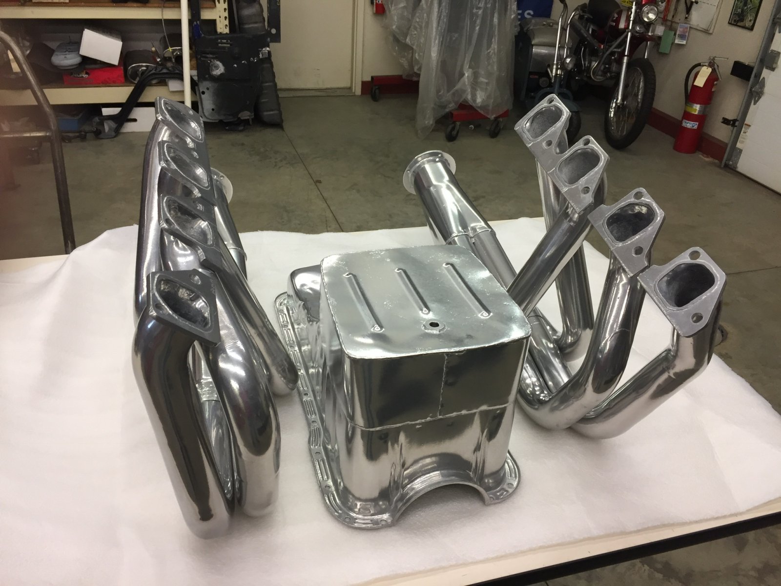

    I had these headers and oil pan chromed back in the ‘70’s, they were a maintenance nightmare and as mentioned above the chrome did not cover in some areas between the tubes. This time around I had the parts finished by Jet Hot Coatings in a bright silver finish. I am please with the look and the finish. Another benefit is that the new coating also covers the inside of the tubes.

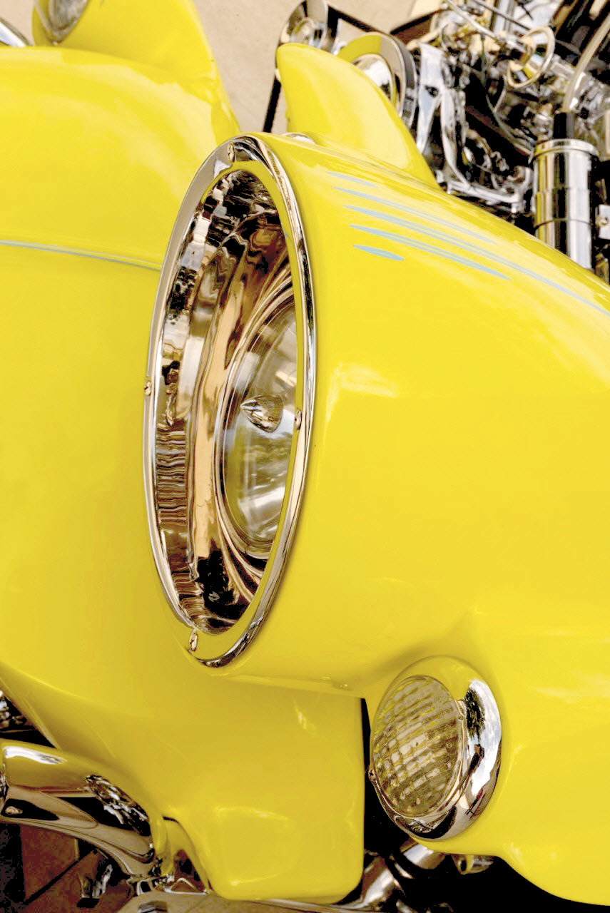

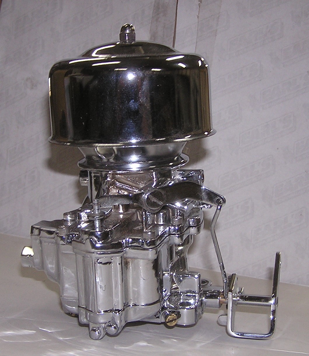

    i vote for thwm. I neede a lot of custom chrome done on my Mysterion reproduction. I called several companies to find someone but they were either way over pirced or refused to do it. Custom was very accomodating, and their prices were unbelieveably reqasonable.
    They did all 6 carbs, and the piece de resistance was the Plymouth headlight rim. My rim was actually in pretty decent shape but the found a small split in the folded rim and welded it up. And the thing that blows me away is they got the chrome to throw way deep inside the rim.

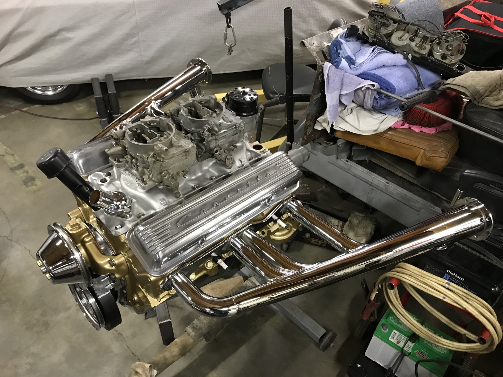

    I’ve had two sets plated at San Joaquin Chrome Plating in Lodi, California. Mike is a great guy to deal with and the price is not outrageous. I’m with you, nothing takes the place of chrome plating. All those coatings have there place but they just don’t look right on some period specific builds.

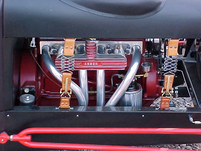

    Always loved the look of CHROME*****, in my real world though,best I could do was polish hell out of every thing I could*,too kind fool some into thinking I had a lot of chrome on my hotrod,an buy little chrome thinga,like acorn nuts an little stuff that was cheap.
    I didn't have chrome header[ just painted them],tell many years after building my hotrod in 1959.
    Many years later,a buddy who had a nice T-bucket cracked his chrome hear,right next too head flange. He ask if I could weld it? Sure,but next he ask if it would mess up the chrome"YES",next thing he said was,"I'm just going to buy new chrome headers then !!! I ask if I could have the cracked ones! He said sure,but "No way these old SBC Headers will fit your Thunderbird Y-block"
    After I cut the SBC flanges off,an opened a small gap between the center tubes,welded Ford Y-Block flanges on them and painted the welds with high temp sliver!
    He an I ,loved my new chrome header!!:D:cool: PeggyHi ArtDeco19.jpg
