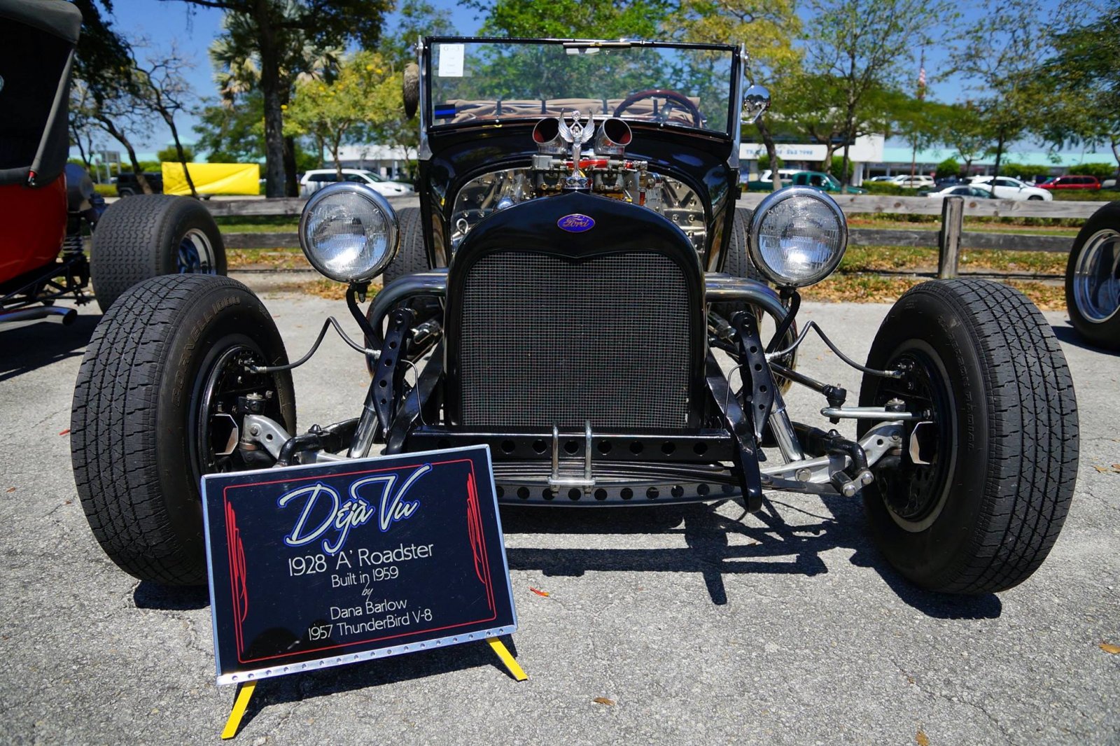

    I'm low buck,always have been,so I cheat by ether polishing an clear over,or use Chrome tape< now some pretty good chrome tape is around. Used for kick panels ect.
    That stuff put on smooth can look just like chrome an last a far amount of time aswell. My shocks and tie rods are chrome { taped },and never in the last 10 years has anyone even ask"Are they just taped?" Total p*** as chrome. I think a grill could be done this way. Just ideas for you !

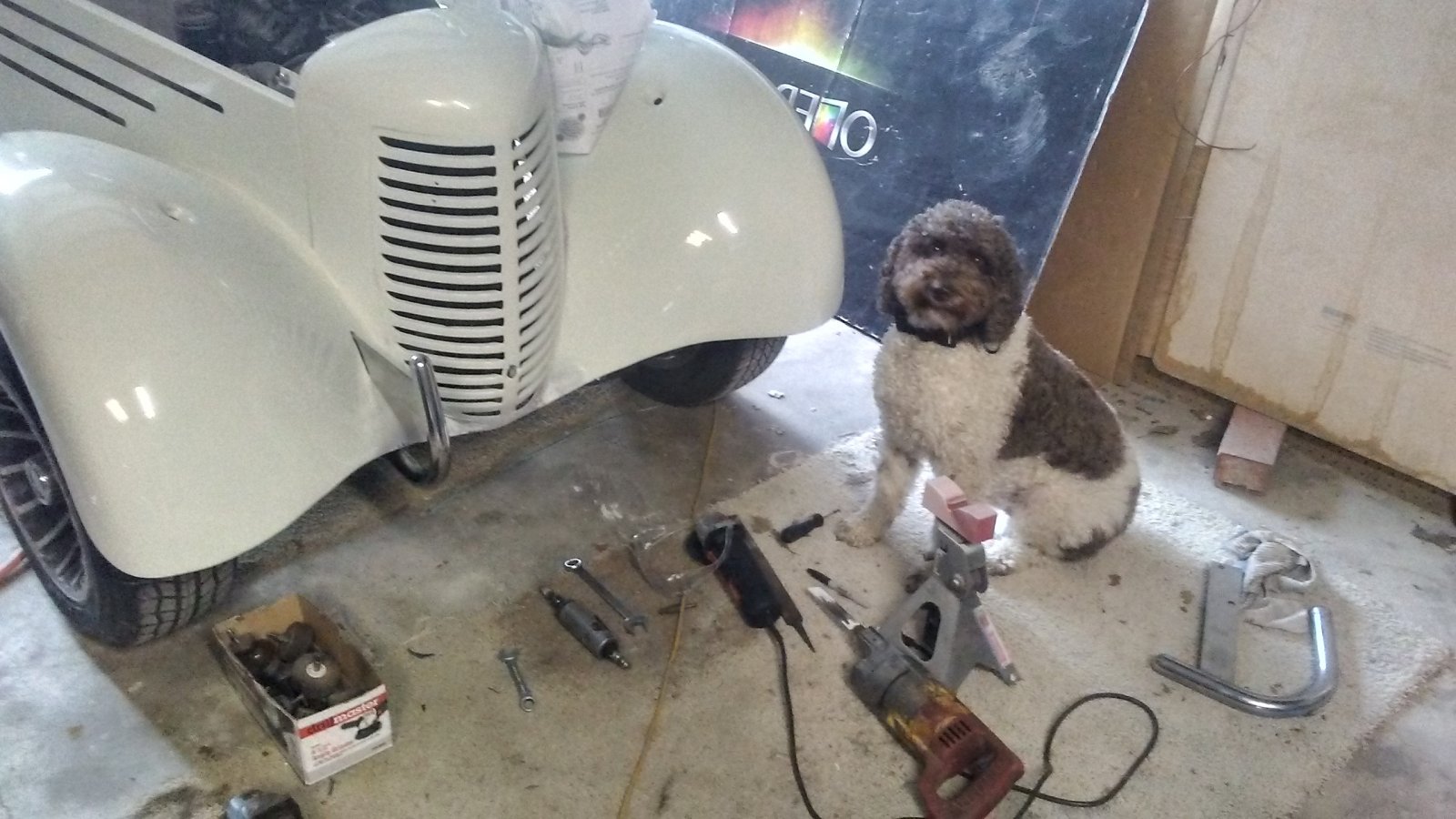

    Looks good. My Bantam grill is part of the body, no chroming that. It's just body color, another option.
    Only picture I got at the moment.
    dana barlow, BigRRR and Desoto291Hemi like this.
