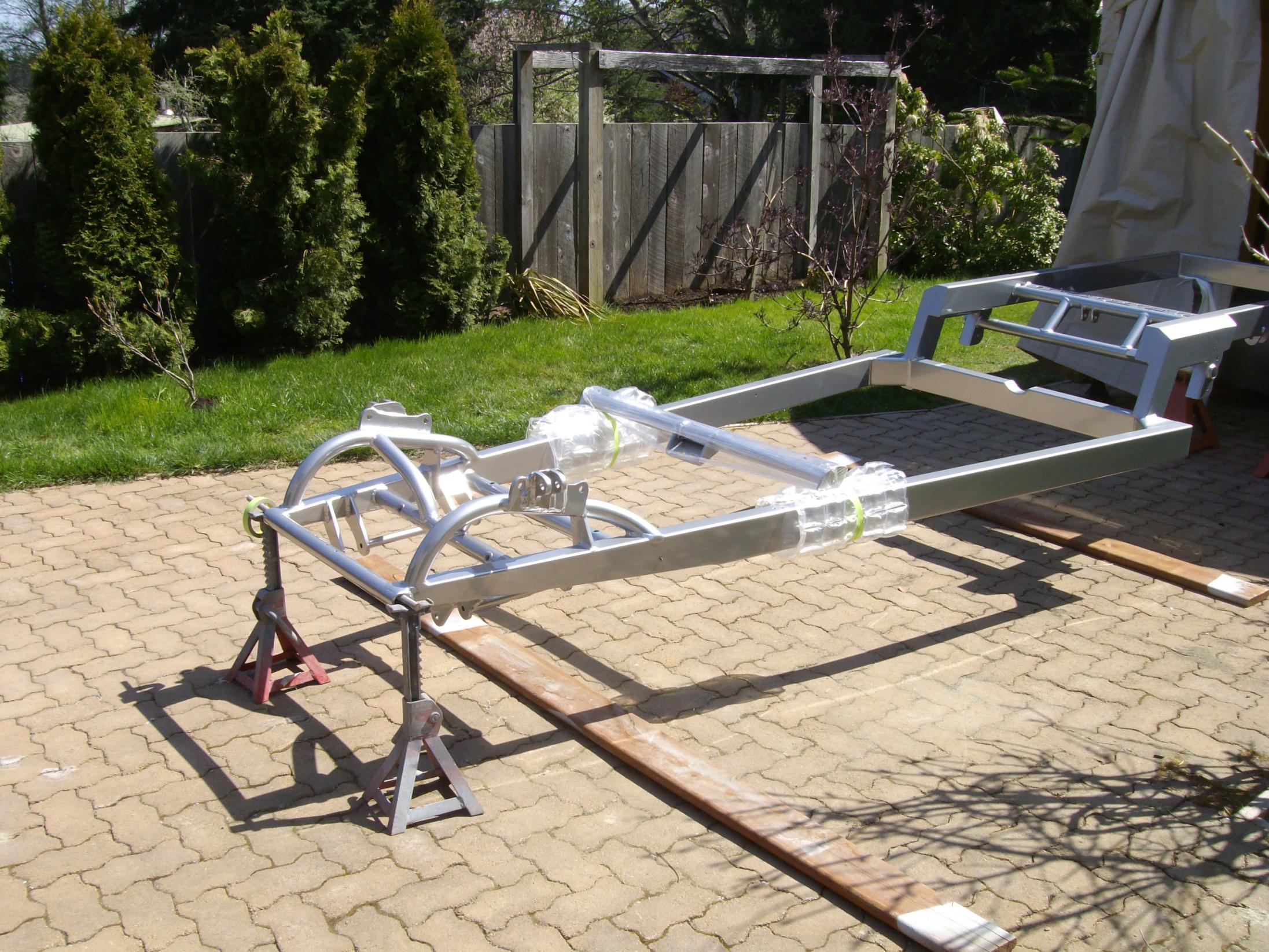

  8. 32v
    Joined: May 20, 2007
    Posts: 952
    32v
    from v.i.
    pic of chrome powder coated frame

  10. temper_mental
    Joined: Oct 22, 2006
    Posts: 2,717
    temper_mental
    from Texas
    looks like silver paint to me.
