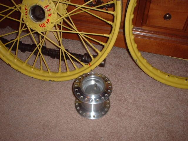

  18. Any ideas as how much it might cost to chrome these wheels?
    I got these from Garlits last year for the project car in my avatar.They were originally made for MOON,& they were destined to go on a rocket car that MOON was building..."Baby Mooneyes".The project was shelved & somehow Don ended up with the wheels.
    They didnt have any plating on them,they just painted everything MOON yellow.
    We cut the spokes out of one of them,& I chucked the hub in my lathe & sanded it to give the brushed look.Im planning on replacing the spokes with new chrome or stainless pieces.
    The wheels are 19" X 40 spoke & are not rusty at all.
    I called a local chrome shop,& the guy would not give me a price.He kept talking about the prep work,& all the polishing that needs to be done around the spoke holes(which I totally understand).He cautioned me about this,stating that if they weren't careful,the spoke holes would become enlarged,so when the spokes are tightened,they could pull thru the rim.Im not looking for double-throw-down bling,,just a decent job.
    Any ideas?
