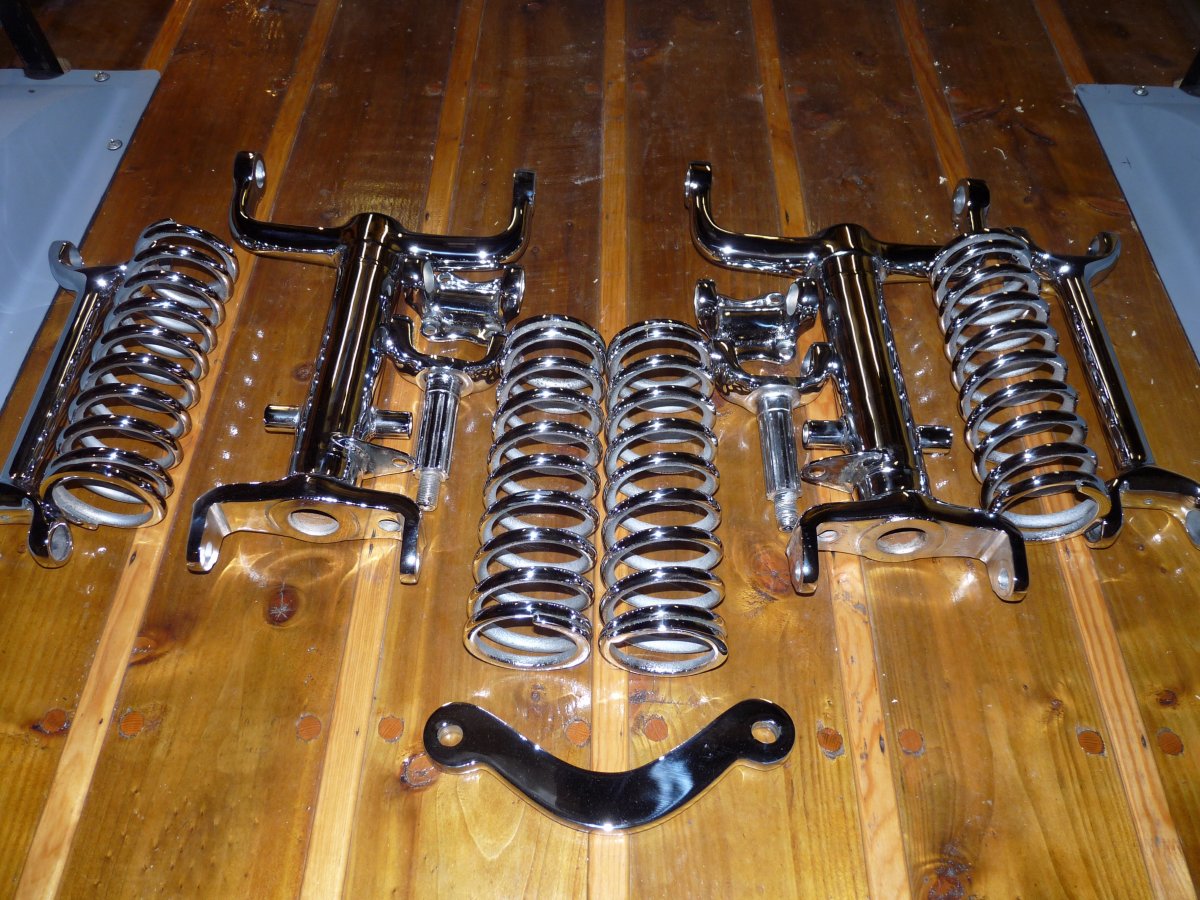

  25. See the springs?
    See the inside of the springs?
    Is that "Corrosion resistant Bright plating"?
    That's what I want.
    It's obvious nobody prepped and polished and fussed over the insides

  28. You're thinking high visibility and easy access
  29. DDDenny
    Posts: 22,893
    Vicky
    I think I posted this on one of the chrome threads, hard to rememher, there are a few.
    The inside of those springs looks a lot like the stuff I had done in electroless nickle.
    A lot of the time regular nickle is brighter but I pre brushed these parts and requested a satin finish. I specifically wanted the "understated look".
    It is corrosion resistant but not corrosion proof, considering it was a quarter of the cost of chrome, I'm good.
