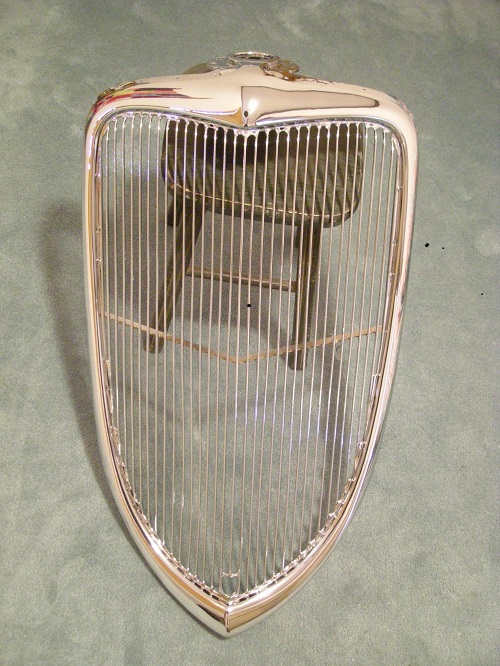

    MEC-LEC Plating in Fresno Ca did my original 34 grille. Very reasonable ,good turn around & super nice. They do a lot of Harley parts & low rider stuff.

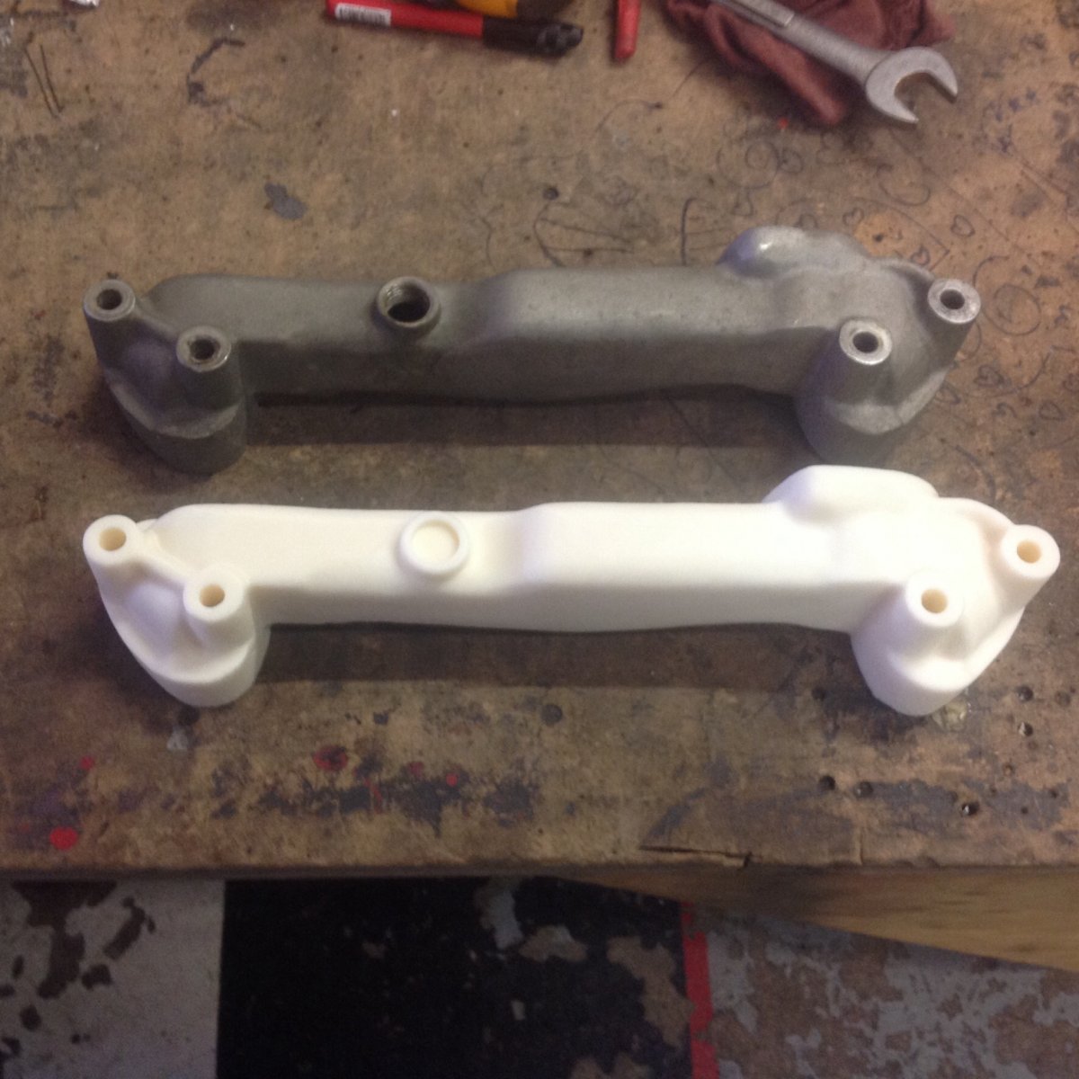

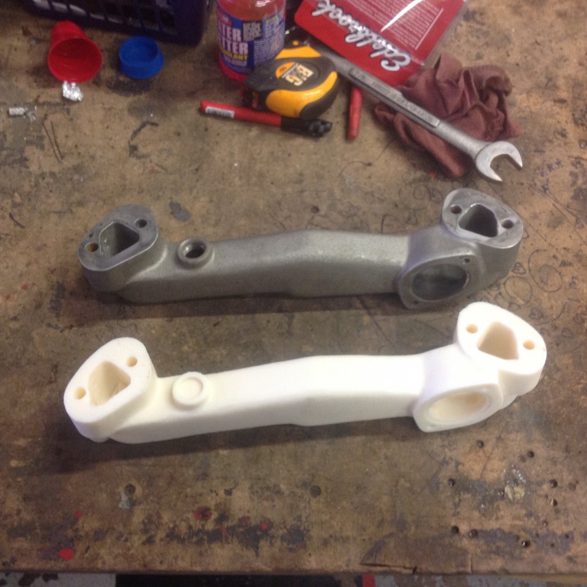

  16. NASA??? The "Never A Straight Answer" guys?
    Those guys forgot how to get the moon without Stanley Cubric's help.

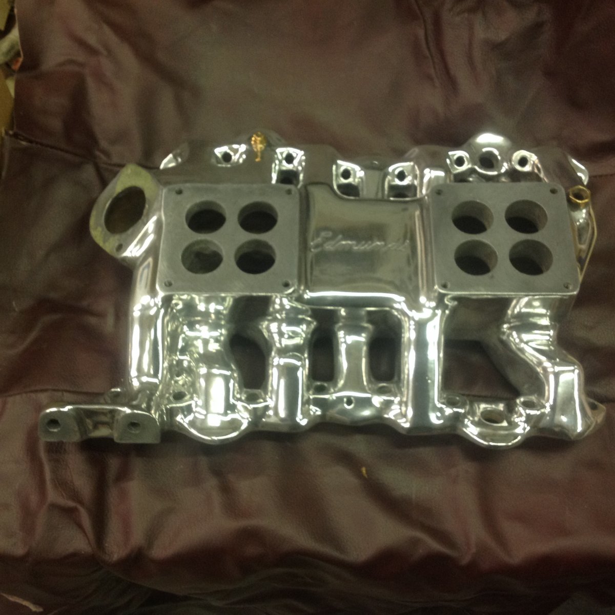

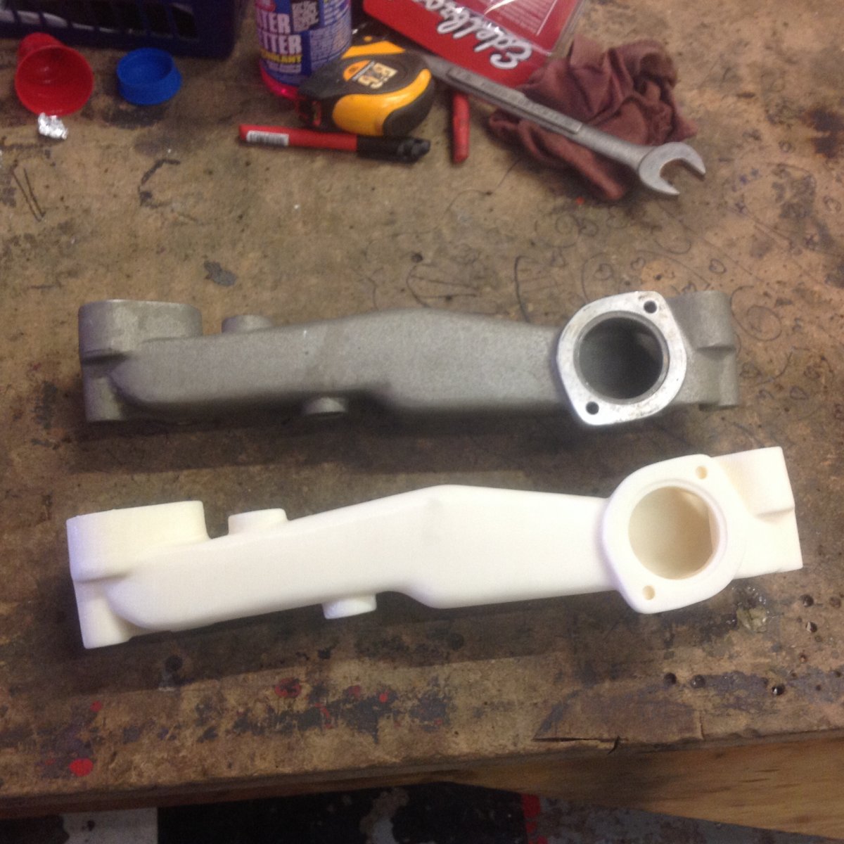

    So you can grow any part?
    Possible ?
    How about this one ?
    Click the pic to get bigger?
  17. sudzhis
    Joined: Dec 1, 2012
    Posts: 404
    sudzhis
    from Latvia
    ITs not so new or old, this is different- couple of electroplating processes. Base of all is not a secret, but there is so much tips and tricks, that can be solved only in many years of research and tests.
    About these parts on photo. There is much easier to use lost wax technique (check youtube). But yes, this is possible, but very hard and too long process. This method is good on parts that are thin and very difficult to made in other process. Like this grill mask, like this taillight. This process is more on decorative parts. English is not mine native language so i have no so good explanation like in mine language and google translate doesnt know these terms :) :D

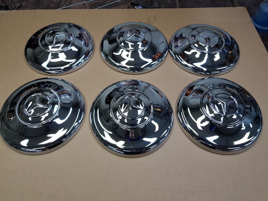

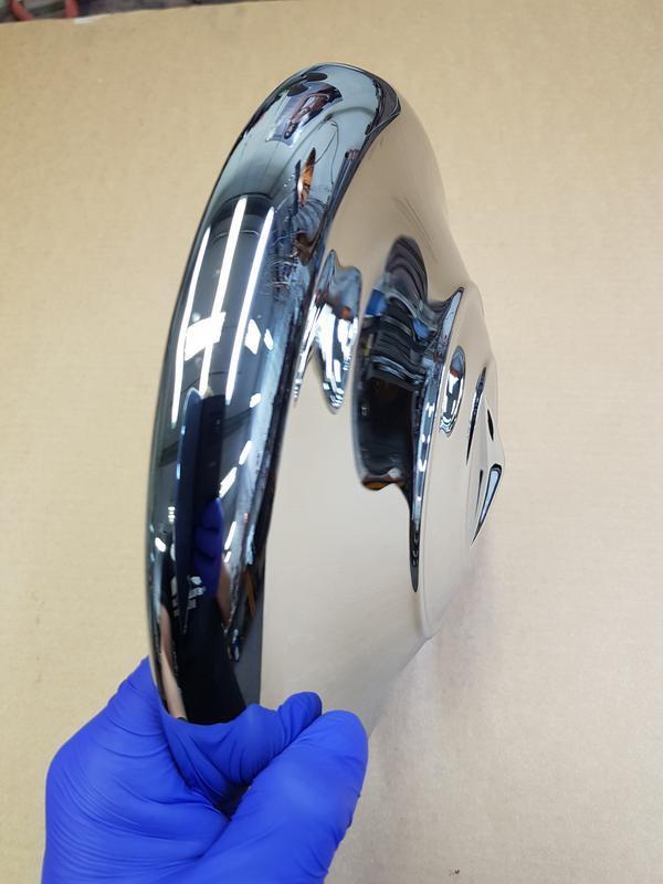

  23. sudzhis
    Joined: Dec 1, 2012
    Posts: 404
    sudzhis
    from Latvia
    Updates.
    Fits to lots of pre war mercedes benz
    Made from copper

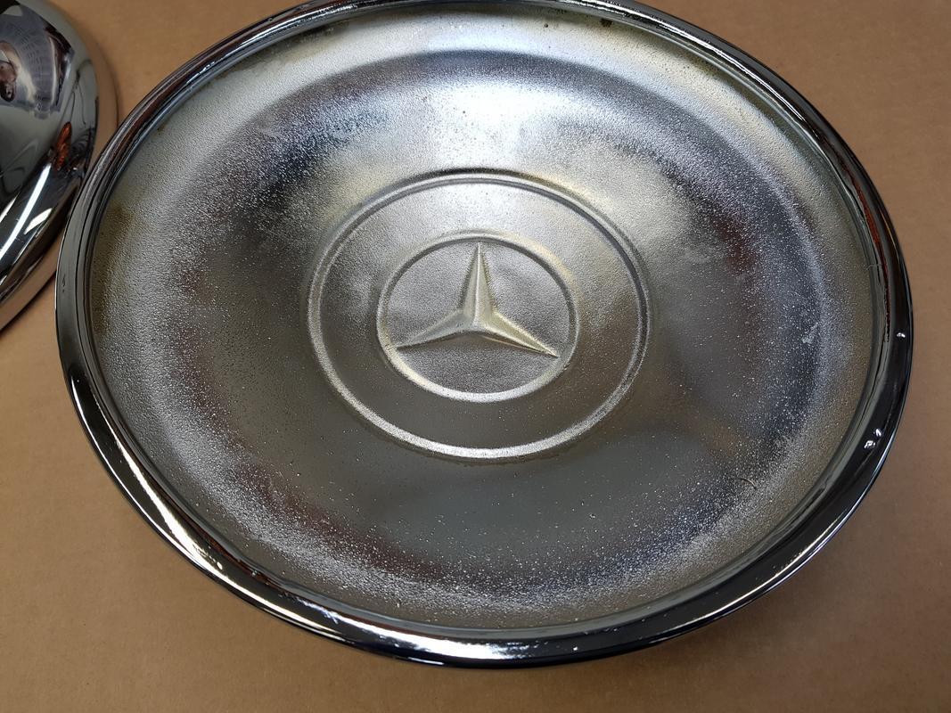

  24. sudzhis
    Joined: Dec 1, 2012
    Posts: 404
    sudzhis
    from Latvia
    Under chrome

    from Latvia
    Reproduction of Horch 853 and Mercedes Benz 170v w136 headlights
