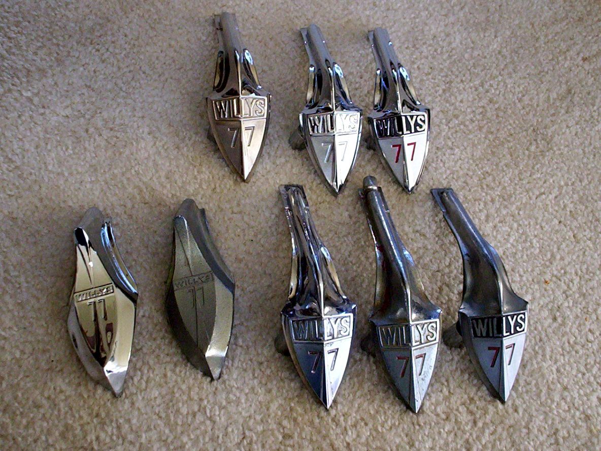

  17. If I remember right nickel without the chrome over it will turn yellow with age and can corrode. I have a NOS WILLYS grille ornament that is nickel plated and it has a yellow tint to it. I took it to the chrome shop and he told me it was nickel and never had chrome on it so I took it home and found a different one to have chromed 100_4101.JPG
    Top row far left NOS nickel plated, two on the right are the re-chromed. I'm not sure nickel without chrome over it is as durable
  18. Nickel is actually pretty durable, but does tarnish and needs to be polished occasionally. Ford used it for radiator shells on the model As, a lot of those have survived. Remember, in 'triple plate chrome', nickel is the sealer/protective layer, chrome is 'decorative'.

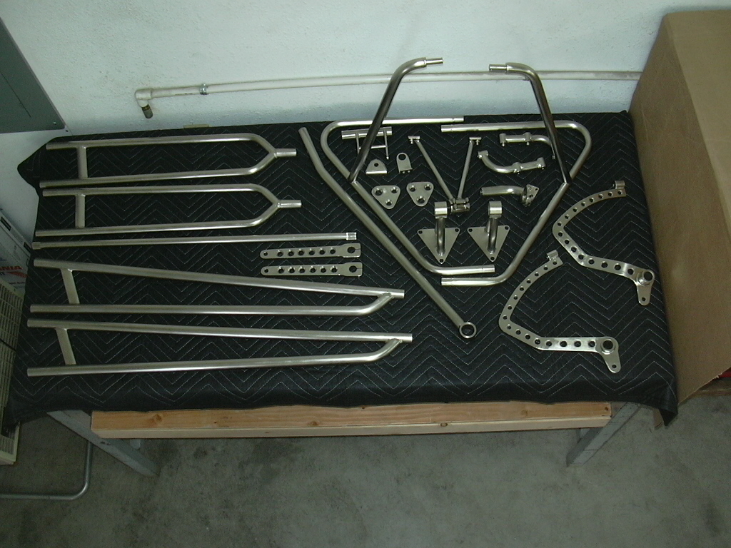

    I had all this done with electroless nickel, I would like for Redo to chime in on this subject to hear his thoughts on this process and it's durability.
    56don likes this.

    Hey Denny... Electroless Nickel is an interesting finish. Abbreviated EN it is used in the electronics industries. It can be chemically modified to have a wide range of characteristics, hard-soft, bright-dull, corrosion resistance or wear resistance. As the name implies there is no electricity involved. Solution A and Solution B and dip your parts, (don't tell Vic I said dip). It is pretty thin, I think a standard finish is 0.10 of a mil. I don't have a lot of personal experience with EN as a finish on auto parts, we have some aluminum parts EN as a base to copper nickel chrome. It save us the trouble of all the extra chemicals involved in plating on aluminum.
    A new solution will plate bright & as the chemicals are depleted it will plate less. The solution can be regenerated several times but eventually will be wore out. It is treated for disposal and a new batch is mixed up.
    Because there is no electricity involved there is no worry about current density or special anoding .All surfaces will plate evenly.
