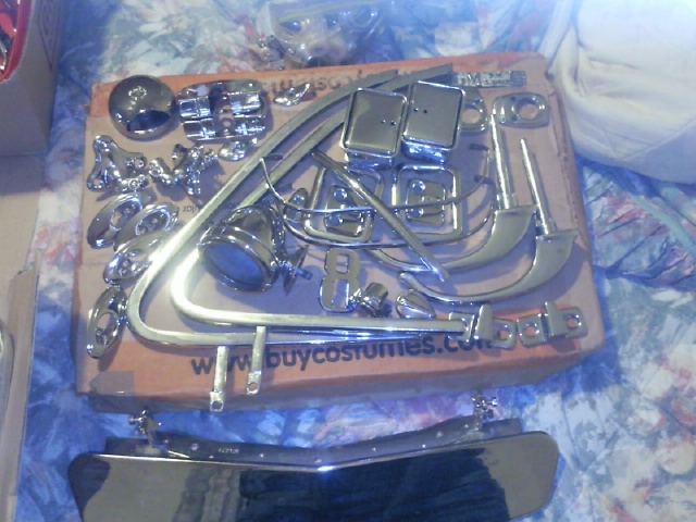

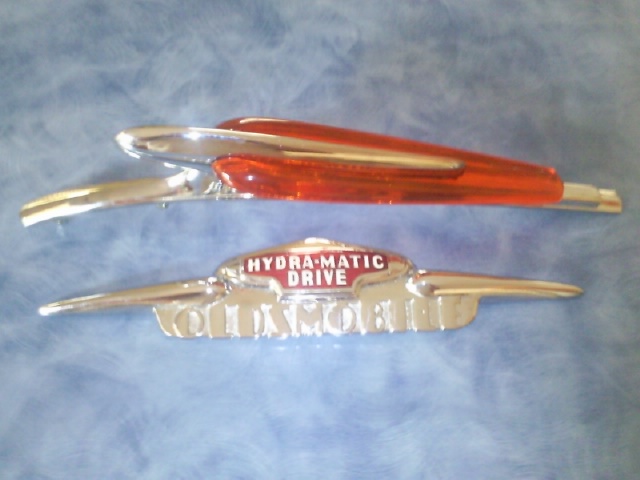

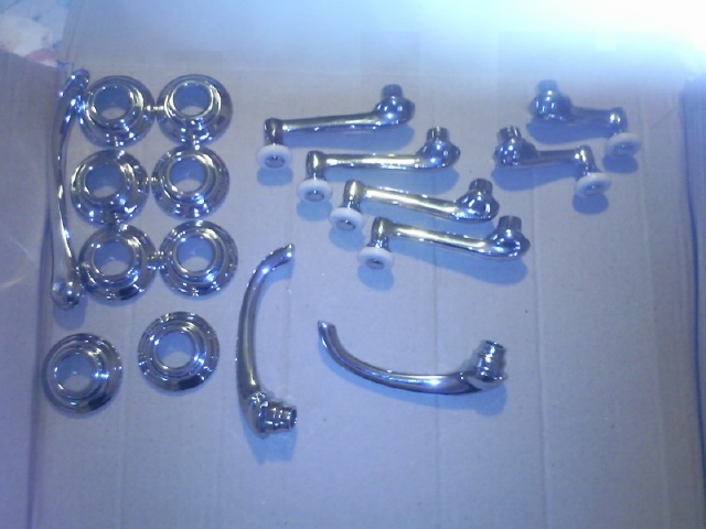

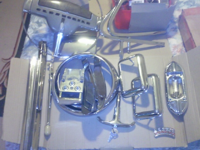

    Hi for all! If someone remember me, i posted there few years ago in forum about DIY "spray on chrome" topic. Ok, i still make this business on some interior parts, but now main product is real chrome! Ohh, we made chrome workshop and now we restore old car/bikes parts for shows. Some MB 190sl with mine chrome bumpers and interiors is running in USA too ;) some photos...
    We have cyanide copper, bright copper, nickel, chrome! Ah yess, pain in the ***- pot-metal we chrome too! actually we chrome everything without stainless steel.
    some pictures...

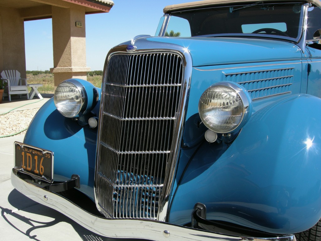

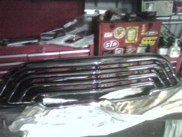

    I had all the bright ware on my 35 Chevy phaeton done 15yrs ago and complained about it then. The cost was nothing in comparison to my 46 Olds! Lots more bright ware with larger pieces! You get what you pay for and the triple plate this time around on the Olds is a lot better than that on the Chevy. The ****py bars were sandblasted to remove all the scale before being dipped to strip the chrome. e.g. The grill was copper plated and buffed until all the imperfections in the pot metal were non existent. Preparation, like any foundation is the key to success, that's what you pay for and I can verify that. Given the environmental / health issues and licenses required (Cyanide) it is pretty cost prohibitive these days. Plus any stress related components (Jag IRS 1/2 shafts) requires heat treating (Certificate) to remove any hydrogen embrittlement; more $$$
    57 Fargo likes this.
  17. sudzhis
    Joined: Dec 1, 2012
    Posts: 404
    sudzhis
    from Latvia
    What was price for the grill?
  18. mgtstumpy
    Joined: Jul 20, 2006
    Posts: 9,311
    mgtstumpy
    Entire car with grill, front and rear bars, all external moldings and miscellaneous items including polishing all the stainless steel trims etc was over $AUD3K
