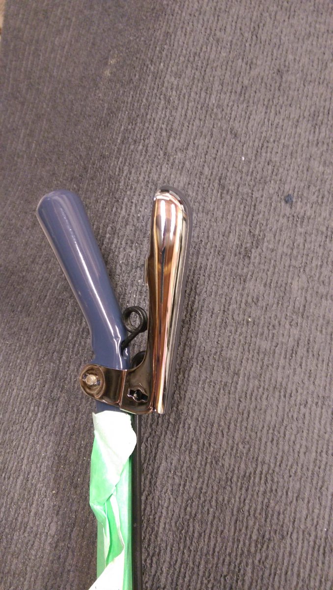

  26. aonemarine

  28. Blue One

  29. aonemarine

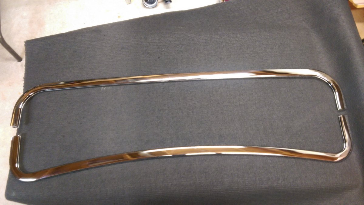

    Joined: May 29, 2006
    Posts: 9,817
