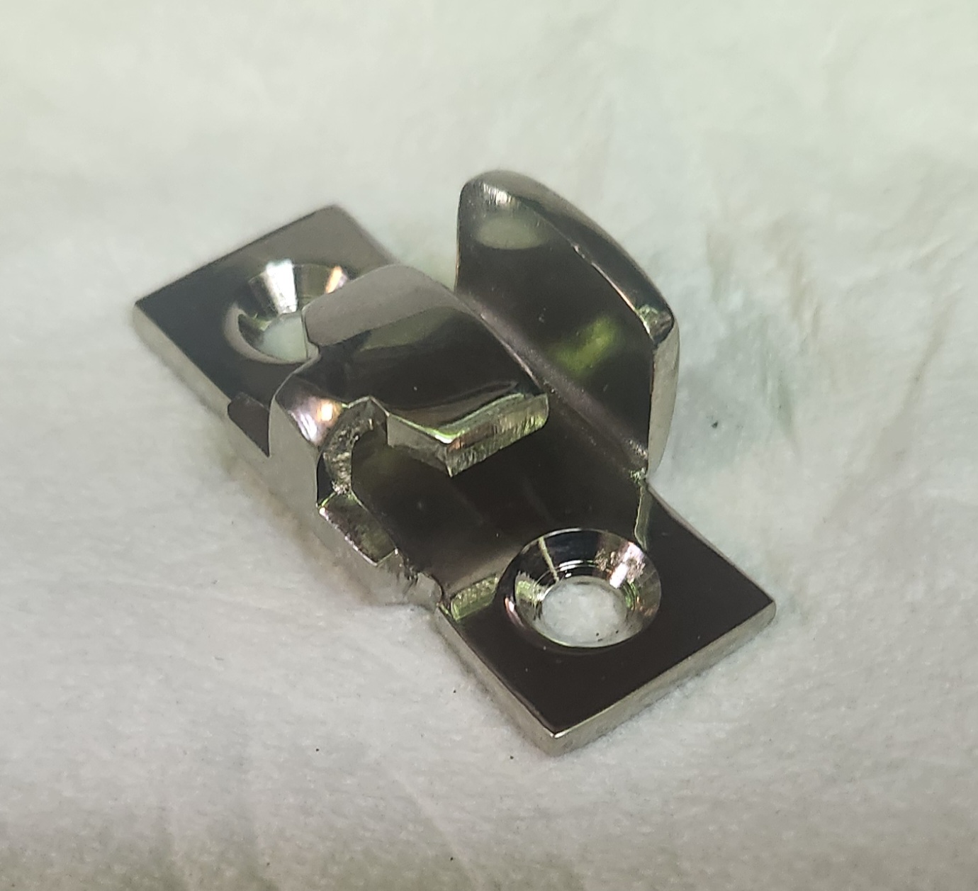

  1. 20250523_151434.jpg Today I bought a shiny new part for my funky old Deuce. It stands out like a sore thumb. I tried soaking it in muriatic acid. I think that actually made it brighter. Other than paying a chrome shop a fortune is their a home way to remove chrome?
    It is the front hood hinge holder.

    What is the part? gimpy beat me. Muriatic is usually diluted HCl. If the muriatic was strong enough to dissolve the chrome, there is still shiny nickel under there. Sandblast and powder coat or epoxy and paint. If you insist on stripping the nickel : empty the sulphuric acid from the stash of batteries in the corner in a plastic bucket and use a reverse current from a battery charger.

    The Muriatic acid will only strip the chrome, which isn't very thick. Probably a few micro millimeters and the chrome is only there to keep the bright nickel from tarnishing. You probably are already through the chrome layer since you went after it with the acid. The nickel, which is the "bright" part, will not be stripped.
    So you either go after that with a sander, or take it to a chrome shop and have the remaining nickel stripped.

    The part in question is a reproduction front hood bracket that bolts to the grill surround.
    The centre stainless strip slides into it, and there is a similar wider one on the rear above the firewall that bolts to the firewall and body
