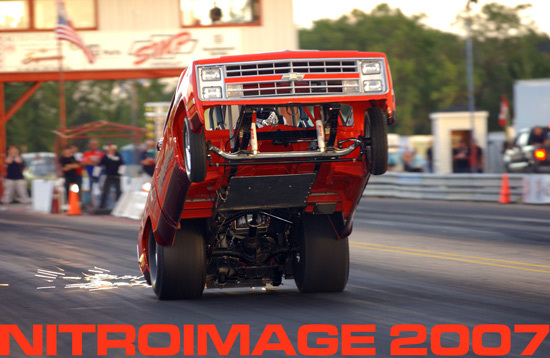

  2. we have a chrome A100 axle under the one nite stand wheelstander ,its been there bout 15+ years no problem.............
