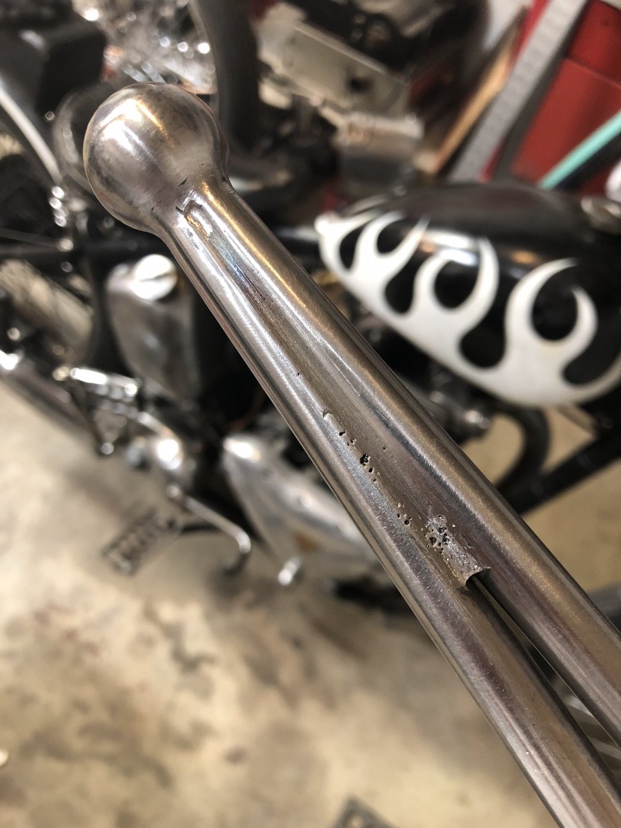

    Been drilling and chasing pits with steel filler for over an hour. Would make my life a lot easier if I knew I could flow a bunch of bronze over a few pieces I’m working on then file to shape before chrome.
    Any first hand experience out there?
    Disclaimer: this is definitely a traditional hot rod part... and definitely not a chopper part.

    And to the others — this will be a tig operation so no flux to worry about. No brass, no silver.
    I’ve been drilling out the pits beforehand but something is amiss. This is all new metal, clean filler, I’ve even changed filler and tungsten a couple of times. Must just be impurities in the steel.

    Make sure there isn't a breeze in the shop, that can easily disrupt the Argon coverage and cause problems. Also, if you're flowing Silicon Bronze over steel to fill pits, you don't need as much heat by far. Make sure you're not re-flowing the steel. Bad gas (or contaminated lines) are a possibility, but unless it's constant in every weld I would suspect poor Argon coverage first. You could also switch to a gas lens on your torch, or if you're already using one then add a Furrick cup that fits over it like the #12 or BBW which have an additional mesh to help direct Argon (and can use higher flow).
    As Unkl Ian says, silver solder is a possibility too (and there are good low-temp 500 degree silver solders) but I would worry about it getting pulled out of the pits during buffing since it's softer.
    Otherwise, should work just fine.
