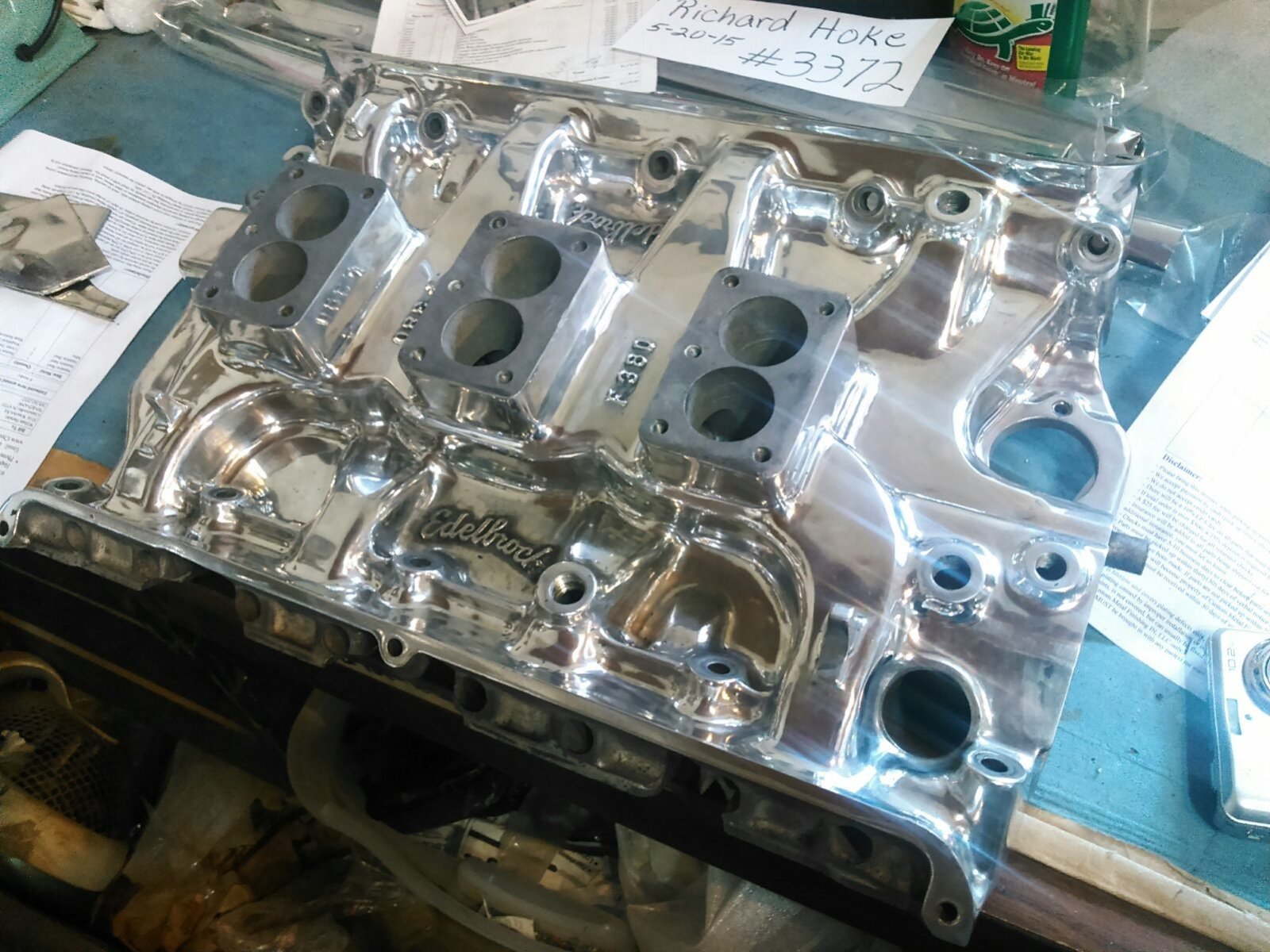

    I had my Mysterion intake manifolds professionally polished. Chrome gets really problematic on items with deep areas. Copper and nickel will 'throw' into deep areas but chrome wont. That being said, these guys did wonders for me on my project. They chrome plated all 6 Stromberg WW carbs beautifully and even chromed the deep aluminum headlight bucket which had to be a real challenge. Did it all mail-order from California in good time and great price.
    Polished manifold.
    Finished carbs
    All together.
    This is a really hard chrome task they did marvelously.
