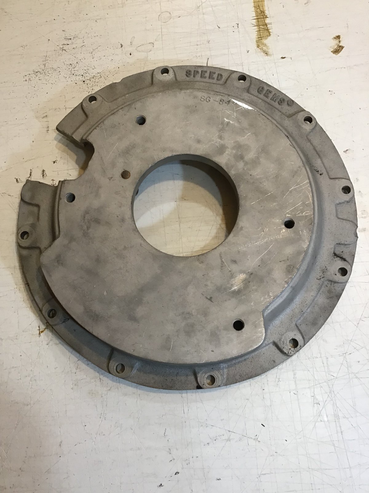

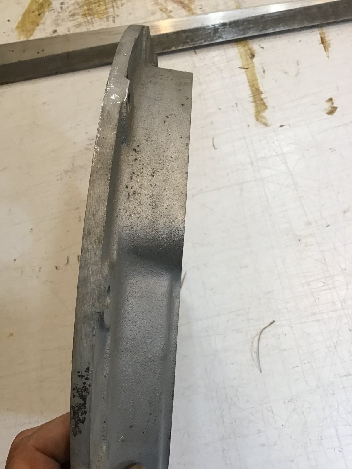

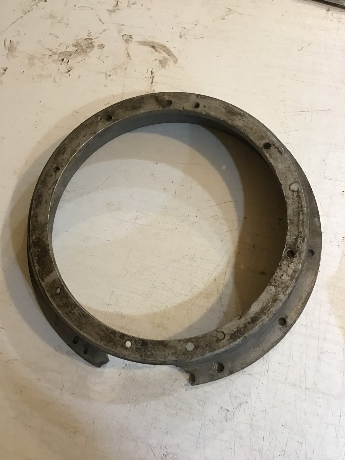

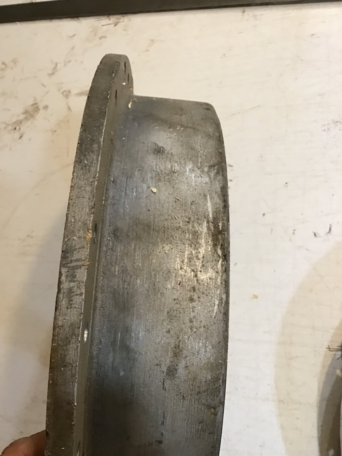

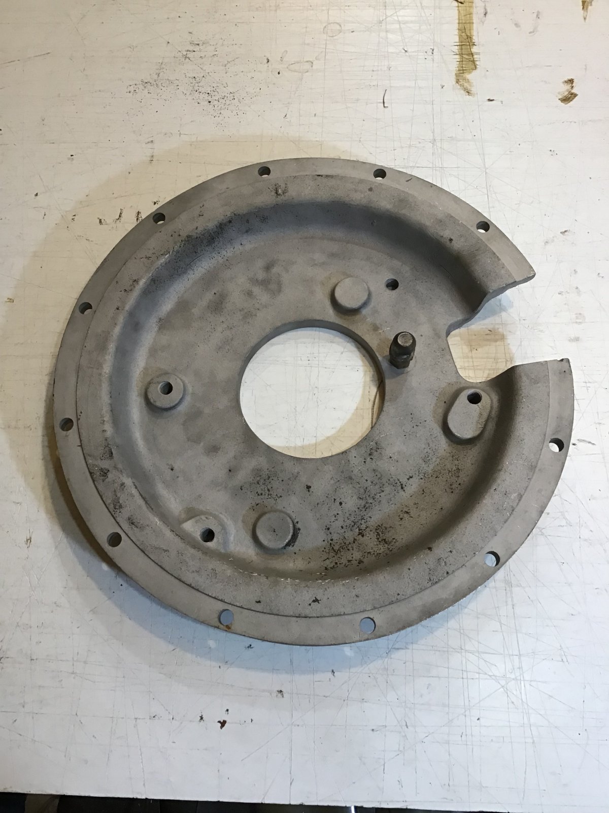

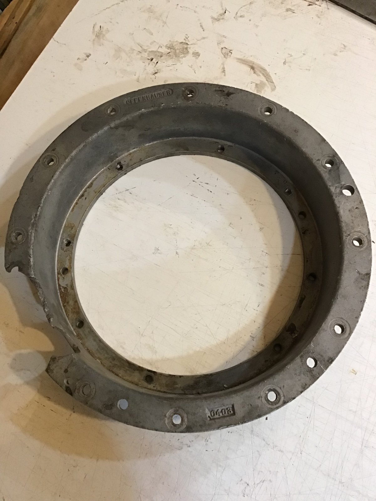

    Trans adapters are interesting for the 331 extended bell so much I think they are cool. They range from a flat plate to an inverted bell going into the hemi bell housing. As said it’s all about the imput shaft length . A few examples the deeper one is for an early ford transmission that Fit Into the bell of the hemi the other you see is a vintage speed gems with a 1.5 rise .
    I know the caddie transmission has a long shaft so what the difference in length between the Chevy transmission and the Cad lasalle IMG_7118.jpeg IMG_7119.jpeg IMG_7120.jpeg IMG_7121.jpeg IMG_7122.jpeg IMG_7123.jpeg
