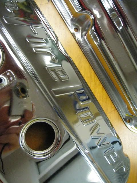

    A little update: I'm taking the block, heads and crank to the machine shop at lunch today to get cleaned and magnafluxed. Hopefully they'll get a clean bill of health. I'll also know what machine work the engine will require.
    Oh, and these showed up today. I happened to find them on eBay with a buy it now of $99. So I jumped on them. The chrome is a little thin around the bolt holes, but for the price, I'm happy. I also picked up a pair of rechromed original wire covers from hotrodA.

    Damn those look great Dave!!! There has never been a better looking valve cover for a hemi then the original Firepower ones installed from the factory bar none.
    Good luck at the machine shop, I hope it all checks out and by some mistake in numbers you end up with a 392 that needs little to no machine work! :D

    Please let us know how those valve covers fit and seal.
