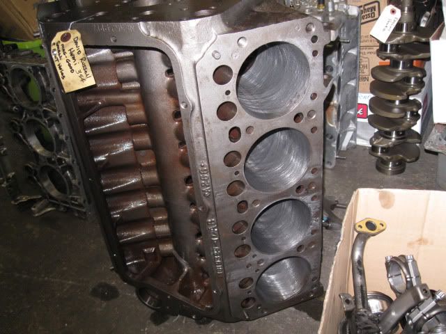

    OK, here's a pic. It is pretty bad, and it's definitely above the rings. It's third from the front on the p***enger side, on the side of the bore that's toward the outside of the block.
    In an earlier post I typed the incorrect sleeve thickness too. It will likely be .09375 wall thickness.

    Wow! :eek::eek:
    If you do end up sleeving it, I would love to see some pics of the process for a Hemi. Hint hint.

    That looks like that blocks made out of limestone not cast iron!!!! Hahah!!! I have a 331 sitting here for sale if ya want it ;). Might be a good reason to come to the Charlotte Auto Fair :D:D:D:D

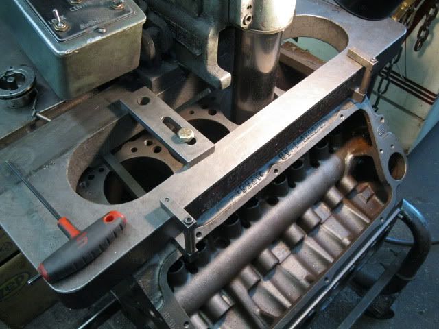

    Sorry to take you guys away from the *outlaw garage* thread, but I've got a modest little update on a real world, common man build.
    My pal Dave Hartley ('Mo on here) was kind enough to snap a few pictures of the sleeve installation into my 354 block. It went well and I ended up with just a .040 overbore on all cylinders.
    Here's a couple of shots of the boring bar set up to cut the bad cylinder for the sleeve. Luckily they didn't have to cut into the water jackets.
    They like to leave a ridge at the bottom of the cylinder so the sleeve can't possibly slide down.
    Next, they tap in the sleeve with this aluminum thingy. It's a press fit, but not ridiculously tight.
    Then the sleeve and the remainder of the cylinders get bored and honed.
    And here's the finished block, patiently awaiting my next chunk of money. :)
