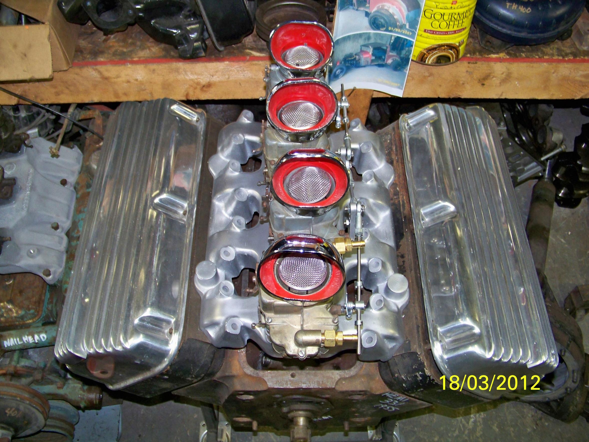

    Unless you're useing modern carbs, 3 three bolts won't really be enough carb.
  5. They're Olds J2 Rochesters.

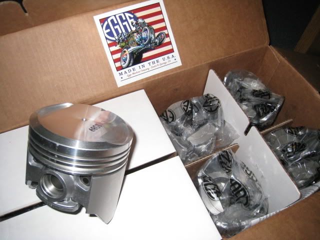

  13. The FedEx man came to see me today. He brought me a present. A shiny new set of .040 Egge pistons. :)
  14. JeffreyJames
    Joined: Jun 13, 2007
    Posts: 16,627
    JeffreyJames
    from SUGAR CITY
    You've nearly got yourself a HEMI!!! This is really going down this winter huh?

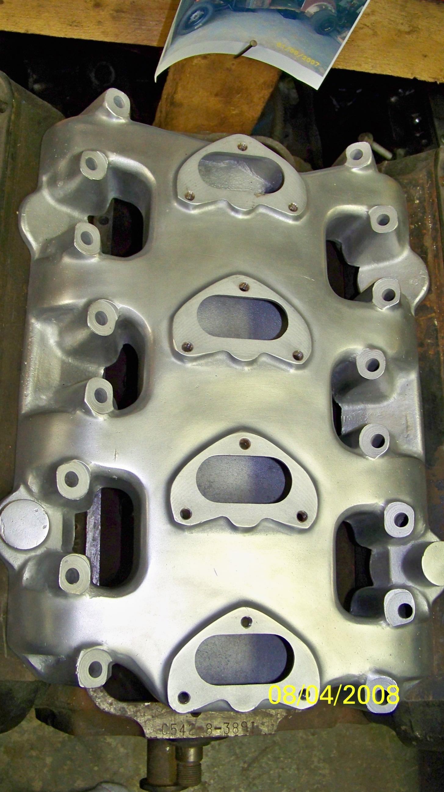

  17. I just bought this from kool32. Thanks man.
  18. Cool, Dave!
    Does that mean adapter plates, or good bye tri-power?
  19. Didn't think I'd hear you say that...
    So what carbs are you gonna use?

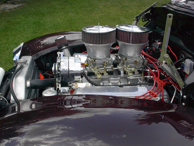

    I'm running the same intake on my 392 with two 600 cfm eldebrock's and progressive linkage. It is very responsive no bogging. I run one inch spacers under the carbs. You want matched carbs for your app. out of the box so if you go eldebrock let them know it is for dual four application.

    That's good to know. I'm leaning toward 500 Edelbrocks. Are you running the back carb with a choke as the primary?
  26. I agree the carbs need to be the same but what do you mean by a matched set? I have a pair of Pontiac AFB's on blown 354 setup progressive. Wondering what I didn't match.
