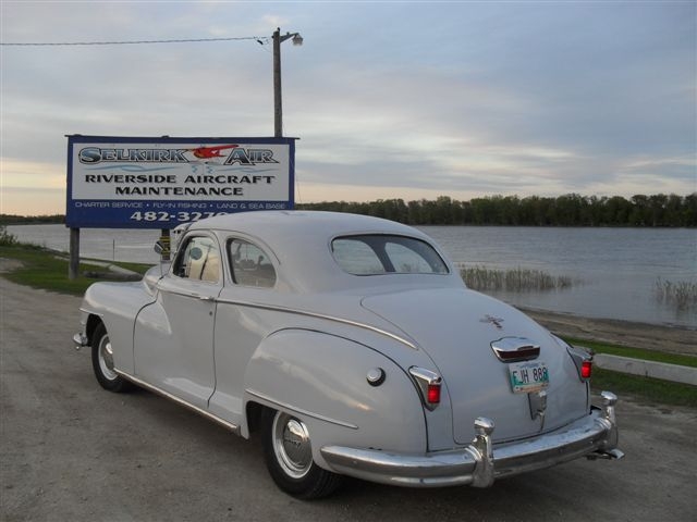

    I resotored a 47 Chrysler Coupe about 10 years ago, flathead 218 long block, regular clutch 3spd trans and 3.73 rear end, was nice and peppy, cruised great at 65 mph.
    Unfortunaely had to sell it 2 years ago....
