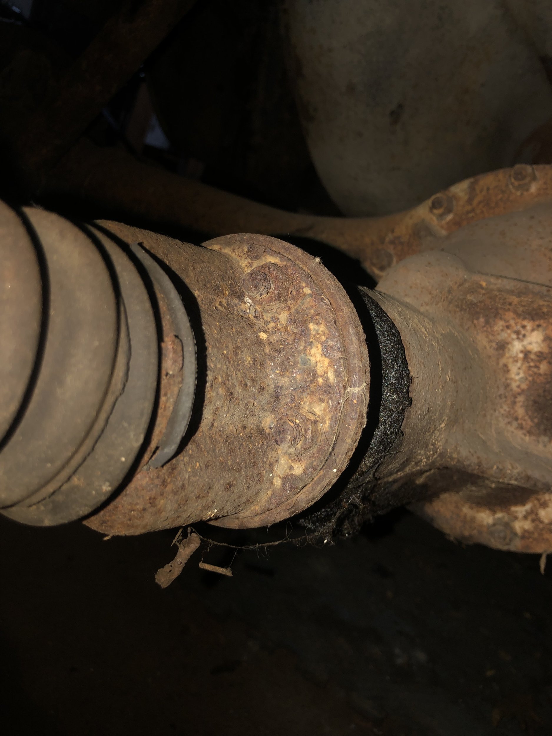

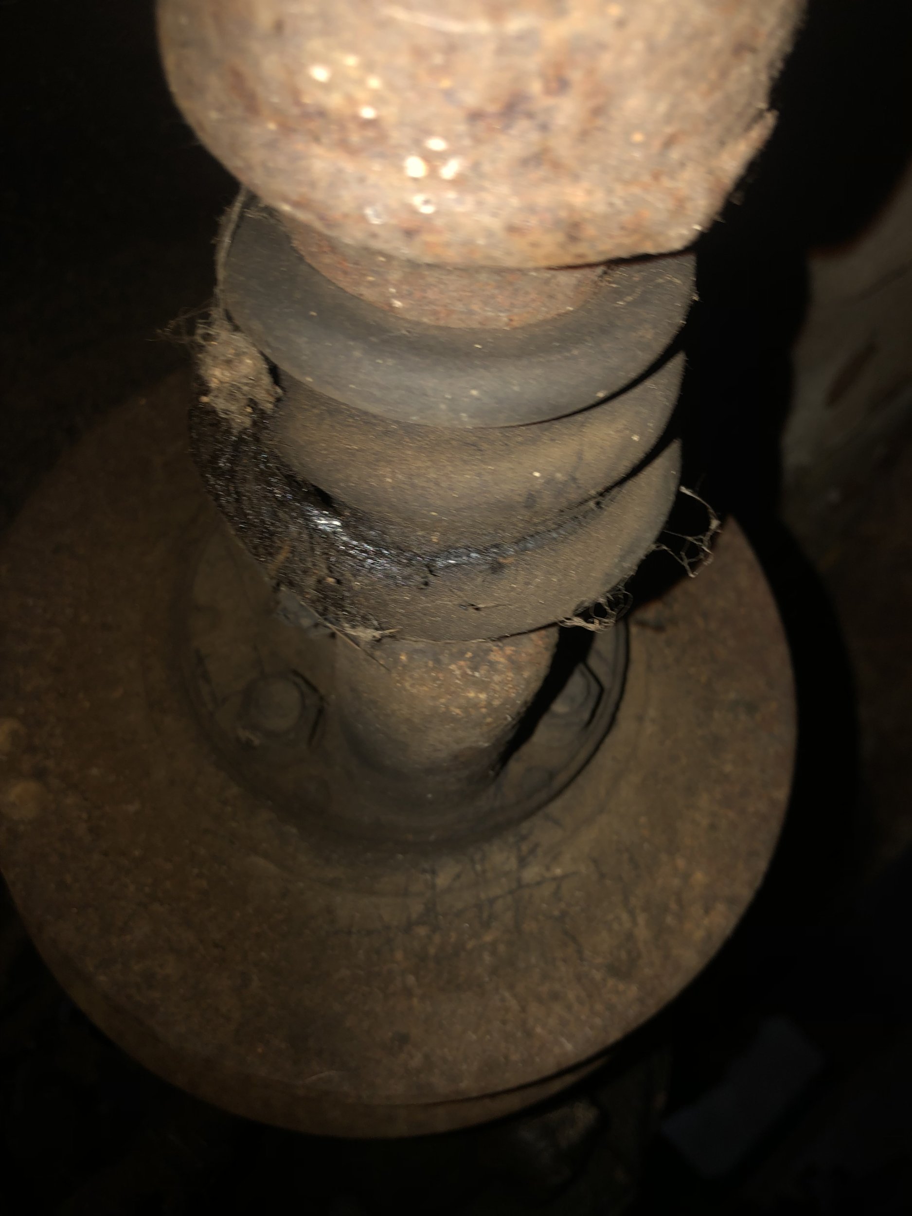

    Manostihl83
    Pls I’m most likely going to have to swap my rear end and driveshaft out when I do that because my driveshaft doesent have u joints
  14. BJR
    Joined: Mar 11, 2005
    Posts: 11,650
    BJR
    Those are U joints under the rubber boots.
    chryslerfan55 and Manostihl83 like this.

    ClayMart
    Probably a ball & trunnion joint, isn't it?
    chryslerfan55 and das858 like this.

    wheeltramp brian
    And they used those ball in trunion Type u joints behind hemi's and four speeds.

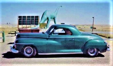

    My old 47 Dodge, Model D-24, 3 window business coupe, had one of those in it. It worked but I knew it was never going to be a viable power train. As cool as the car was, I am glad that I eventually sold it, and its now in some one else's hands as it lives on!

    dwollam
    The Ball & Trunion u-joint isn't actually under the rubber boot. That is to allow for movement in and out and some swivel. The "balls" are inside the metal can on a shaft and pin. All Chrysler products used those thru 1965 or there abouts. Not always the easiest thing to replace but last nearly forever if the boot is good.

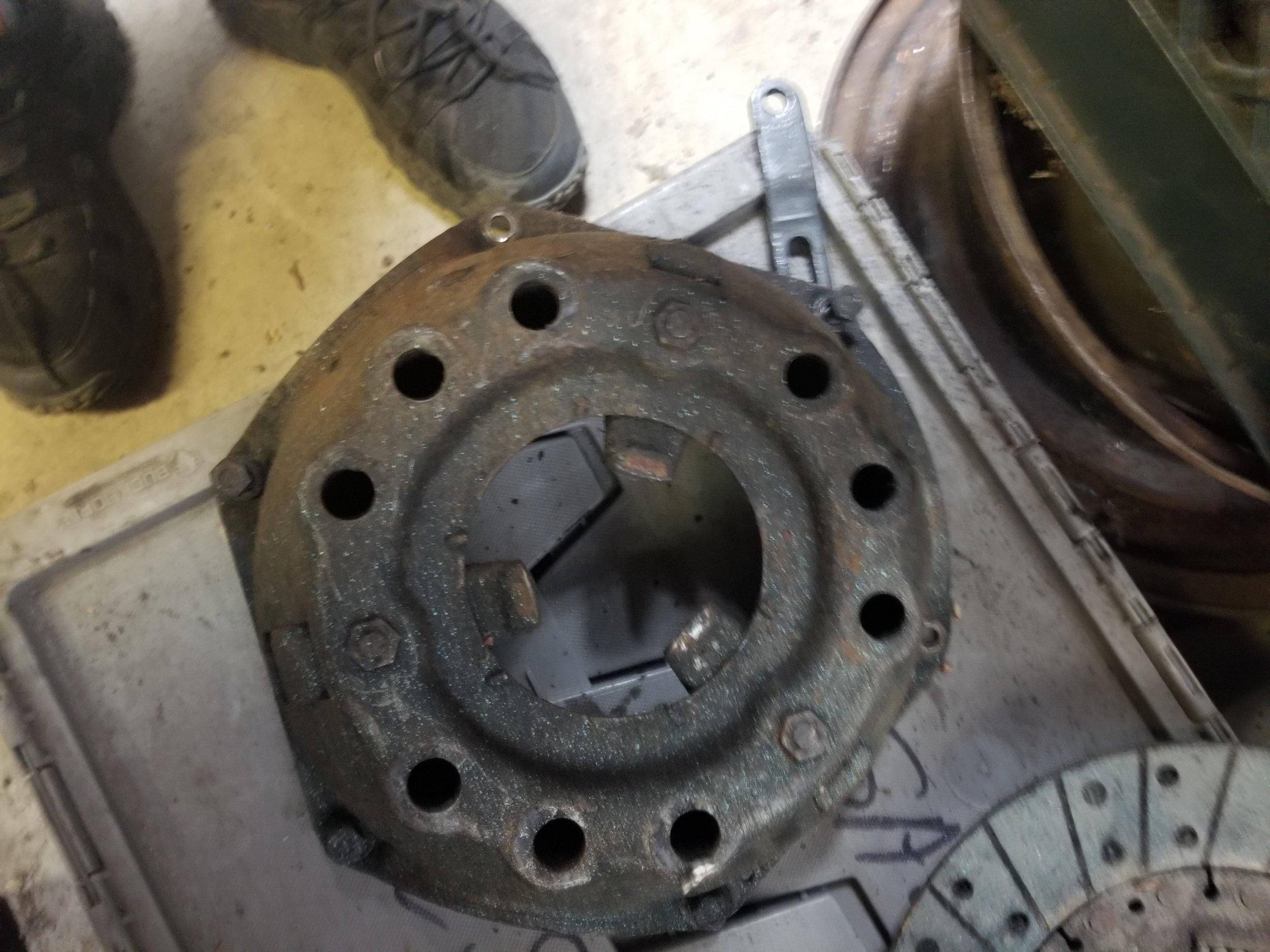

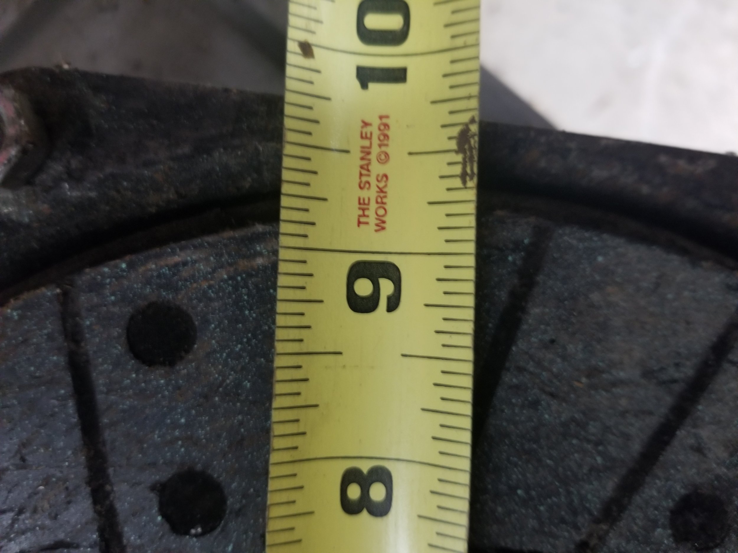

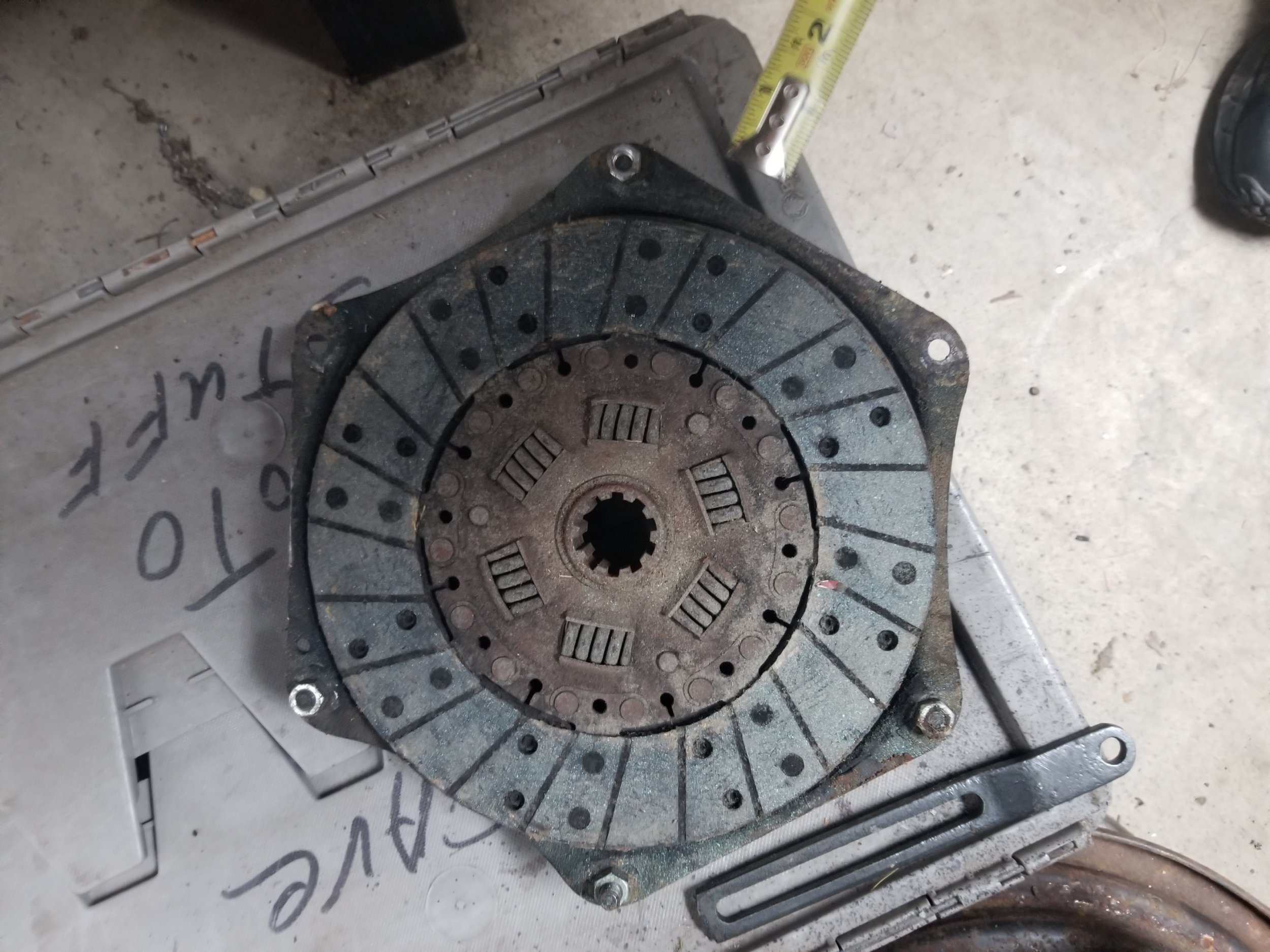

    from CT
    I'm 95% sure the clutch and pressure plate in the attached pictures are from a 1950 Desoto fluid drive. That would be a flathead 6.
    I don't know if it would work with your application but if you're interested PM me. You can have it for the cost of shipping.

    RodStRace
    Unfortunately, the 6 cyl are 9 inch, the hemis are 10, at least that's what I saw on the bay.
