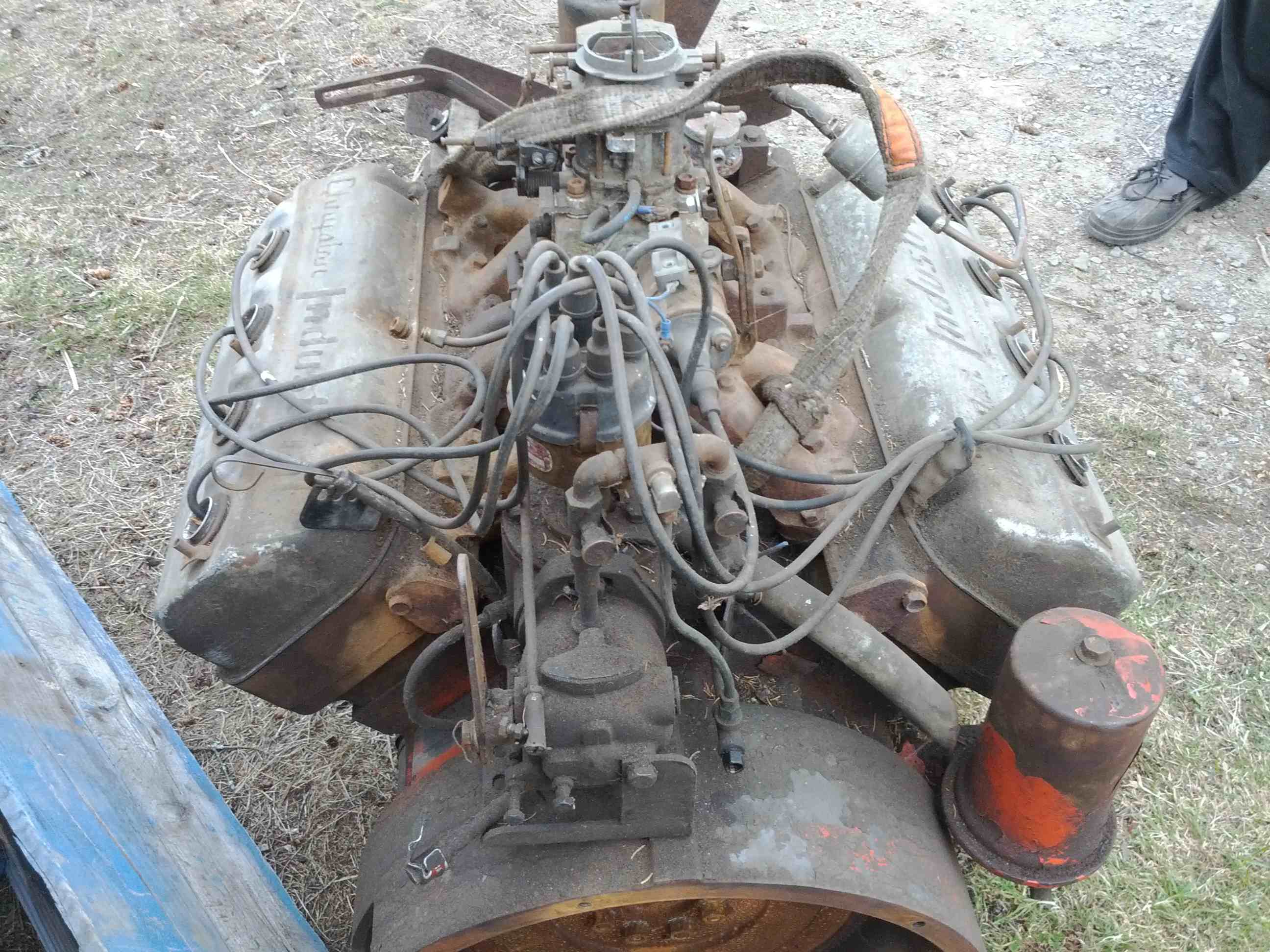

  1. Howdy folks! I have an opportunity to purchase this Chrysler Industrial Hemi that was used to power a larger welder. I believe it is a 354 according to the IND-56A indentification found on the block. I just wanted to confirm if it is possible to put this engine into a car with minor modifications of course? I am aware that the cam and other various items must be changed. My main concern is whether this block has an extended bellhousing or not? I'm planning on using a 727 transmission. Thanks 47 Desoto!

    kind of looks to me like it is a extended bell or does that piece on the rear of the block unbolt? something looks funny back there to me
  3. Looks just like my 354, except for that rear part. I bet it unbolts. I never heard of a 354 extended bell.

    It appears to be some kind of bolt-on part.
    The 56A is indeed a 354 and you will need very little to use this in a car.

  5. yes the extension on the back of the block unbolts - had a 331 industrial with it on there.

    If you look close I'm sure that you will find that the 'extention" unbolts.
    Watch out for the dimpled valve covers! It means that the engine has adjustable rocker arms (good thing) but I just sold one and the buyer wanted to ck that they were on the engine. We took off the valve cover and to my embarisment they were non adjustable!
  7. Thanks you very much for the clarification guys! I'm quite certain that extention unbolts. If I do acquire the engine the long term plan is to do a complete rebuild with a 6-71 Dyers blower for my coupe!

    Thev IND don't have adj rockers, just the dimples. Put "Hemi Tech Index" in search & start reading!

    ...still looking for the first one...I have never found an Ind with adjustable rockers under the dimpled covers...:cool:

    some of those were ran on propane.... could look brand new inside. I'd change the cam anyways just to give it good sound

    I had a Chrysler Industrial hemi.... the industrial models have a nitrided crank.

    Whats that hanging off under the distributor? some kind of govenor / throttle advance under load?

    The Hemi was also used on some air raid sirens (another industrial application)

    Save the front mount for some one with a low deck Dodge with a Chevy water pump. Add ears for mounts on your trans adapter an it makes a clean setup.

    Yes, for the application, a governor is needed.
    Worked for a guy that installed the 6" coolant lines and 4" oil lines on Fairbanks-Morse power plant engines. Heavy duty stuff. The welder had a DC generator for the welder behind the engine. As soon as an arc was struck, the governor would come into play to keep the rpms where needed.
    Don't recall exactly what the engine was, but it wasn't a HEMI.
    Got hold of a 331 Industrial that was used for irrigation; it doesn't have or need a governor....just goes to a set throttle position as it's a somewhat steady load.
    Going to use it in the Chrysler shown in avatar.
    Many farmers used them back in the 60's for crop irrigation. They had to be careful when first starting the pump so as not to blow the ends of the tubes out....which it could easily do.
    Also, there was also a small company around that used a HEMI Industrial to power a wood chipper.
    It had a governor as well, but it may have been an after market setup.
    The chips were used for bedding.
    IIRC, the price of gasoline eventually made it a money-losing operation.
    If the engine you have is going into the DeSoto in your avatar, that'll be a good application. You're right about the cam changeout.
    The adapter for the 727 is available........member 73RR has them.

    I wonder what changes were made to drive the governor.
