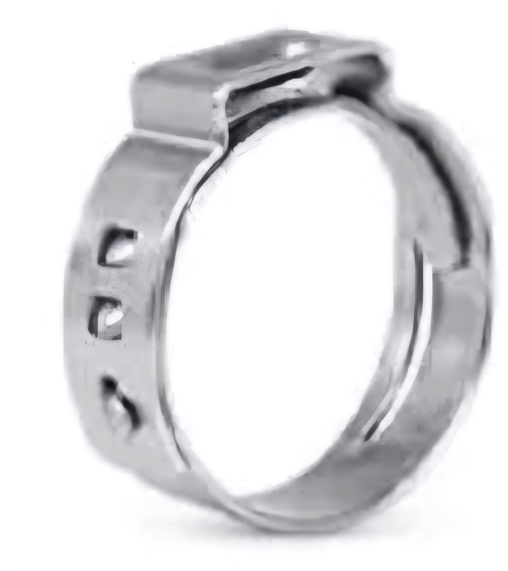

    Can these type clamps be loosened up with
    The tool?
  2. Johnny Gee
    Joined: Dec 3, 2009
    Posts: 14,599
    Johnny Gee
    from Downey, Ca
  3. johnfin
    Joined: Apr 11, 2008
    Posts: 285
    johnfin
    from Florida
    Can the hose be saved, ie cut the top cinch.
  4. Johnny Gee
    Joined: Dec 3, 2009
    Posts: 14,599
    Johnny Gee
    from Downey, Ca
    Do you mean cutting the “hose” below where it was crimped?

    That's a one use clamp. You can carefully cut it off and if the hose is still good replace it with the same or a different style clamp.

    I have cut them with a good sharp set of side cutters where Johnny gee has marked it without disturbing the hose.

    you can save the hose but those clamps get cut off. My daughter VW bus' fuel line had a bout 20 of them. Not anymore.

    The clamp in the photo looks residential and RV plumbing as in PEX vs an automotive unit.

    You can also remove them by inserting a flat blade screwdriver into the open area just to the right of the red line and twisting. They come off in seconds. I like them because to my old eyes they look cleaner than a gear clamp and don't cut into the hose. Right name is oetiker.

    lonewolf hit it on the head. They look cleaner. If they came in black it would be even better. Concealed to a point.

    Summit racing sells them. Not just for german junk or RVs.

    Not only do they look cleaner, but from an installation perspective in m*** production they're a lot simpler. Crimp the clamp, sides contact, and it's secure. For those of us installing them all by hand and worried about removal and maintenance, there are other options.
