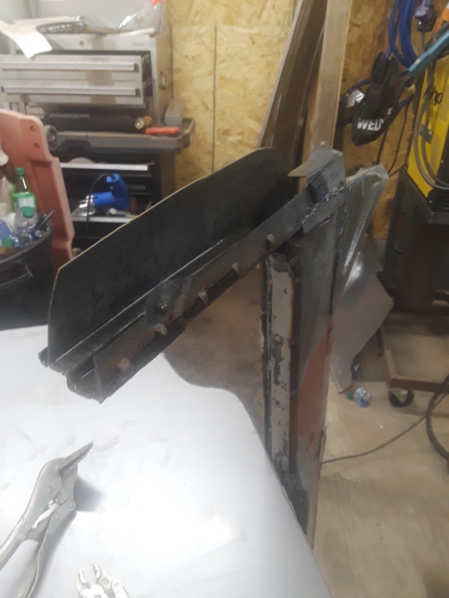

    I just spray WD-40 on it.The parts in front of the pic have been treated with citric acid and WD-40.
    The pic is from today but it`s been 18 months since I did it. Skärmavbild 2020-06-29 kl. 16.05.20.png

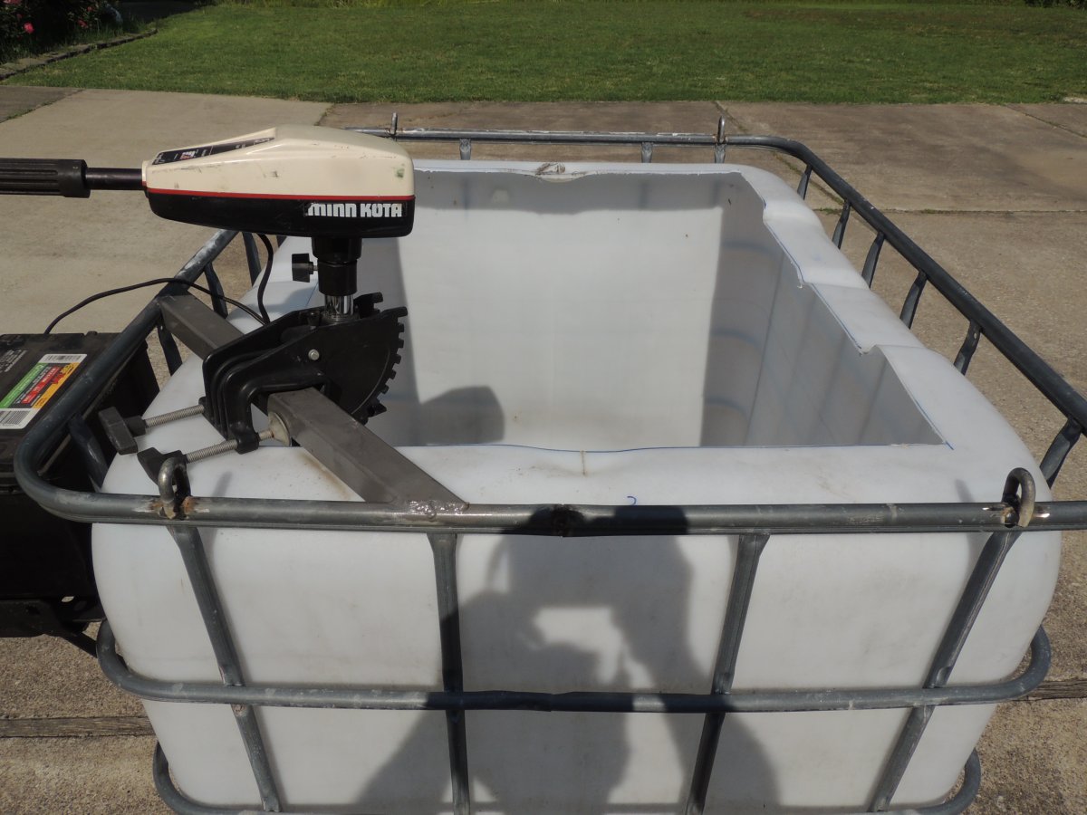

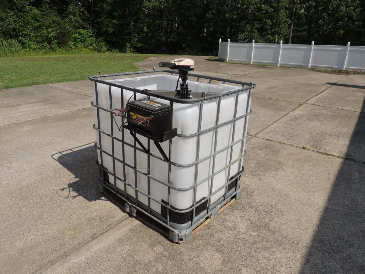

    Got my acid tank all set up today. Dumped 20 pounds of powder in about 200 gallons of water. I threw a few parts in and within an hour or two the water was turning orange and lots of bubbles flowing. I will take some pics tomorrow and see how things look.

    I did some more small parts in the citric bath and they turned out ok but I'm still a big believer in reverse electrolysis. Now I'm wondering if th two methods could be combined? Would the acid be neutralized by the washing soda cancelling out any benefit?

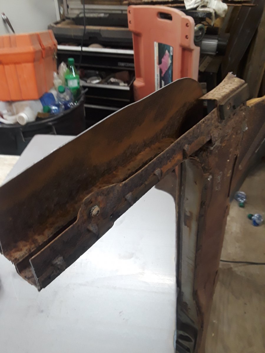

    I don't know what to say, other than holy ****! I will let the before and after pictures speak for themselves. These pieces were in the tank for less than 24 hours....I was skeptical when I pulled them out, until I put the high pressure nozzle on the water hose and rinsed them off........ 20200630_183248.jpg 20200701_143540.jpg
