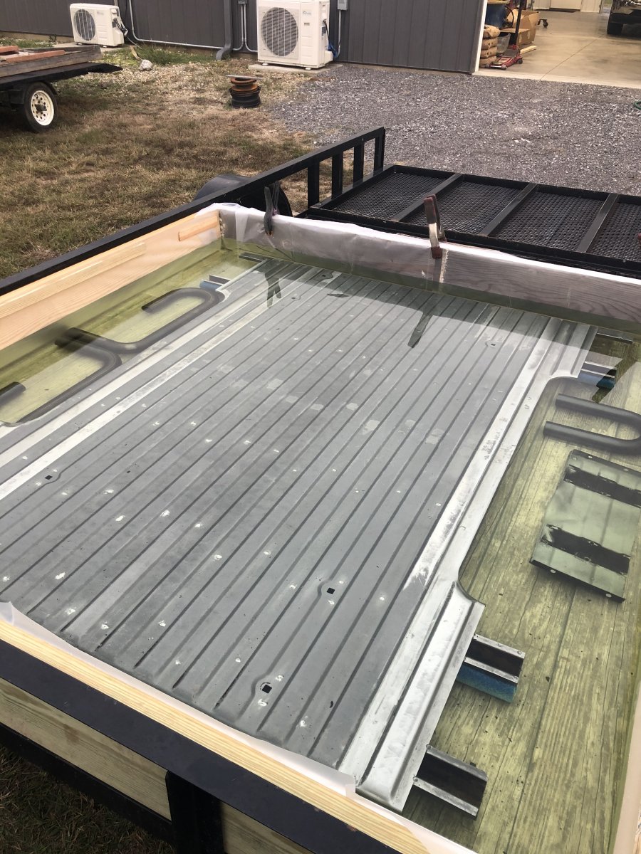

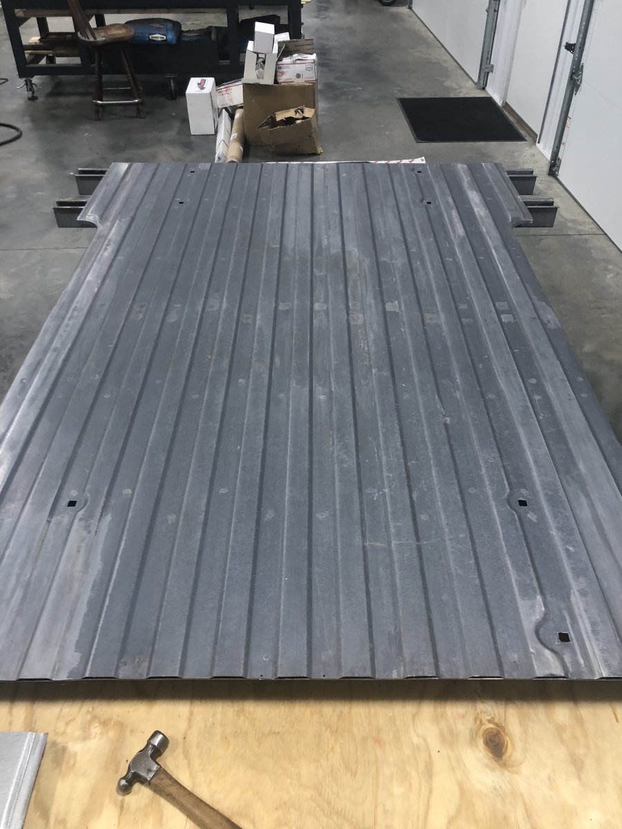

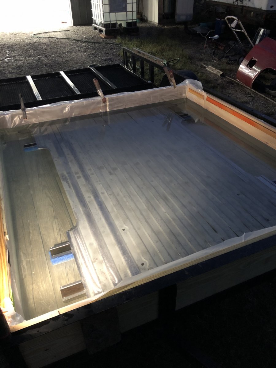

    I’m sold on the citric acid. I’m working on an OT truck bed floor which had galvanized coating on both sides. I’ll be doing a good bit of tig welding on it, and tig/galv is a no go. I threw together a framework of 2x12s on top of my utility trailer and lined it with 6 mil plastic. Found a 50 lb bag of powder on flea bay and mixed up at the 1 cup to 3 gallon ratio. Figured out to about 157 gal of water and 24 lbs of powder. Put the floor in it and in two days time it was stripped clean of the galv coating. Had to flip it once since the floor ribs trapped hydrogen underneath and it wouldn’t let it work.
